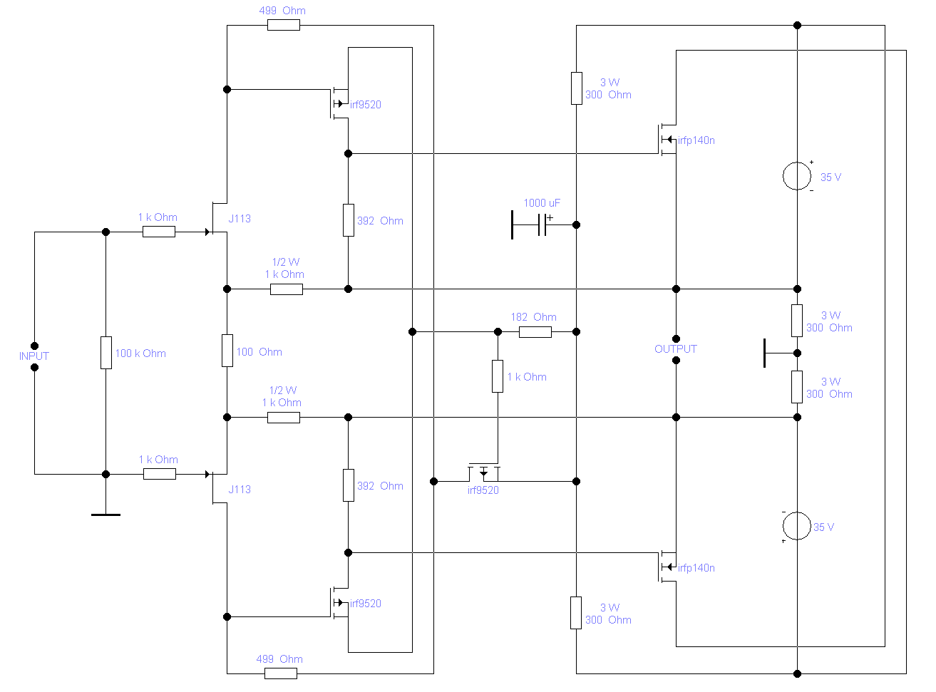

In response to your message, I am replying here as the solution I'd suggest is similar to the one already shown in post #79. Like that circuit, it is a fully floating design, by which I mean it is powered only by the two floating supplies. It also uses no cascodes, as none are really needed here for good performance.
The key difference here is the addition of a differential VAS with active tail current source. This uses a local loop to enhance the differential gain of the VAS, such that even a single-ended input will produce a balanced amplifier output.
The 182 ohm value is adjusted using a trim pot in parallel (not shown) to set the desired output stage bias current. To ensure proper thermal compensation for the bias, the PMOS control device should be of the same process type as the NMOS output stage devices, and mounted near them.
In practice you will need a DC balance adjustment, also not shown. To add this I would first change the JFET drain resistors from 499 to 1K each, and then tie a 2K trim pot across them with its wiper connected to the drain of the PMOS CCS control device.
To be clear, I am offering this for experimental hobby use only. I've not built this exact circuit, but it does sim as expected so I think it will work well in practice. All components and values shown here are what were available to sim and worked for me. You can use what you prefer as long as it works in the end.
If you try this for yourself, I hope you will share your impressions.

HI alexberg, thanks i will try with shunt reference (zener?)
Hi Joe,
Thank you for this schema, when I tried this input stage (post 71) I did not use VAS differential yet and the result was not good, maybe because of the 2SK170
so you prefer the J113?
there is not an error in the scheme? the ccs is connected to the input stage and not the VAS

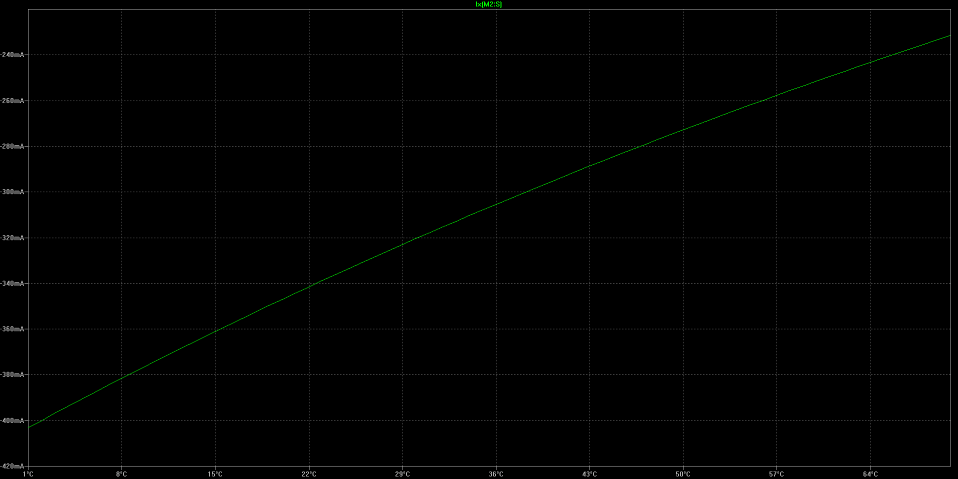

can lateral mosfet be used for better thermal stability?

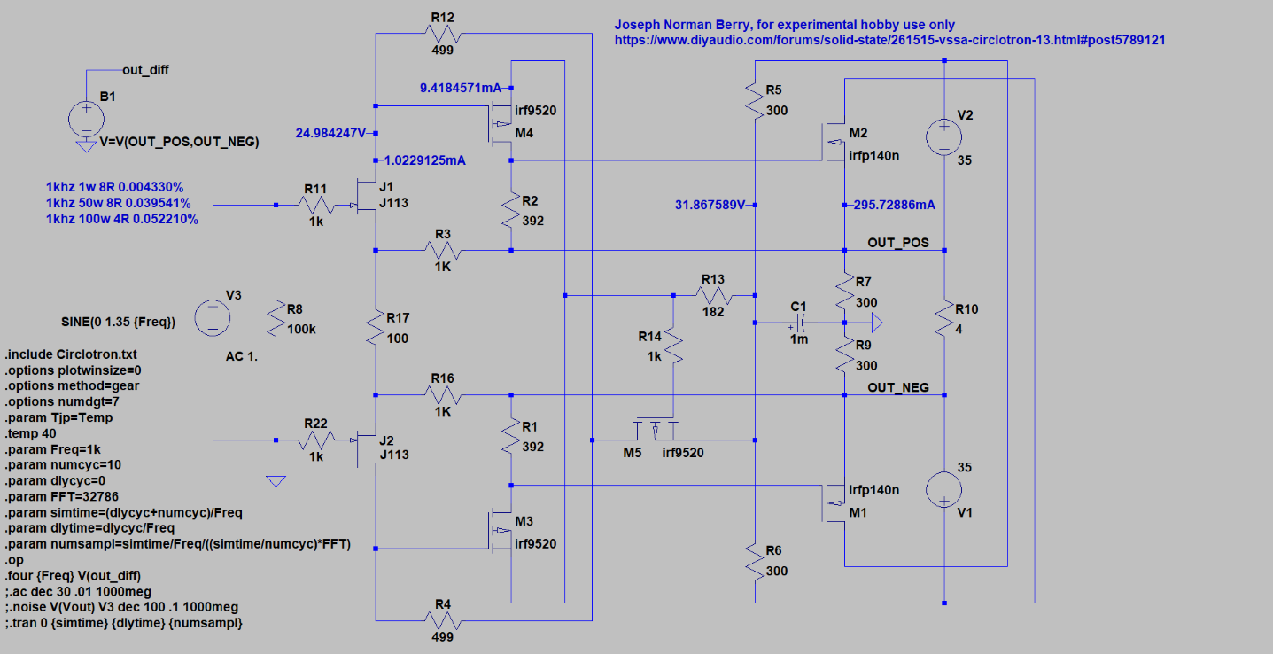

It works !!
In simulation I found 1mA, 9mA and 300mA, that's what you planned ?
for the moment I took models spice manufacturers, but it would be better in VDMOS with subthreshold to check thermal stability
J113, IRF9520 and IRFP140 are specifically chosen or it could be replaced by others ? (2sk389, irf9610, IRFP240, Exicon lateral mosfet)
Thank you so much !!

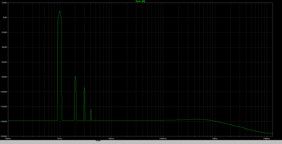

Yes, those are about the right idle currents. You can now start replacing the component values with your preferred types and see what works best with them.
Just be sure the JFETs you use can tolerate 24Vds without too much gate leakage (no more than a few mV DC measured at the input), and that whatever PMOS and NMOS devices you use are from the same process type for best thermal compensation.
Thank you for the kind attribution in your schematic. ;-)
yes the 499ohm resistor is the best place to control offset, its variation has no influence on the quiescent current (or negligible)
the distortion decreases when increases this resistance, can we increase it?
I tried to increase the quiescent current of the vas, keeping 300mA on output, the distortion increases....
I tried IRF9610, IRFP240, the distortion increases...
Joined 2001
Yes, increasing the JFET drain resistance increases open-loop gain and so will reduce the closed-loop distortion, but you may start to see stability issues. The values I chose were a compromise between reasonably low distortion and stability. This is something to watch for when choosing different component values.
The other IRF devices you tried have lower gain than the ones I used, and that is probably why you are seeing higher distortion. You can try increasing the OL gain to make up for it, but there may be a limit, and you may have to add compensation caps for stability rather than rely on the intrinsic PMOS device capacitance (as I did) for internal compensation.
Joined 2001
I would first try the IRF9610 and IRFP240 in the sim and see how far you can increase the 499 ohm resistor values before you see peaking in the HF response curve or ringing on square waves. There should be none with an 8 ohm resistive load and only a little with some shunt capacitance added. If in doubt, post your results and we can discuss.
