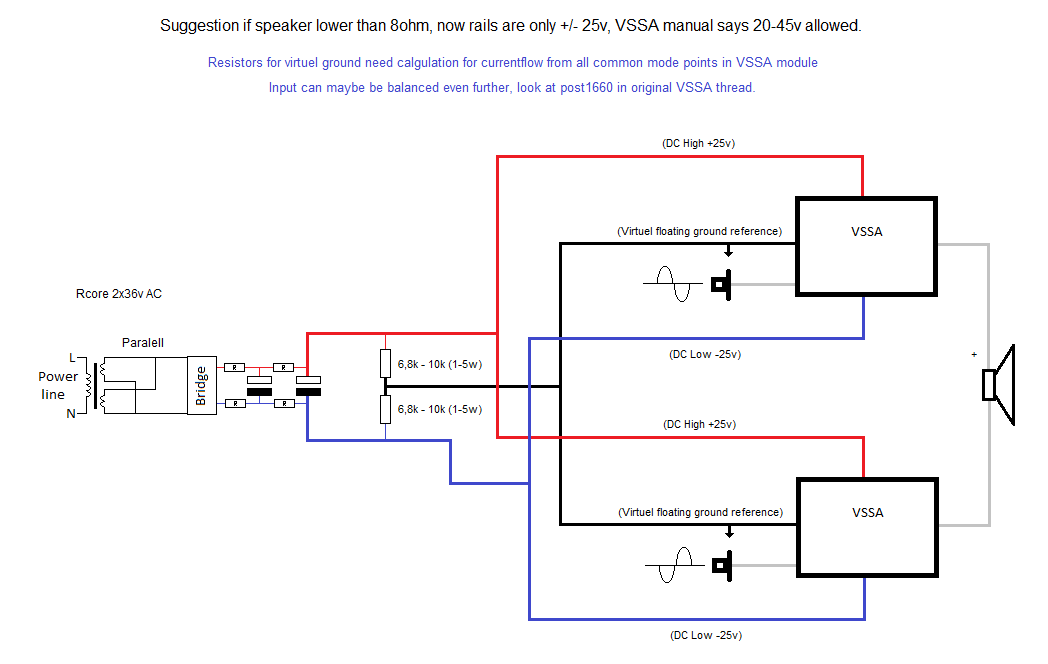

Hi Marc
I shall and will stop now about the balanced version.
But here the last which will use your Rcore and bring Andrej's VSSA to 50v, lower speaker z as mentioned by gaborbela.
But i don't know how to calgulate output power with a given spaker z, but others can surely help.
See image for wireing.
It also follow letters VS in VSSA name.
BR Ricky

Fellows, I am more than interested in the balanced amplifier discussion, as i have also a working balanced preamp. As VSSA is specified to work with 4 ohms at +/-45V i would expect two VSSAs will work balanced at the same voltage in 8 Ohms without issues. Just need to at least double the power supply capacitors and heatsinks. Maybe a PeeCeeBee optimized for balanced operation and using discrete P and N channels would be better than two working VSSA balanced with the mixed ALFETs.
I guess we can aim for a huge power with this kind of structure (I aim for a 200W/8Ohms which sounds realistic in my proposed outline).
Cheers!
Cheers!

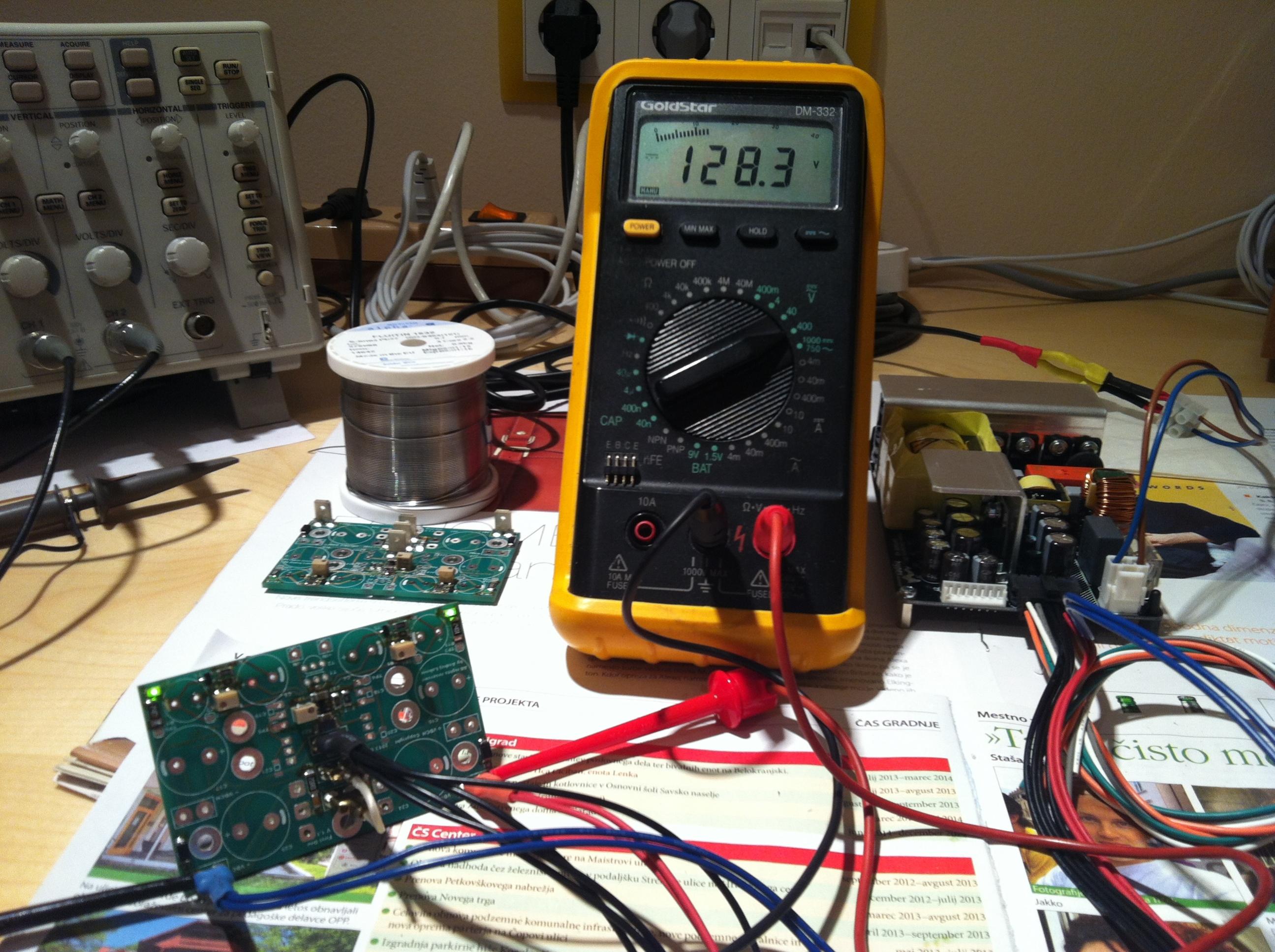

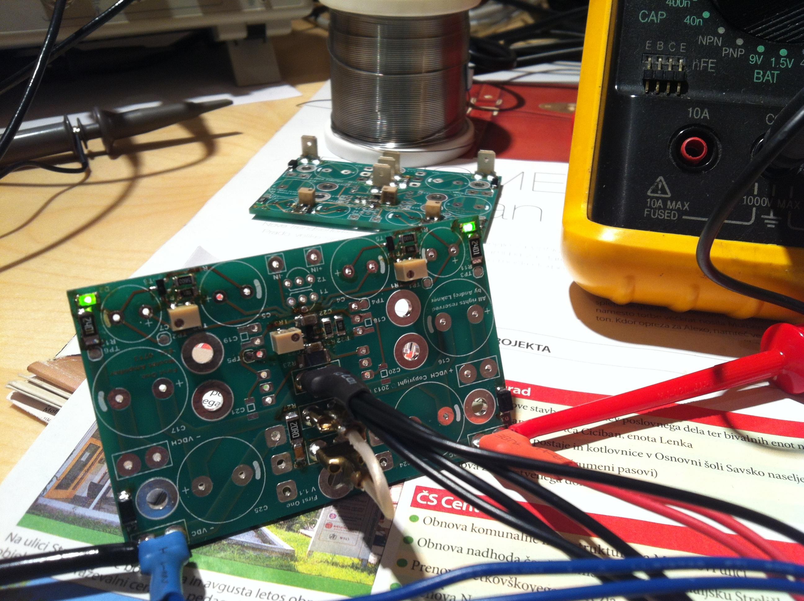

Lazy Cat hasn't been very lazy lately. First One SMD populated PCB (50 x 80 mm) first time connected to SMPS600 and yes it will run on +/-64 VHi LC,
Why not...The question will be more could i resist to Oné call.....
Marc
Hi Andrej, thats niceit will run on +/-64 V
Very symetrical and short trace Down 4 X devices lane (Picture).
Guessing - you ad buffer for VAS and using LATfets ?
Does it also hold your before mentioned LTP for input (Wikepidia say=Long Taylored Pair) or is somthing about leds ?
BR Ricky

Hi Ricky,
Yes, I need to plan this very carefully. For the moment I will mount VSSA in it's own box giving the best I can to have it a good reference (500VA trafo with 4 separate windings, as I would like to get best separation, independent rectifiers and 2x15.000uF capacitors for each channel).
As you spotted, in case of balanced operation the speaker return will not come into ground, so that means I can have only one power supply per channel, not differential, but high voltage; that can be referenced to GND by a lower current divider. For that project I already have a 1kW toroid with 2 independent 63V secondary windings, so I can use one for each channel (around 85V after rectifiers that makes less than 90V maximum voltage recommended by LC). I also have lots of 10000uF/100V caps that are drying in the drawer and also a PCB that can hold 8 of each, making a hefty 40.000uF per channel. For the active elements I have 4 matched pairs of pulled Hitachi 2SK175/2SJ55 that should be enough for both channels. I plan to breadboard everything on the power heatsink, with power devices mounted on L shaped aluminium at 1/3 and 2/3 height distance from the edges.
Of course, the cap multiplier presented by PMI in another thread is also appealing, and also elevated rails for the input stage... but I know that too many complications can kill my project and I don't want that!

I see you have certain serious plan and knowledge, so don't have to mention remember do wiring as symetrically as possible eg same length/dimension/route for pos/neg amps and psu.
Myself have situation than if this brings higher SQ and truth for reproducing source i go that way, even i don't need the high power.
But i first need to make trails with VSSA when arrives then BG1-BJT (Sanken) and also need to try standard supply/PMI supply/Hypex/Connex. So at first mix against 2xamps + 4xPSU to get analized which setup is most true in performance (and frustrating in timemanner, Andrej yesterday teased new model called "First One", then 3x amps).
All this for me needs to be answered before putting in big time effort for setting up ballanced version, so at present it is future, but i believe 2xmodul agaist 1xmodul per mono stage wil bring higher SQ.
By the way metallicus69, do you think the resistors in post28 example can do the current divider ?

I think yes, they will do (I was thinking also in that area, 5-20kOhms).By the way metallicus69, do you think the resistors in post28 example can do the current divider ?
