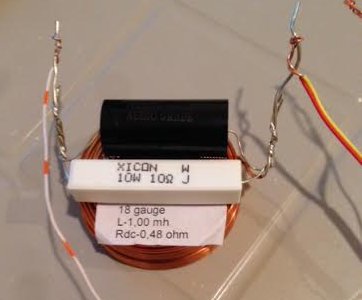

The BSC parts (Jantzen 1.0 mH air core inductor, 10 ohm 10 watt resistor, Dayton 0.47 uF 400 V audio grade poly cap) arrived and I wired it up, soldered the leads and connected it to the DCR speaker externally to test in the listening position as a computer monitor. I turned off all the DSP BSC, but left the left+right mixing to mono. Listening to it, it sounds very good - the bass actually sounded more natural and full; the mids and highs were just right without any hint of fatigue or harshness. Based on my listening impressions, I expected the measurements to show good balance similar to the simulations which was used to set the BSC component values.

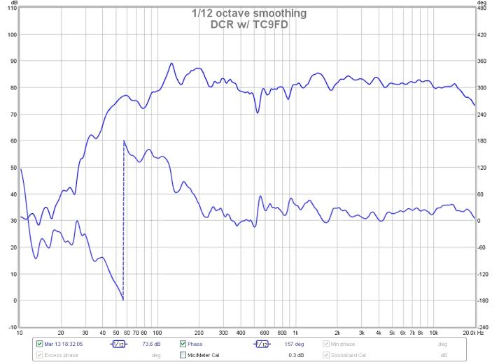

Here are the measurements of the DCR speaker with the hardware-based BSC installed, with the mic about 0.5m away from the driver at listening position.
Frequency response and acoustic phase - the BSC did its job perfectly and the phase is still fairly linear over the 500 Hz to 20 kHz range, and there is no phase wrap at 500 Hz this time with the hardware-based BSC:

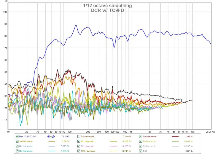

The harmonic distortion also looks very good - now it is circa -30dB in the sub 100 Hz region, and varies from -45dB to -55dB from 300 Hz on up:

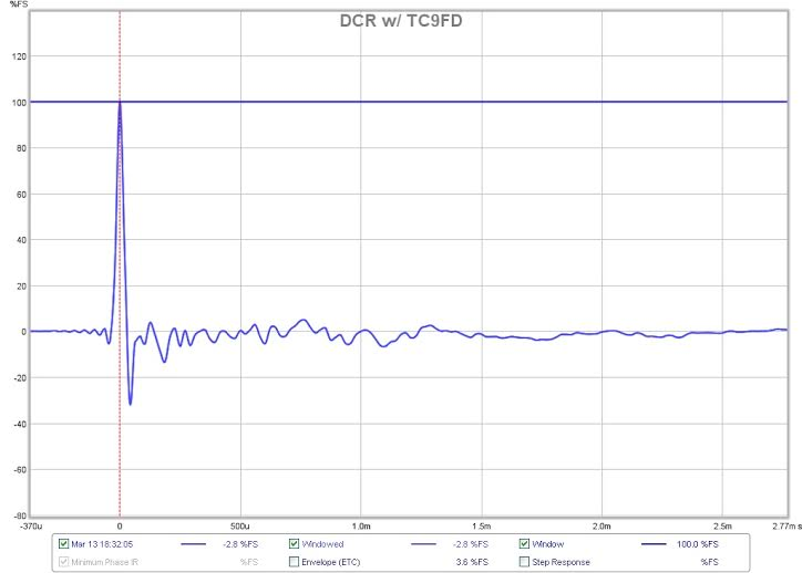

Here is the Impulse Response - which really cannot get much better:
I haven't had much time to listen to more than 3 or 4 tracks, but so far the sound quality has exceeded my expectations for a simple fullrange computer speaker. The clarity of the mids and highs is excellent, and the bass is actually quite satisfying and substantial. I don't think a sub-woofer is necessary for most music. The dips and peaks from measuring the speaker in the actual real-world listening position of the computer desk doesn't seem to be noticeable in listening to music. It sounds excellent and I am very happy with the outcome. I highly recommend this build. The BSC components, although the cost as much as the drivers - are needed if you do not intend to use DSP, and make the sound very even and pleasing to the ear.

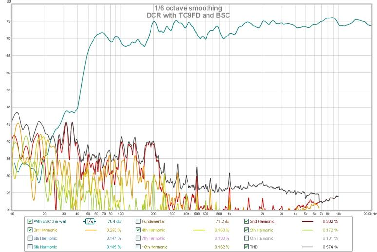

More meas with BSC and improved position
I moved the speaker around on my desk to get the rear ports 3 in from wall and removed desktop "floor" bounce cancellation dip. Here is the new measurement at a realistic listening SPL of about 75dB. The SPL variation or flatness is quite good with +/- 3dB over 52 Hz t0 20 kHz. Note that the HD is now around -30 to -35dB in the 50 Hz to 100 Hz range which shows how well a dual chamber reflex can work in providing rather satisfying bass with lower distortion. There is some distortion in the 100 Hz to 200 Hz range that takes it to -27dB but mostly it is 2nd harmonic which really is not that objectionable. In general, the sounds is very nice and pleasing to the ear.
SPL and HD vs Freq:
Here is a photo of the BSC circuit:

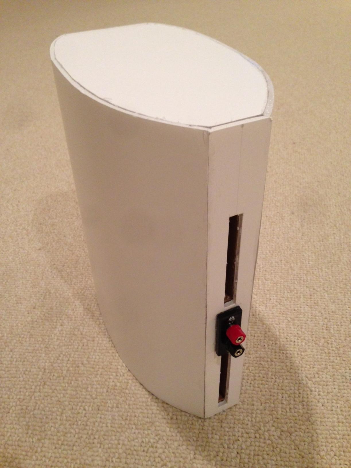

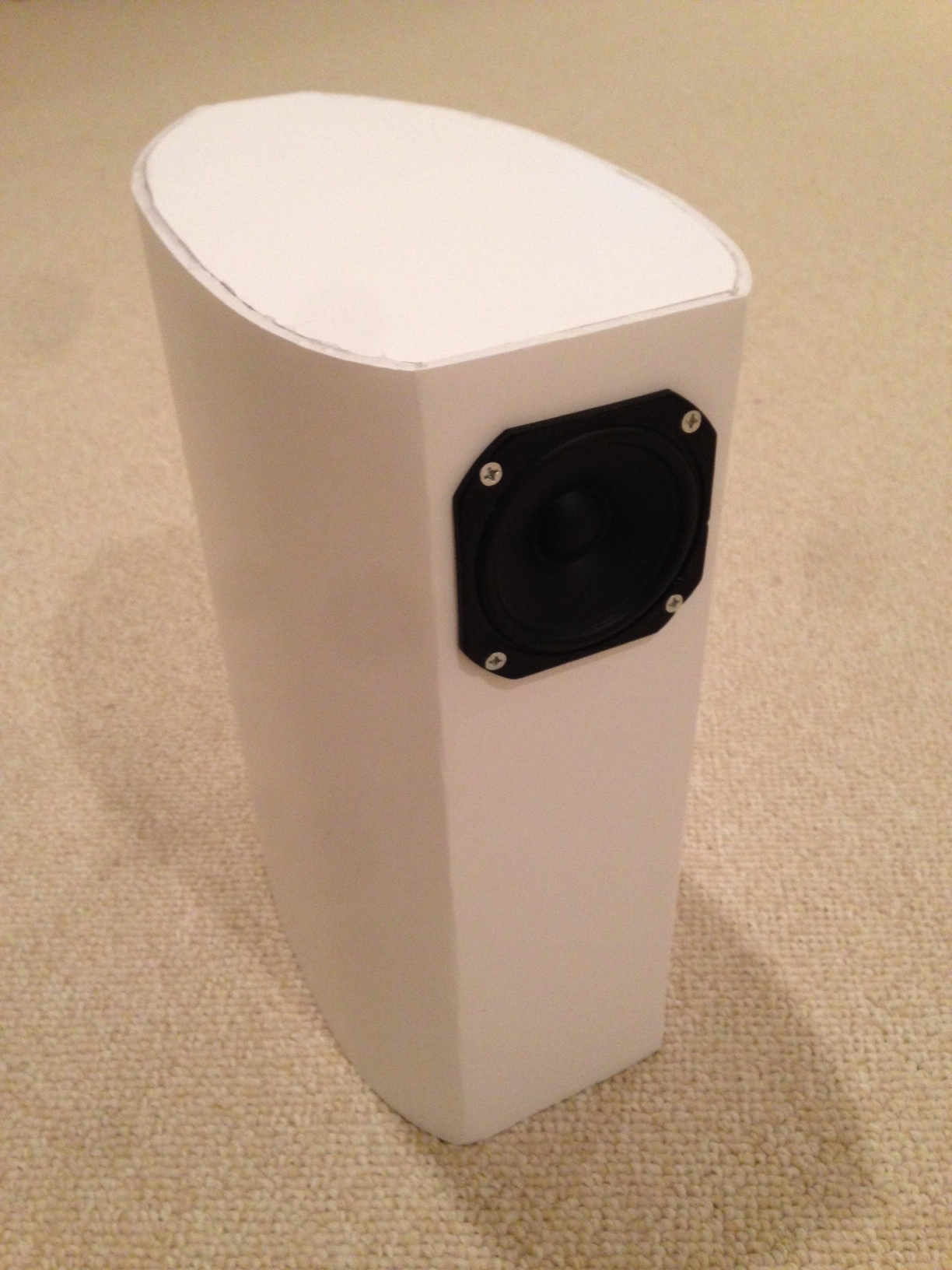

Speaker Completed with BSC & Binding Posts
The speaker sounds great now and I am happy enough to install the BSC circuit permanently inside (hot melt glued to divider plate through the cutout). I also installed some real binding posts on the back. The surprise was the improvement in the sound when I hooked it up through properly soldered connections and a binding post rather that hand-twisted temporary wire leads during testing. It sounds more clear and the bass seems to have more impact. Loose connections can rob clarity and bass is what I just experienced.
Here are some sound clips of how it sounds at my desk (still in mono). Let me know what you think.
