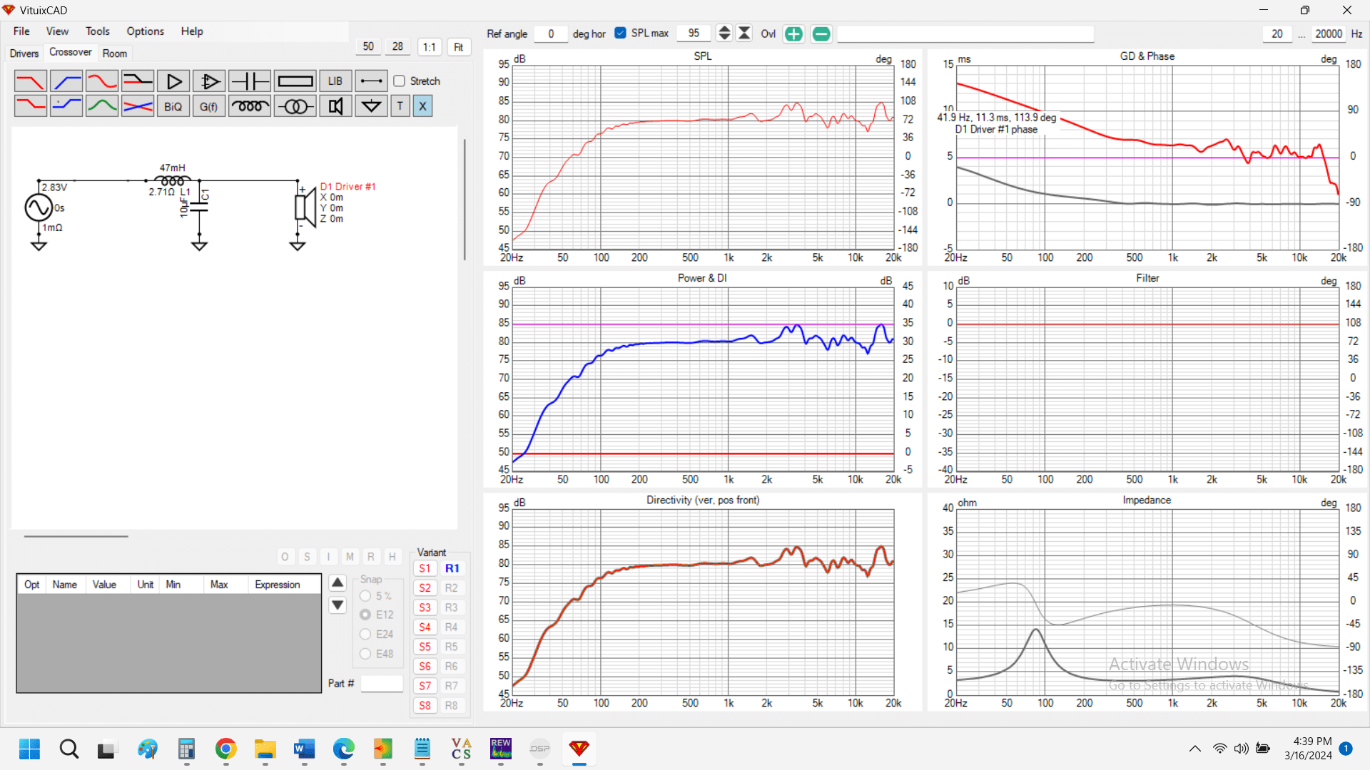

Hi everybody
need some help with Vituix. I assume it is some simple thing but cannot find it.
Why do not see effect of crossover component on any graph but impedance
when using active elements only filter graph change, all others do not show any change.

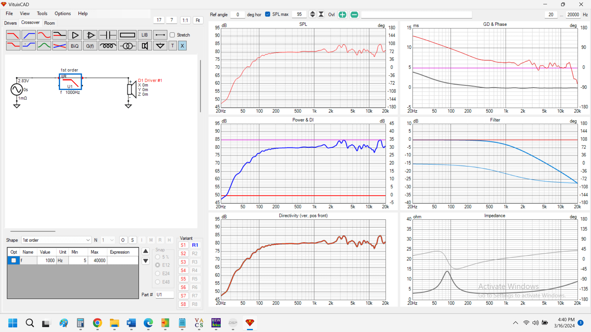

one more thing, why active elements have four connection points and when to use upper and when lower if thewre is any difference
Hi, use the upper connection points on active blocks.
You have wire going through the components,effectively bypassing them, that's why you don't see a change in the graphs.
Remove all the wiring, add components, then use wire if necessary. You can put components touching each other so not much wiring is needed.
