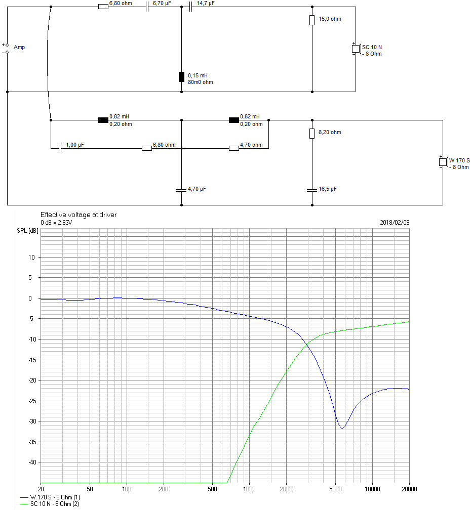

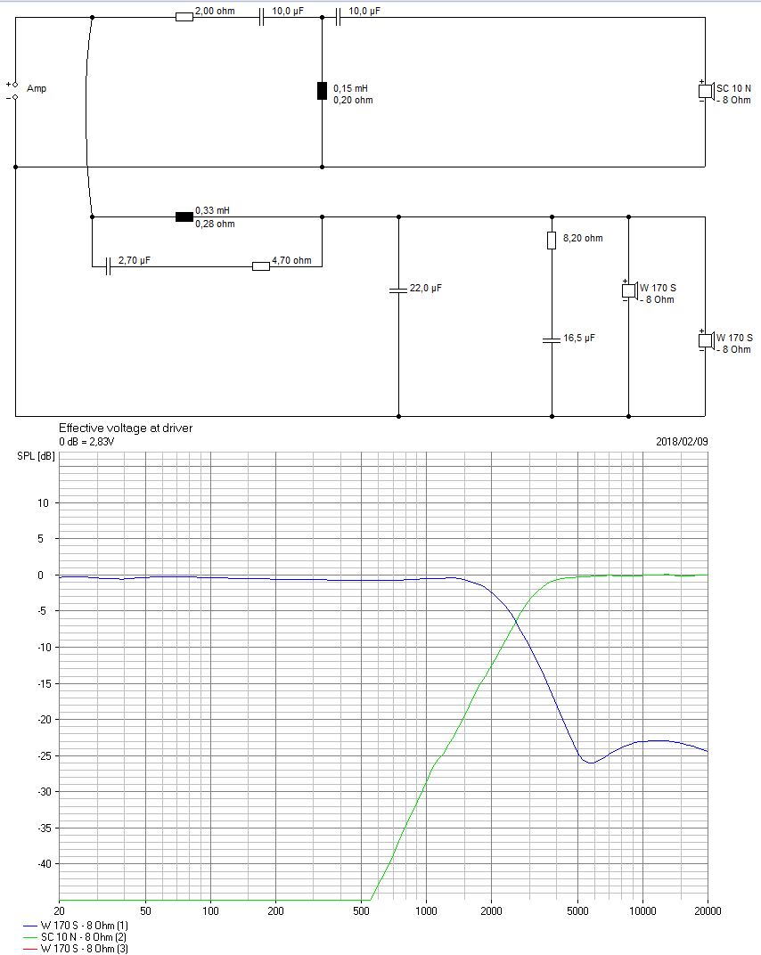

I'm pretty much final on my design now. It's the 4th iteration, and it's pretty spectacular. It's my 3rd crossover I implemented. :) I have attached what it started as, and then what it ended as. I went with MTM, and it's excellent.
First image is how it started, second is how it ended.

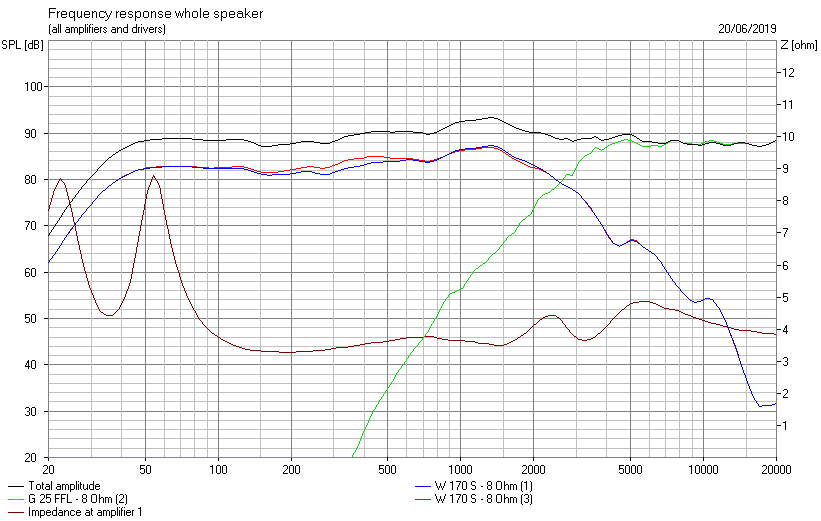

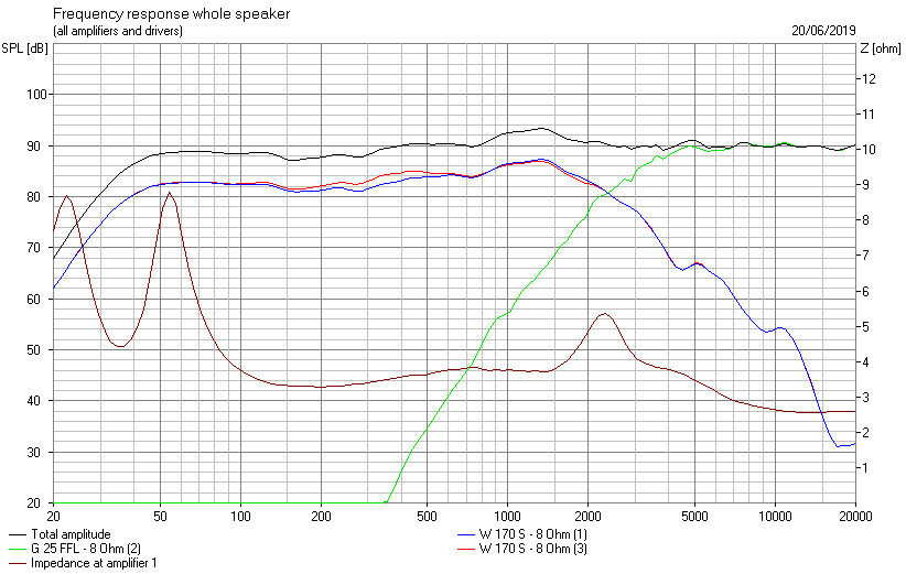

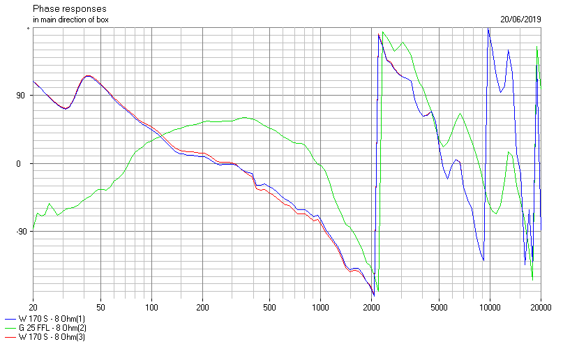

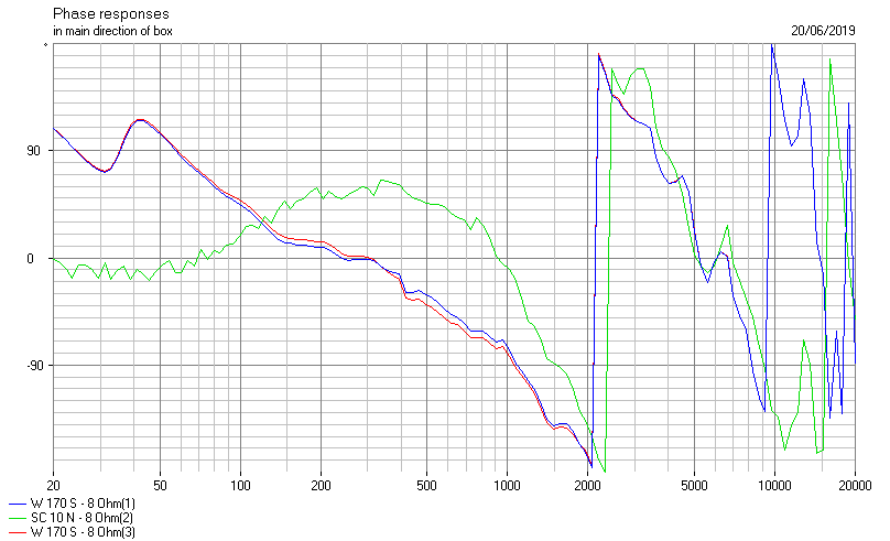

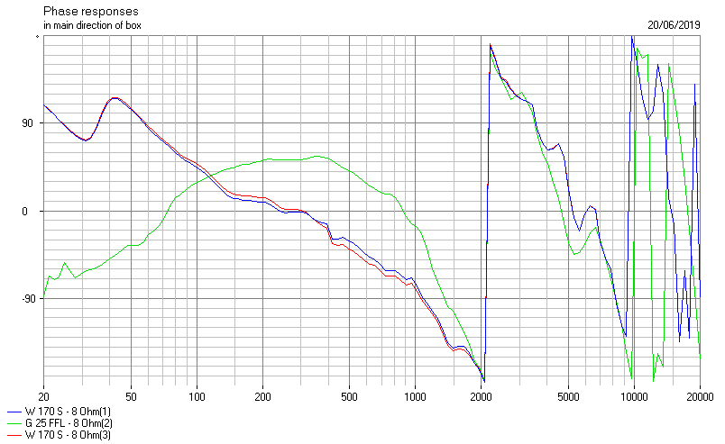

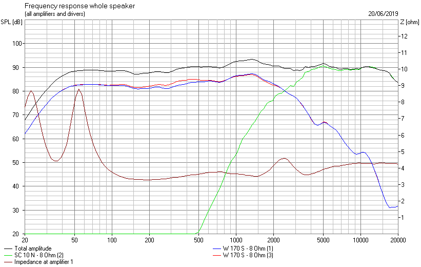

Right. It seems the SC 10 N gets hot, and then distorts a little. But only the one. And not always. I'm going to replace my tweeters soon and I ideally want a drop-in replacement. The tweeter I like is a Peerless D27TG35-06. I managed to find some data files to plug them into my simulator. Frequency response and phase response look good. I can improve phase response by letting the tweeter stick out a bit, which I think I'll do. I can modify the crossover slightly to get a much better frequency response above 6 kHz, but it sacrifices impedance a little too much. Having a few -2 dB spots and a generally -1 dB FR for the tweeter is worth the nicer impedance.
I chose D27TG35-06 because the inductance is similar to the SC 10 N, it fits into the hole perfectly (104 mm diameter), it has a power rating of 100 W, and it's inside my budget.
I have attached with SC 10 N, then the new one in with no modifications, vs a slight mod to the crossover.
Note, it's not G 25 FFL, that was just in there and I didn't rename it when I loaded all the D27's data.
