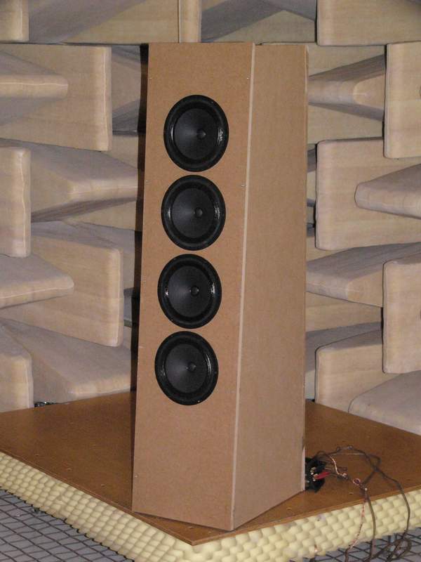

Visaton is currently working on a project (called Quadro) using 4 B200 speakers on each side. It is said to have a sensitivity of 96 dB.
Attached you will find a pic of the prototype.
I am aware that this is no boxless speaker but it should be of interest to all those single ended triode users out there, as this speaker is designed to play with small power triodes.
