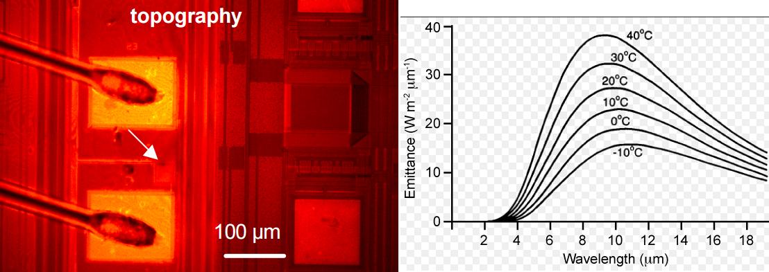

An IR thermal gun could maybe measure that? Some hi-end ones have quite small spot diameter.
Despite often having a spot laser, they tend to be quite large area IME.......maybe they have improved. I did attach a tiny thermocouple to the top of a stylus shank with thermal adhesive, and only measured a few deg C rise, however the thermocouple would have been a significant thermal load. But I thought it was consistent with perhaps 15 deg C rise for the diamond (with no significant gradient within the diamond).An IR thermal gun could maybe measure that? Some hi-end ones have quite small spot diameter.
You have to use thermal conductivity and specific heat of filled vinyl, both of which are larger that the textbook numbers for pure PVC.
An IR sensor won't work- because of the tiny areas, you have a wavelength issue when trying to get sufficient spatial resolution. A thermistor won't work either because of its thermal mass. I truly believe that VdH was having us on a bit- this is an incredibly hard measurement to do and his number appears nonsensical.
SY
Diffraction-limited spatial resolution for room temperatures is around 10um, adequate for passive IR imaging of cartridge cantilever.

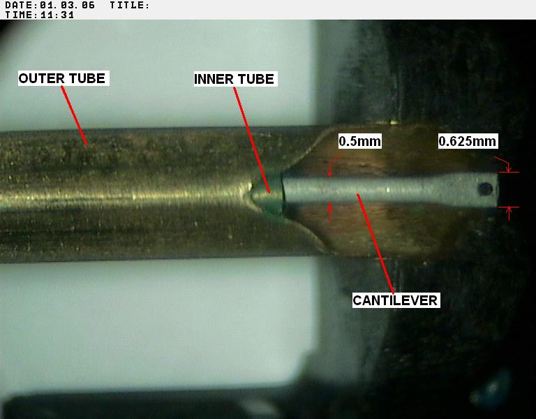

Quite probably. Do you know, even approximately, what the value of those constants might be for the composition of vinyl used in records?You have to use thermal conductivity and specific heat of filled vinyl, both of which are larger that the textbook numbers for pure PVC.
It's a safe approximation to attach a small thermocouple to the cantilever, which is what I've done, and obtained negligible temp rise.SY
The value of IR imaging would be in viewing any trail in the groove immediately after the stylus has passed. But the dimensions of the groove and the resolution required makes wavelength a problem - unless the groove is very hot and the trail very long, which seems unlikely. Tricky photography too.

The claimed measurement (from what I understand) isn't the cantilever, it's the contact area between groove and stylus. There's no way in the universe that the cantilever is going to be at 160 degrees.
Probably. I attached a thermocouple junction to the top of the stylus shank, at the point where it passes through the cantilever - just because that is as close as one can get. Temp rise was negligible, and that at least confirms something I suppose. The tiny contact location between stylus and groove is simply very difficult to observe directly, especially from a thermal point of view.The claimed measurement (from what I understand) isn't the cantilever, it's the contact area between groove and stylus. There's no way in the universe that the cantilever is going to be at 160 degrees.

The cartridge cantilever is a large enough target for taking a discernible image with a thermal camera during play. A 10 d C temp rise above ambient would be clearly visible. Witch hunters would have flooded the internet with such images. Have we seen any?

That was to Jan and lucky, sorry to be unclear. You could measure the cantilever, but it's not of much relevance to determining the truth (or lack thereof) of the temperature claim made by someone selling styli who, in the finest traditions of high end audio, won't give any detail on how he got the numbers he's using in his promotion.
