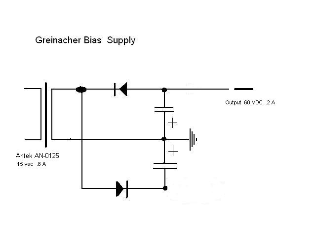

I looked at the Greinacher voltage doubler. But I'm not sure I know how to use it. He puts one end tap between the caps to ground. The other he splits between a 'forward' and a 'reversed' diode to get a positive and a negative voltage. Would I omit splitting the 'positive' end tap and only use the 'reversed' diode to give me the negative bias voltage? The AN-0215 is capable of .8 amps. The AN-0115 is capable of .33 amps, would that not be enough? Or is it the effect of the doubler that makes the 0125 necessary?

A Greinacher doubler consists of 2X caps. and 2X diodes. For a bias (C-) supply, the positive end of the cap. stack gets grounded. A bias supply has to be able to supply a small amount of current and the DC draw on a doubler should be limited to 1/4 the AC RMS value. I took no prisoners in suggesting the AN-0215. Use 220 μF./100 WVDC caps. in the doubler stack. A 1 A./100 PIV Schottky, like the SB1H100-E3/73, gets my nod for the doubler diodes.

I've attached a drawing of the Greinacher doubler, I think. Is this correct? I wasn't sure what to do with the cap and the output from the 'positive' side of the rail. And I figured a drawing would make it easier for you correct it.

The polarity of the bottom cap. in the doubler stack is backwards. The center of the cap. stack connects ONLY to the power trafo. Ground that positive side! The Greinacher, AKA "full wave" doubler is 2 half wave rectifiers wired back to back. There is some justification for using "full wave", in that both halves of the AC cycle get used and that the ripple freq. is 2X the AC mains freq. BTW, I went back to the AnTek site. I was wrong about the AN-0115. It will be fine. I was thinking 30 mA. RMS, not 300 mA. RMS, which is the case.
