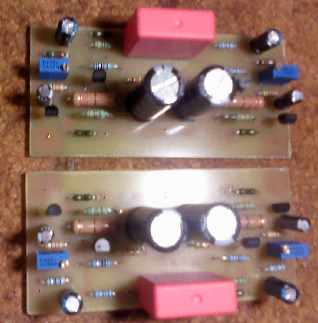

As you can see in the pic (post#1) I did it on the perfboard - heavy wires underneath...

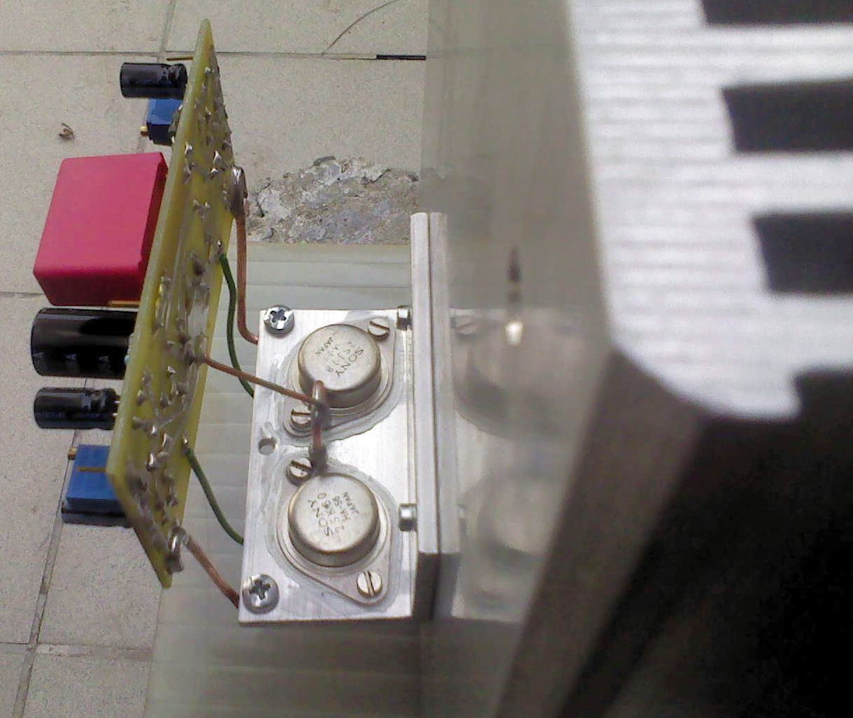

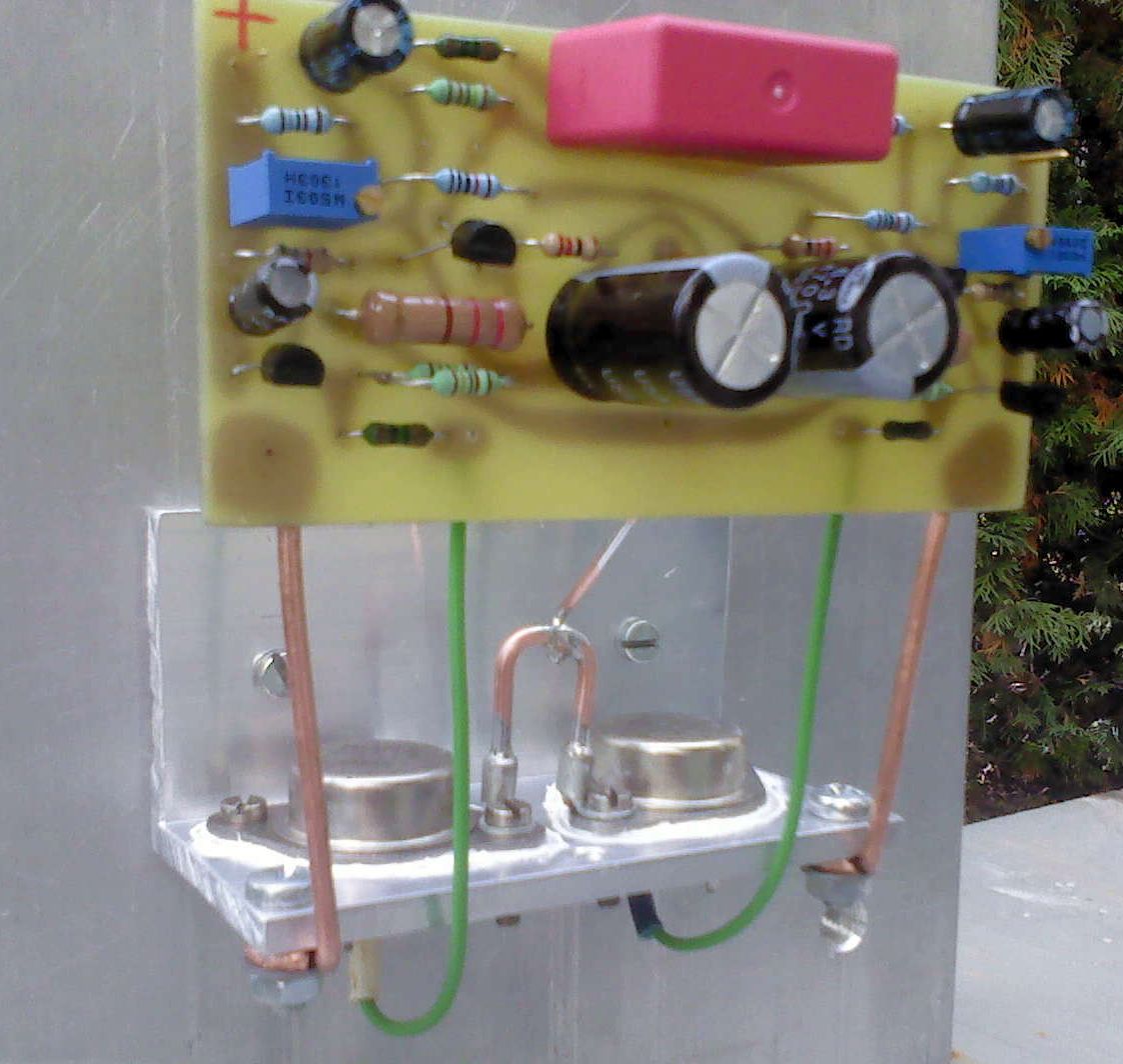

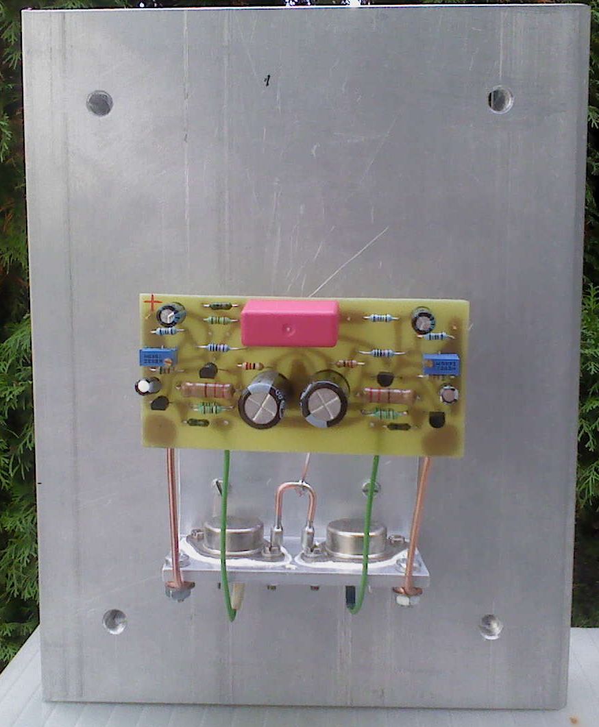

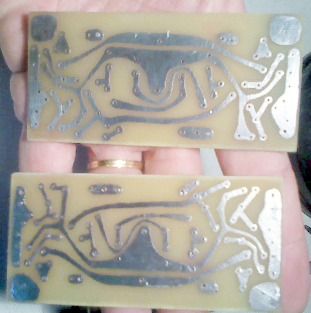

I chose to mount the PCBs and VFETs in such a manner that provides an easy access to both sides of the PCB (for easier change of components). Even the whole PCB can be replaced/taken out without much effort and without taking the case apart.
Construction is mechanically very strong (although it doesn't look like that) because 2 supporting solid copper wires are very thick (3mm) and the drain connection doesn't allow movements to opposite direction.

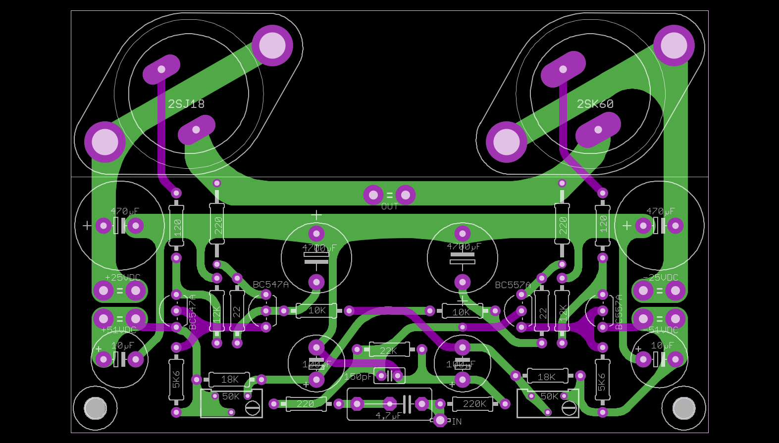

A good DIY-friend of mine, Harry, asked me, if it is possible to do a layout for this amplifier and get some professionally-etched PCBs.
Harry: this is of course possible! Find attached an image of my current layout! (The size of the PCB is: 100 x 66 mm)
The only concern that I have, is:
My EAGLE-library does not contain the package for the SONY TO3 - output transistors (2SK60 resp. 2SJ18).
Nor am I able to GOOGLE the pinout for the SONY transistors.
I took any (!) BJT - TO3- transistor instead.
Is my EAGLE-package correct?
If you (or anybody else) can answer my question:
I will happily offer you a pair of professionally etched PCBs (1,6mm - FR4-PCBs, 2-layers, 70µm copper) for 15€ (worldwide shipping is included).

Steve, I have never before come across your datasheet of the used SONY-TO3s in the past.
Thanks a lot - I will evaluate my EAGLE - package now (maybe tomorrow).
Best regards - Rudi
