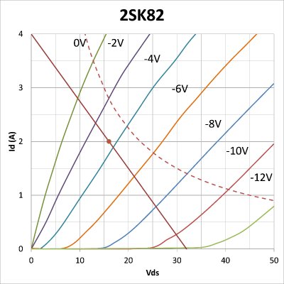

...don't want to do that for sure so i searched a bit and found that Michael Rothacher has published the measured curve... and the load line you chose fits the 2SK82 and 2SJ28 as well:
Yes i know Juma...the dashed line the picture i sent is 45W limit.
all i need to do is keep load line below that if i want to run the VFETs conservatively ( 50% rated power ).
Your devices have alimit of 63W, which you are running at 25 W, mine have a limit of 95W.
Did i get this right?
I wouldn't want to make a mistake...not with these.
Edit: the load line in my picture is the one MR chose for his aplication...not what i intend to use .
The item pictured is merely an example of a loadline from an article I wrote. It was not used in a project. Again, it's just an example.

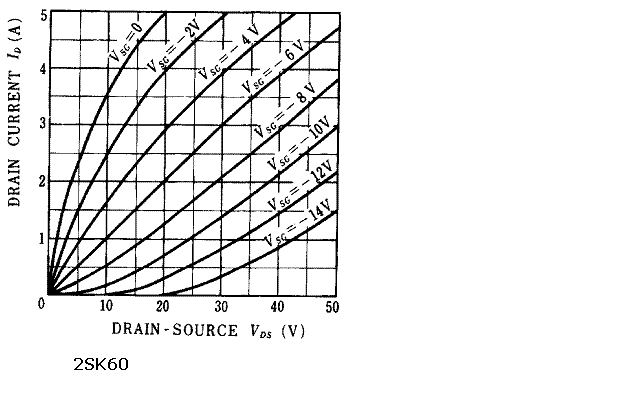

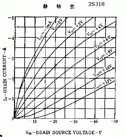

Look at the output char. of the VFET and you'll see that k60 needs it's gate at 10V lower potential than the source (and vice versa for j18). Since the source of k60 sits at -25V, the gate has to be at -35V so when we want the common source (drain follower) output stage it's only logical to use higher voltage rails in the front end (biasing) stage.
