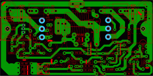

This is my first post on the forum.I've "lurked" around for quite a bit.
Long story short...I've made a layout in Sprint.Thanks has to go to the previous posters who has made available their "lay" files(Thimios;Prasi;Dacz).It made the job a little bit easier.Not forgetting the huge input the OP(Ranchu32) in conjunction with Hugh Dean(AKSA) has had in component value selection.
I'm attaching the layout for perusal.Please have a look for any faults and I will correct.When the layout gurus are happy,I will upload the full Sprint "lay" file and pdf's.Don't be too harsh as this will be my first layout in quite a couple of decades and I have only been playing with Sprint for less than two weeks.
The size of the pcb is 100mmx50mm.I was looking around at pcb manufacturers online and that was the best size that would be cost effective for diy purposes.So,a bit of working backwards,and a little less surface area to work with on the pcb.

Welcome to Diyaudio Phunk67.
I can see wanting to try a layout but given that about 3 or 4 different proven ones now exist (and developed by experienced layout artists). I'm not sure if this is the best thing for you to do here if your interest is in getting a good sounding and working PCB. As this design is pretty mature at this point, it would only make sense if your layout offered some clear advancements. It is much larger than the previous boards so that is not good. Compact amps are preferred. I don't want to discourage you but 3 months ago would have been the time to offer a layout. So there's always value in learning how to do layouts and Sprint and looks like you taught yourself nicely. Maybe apply your new found skills to an Amp that is still in early layout stages?

Hi xrk971.
Thanks for the input.Let me explain the reasoning for posting.
I was hoping to use the layout for myself as I would outsource the pcb manufacturing to one of the online pcb houses.Cost effectively it would seem prudent to use one of the available size boards that they provide,which in my case is a 100mmx50mm board.At +-20USD for 10 boards it would be a cheap price for the specific size board.
Considering the effort involved in creating the layout,I thought it might benefit users of the forum who would maybe be interested in this layout.
Regarding size...this board has a surface area of 50 square cm.The other three boards which I have copies of has surface areas of 53,70 and 83 square cm's respectively.
You are right,i am learning still.I was hoping to get some guidance for my layout so that I can get my boards made and give back a little something to the community.
I've read through a couple of threads re: layouts.Some stuff makes sense and some are guideliines.I will have to go through some documentation re:layout rules(especially trace thicknesses and distances between tracks).I've used the other "lay" files as reference for trace thicknesses and trace gaps.

The PCB houses go by maximum extent so 50mm X 50mm is next cost size down and 100mm square is the $10 price point. The other amps may be 5cm2 bigger but the aspect ratio is smaller in sense it is squarish and the outputs are closer together allowing smaller heatsink (like the Dell Pentium CPU heatsink I am using). Obviously 50mm square is too small (unless you went all SMT). Thanks for sharing in any event. But if you want a working amp - the easy choice is send Dacz's latest Gerber to PCBway etc. I have actually ordered a set myself and waiting for them to arrive.

Thanks for the feedback.After you posted I went looking at prices,specifically SeeedStudio.I must say I was a bit hasty as I did not check the options properly.They do have an option to order less boards(5 minimum).With options sorted,5 single layer boards at 10x10cm came to 18,90USD excluding shipping.Plus another 10USD for shipping which brings the total to +-30USD.Not too bad at all.I've got most of the parts for the amp except a couple of small caps which I've allready ordered online.I'm going for a stereo set.The rest of the pcb's will be utilised(always got a friend or two who's interested).
I'm also ordering pcb's for an AKSA 55 clone(still waiting on a couple of items).That was how I got to this thread,by noticing that AKSA(Hugh Dean) was giving help.His explanations are very concise and thorough to me(even I understand a lot of what he's saying and I've been out of the loop for a couple of decades).
Regarding the distance between the outputs: once I read your reply,it came back to me that there was a mention in the thread about the distance of the outputs in relation to each other.Silly me,off I went bulldozing to create a layout for my needs without applying the principle of double-checking all the details.

phunk67, I'm no expert on PCB layout but to me yours looks OK. I understand your desire to come up with your own board.... this is DIY after all.
Q3 needs to be on a heatsink, either the main sink or a small standalone.
Not taking away from it at all but I found, using parts on hand, that Dacz layout was a bit tight. I had to bend a lot of resistor leads back under the resistors and my electrolytic caps couldn't sit right over there spots. If your redesigning might as well leave a bit of extra room.

Check the PSRR. It's much poorer on the negative rail. If you add a cap multiplier to the -ve rail the PSRR improves dramatically. I used B2Spice.
From -35 dB to about -89 dB ( with cap multiplier) at 1Khz. Quite good all the way down to 20Hz. I'm building one and will check if this difference can make a significant difference in sound.

Sorry..I was wrong.The layout is right.
Dear phunk67,
I like your layout very much. The Power Transistors are at a distance at either end and make use of the heat sink properly. If you order the PCBs, Please keep two for me. Thanking you,
