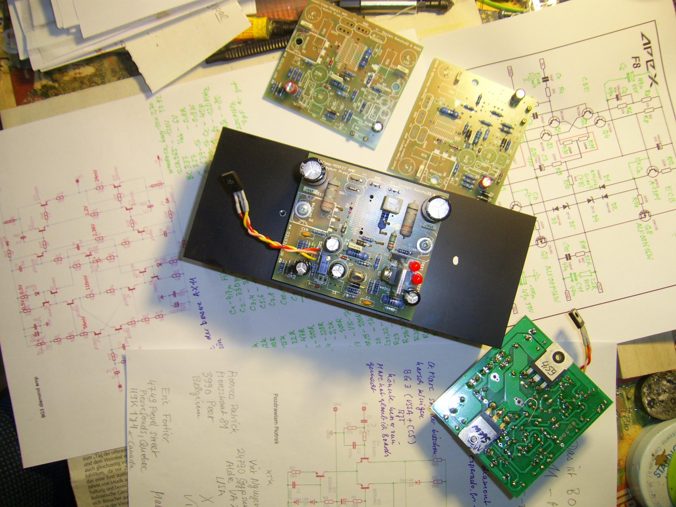

Hi X
`I use the Abletec 53v SMPS on my amps like VHEX+ with two pairs of 4700uF separated by rather large two parallel 5R power resistors for a CRC between the SMPS and the amp.`
It is not 5R power resistors way to high values for that CRC filtering ? , I think 0,5R or so is more appropriate value .
Regards !

It would be high if you expect high continuous current draw. But depending on your use, a higher R of course gives better filtering and lower ripple, which gives "blacker blacks" for music. I don't play at loud volumes continuously but like high dynamic reserve. This particular R values of 2.5ohm gives me ripple less than 1mV at the amp rail input. This setup will not work for class A as that level of current draw will appreciably sag the rail voltages.

I agree with the cost/performance trade, Hugh. Yes, it only works for this particular Abletec SMPS. It's a nicely designed and made one (Denmark, I believe) and is a close out item that's $20 (free shipping). If it cost $80 - I would have gone linear with an Antek toroidal 300VA trafo and caps.

If someone wanted to use this amp for lets say a kids room with a lower output power, could this amp be powered with a lower voltage supplies while keeping it's magic !!
I have a 200W, +/-25Vdc supply I'd like to use. If this is doable, would I need to change lots of values, if so which one ? Would I have to keep the bias around 125mA like mentionned earlier in this thread ? Sorry about all the questions, this would be a nice, compact and sweet sounding unit.

Hi Eric
I can say for certain that this design works with 25V split rails because that's what I'm using! I've lost track of this thread in recent weeks; the circuit I have referenced in post #1 is not current anymore. Give me a little while to trawl through the recent posts and I will point you to the best schematic with component changes for your power supply.

Thanks for everything Ranchu, no rush.
I believe the latest schematic is on post no.1231 from DACZ. His schematic follows Hugh's last recommendation and is the one with the good connection for C7.
