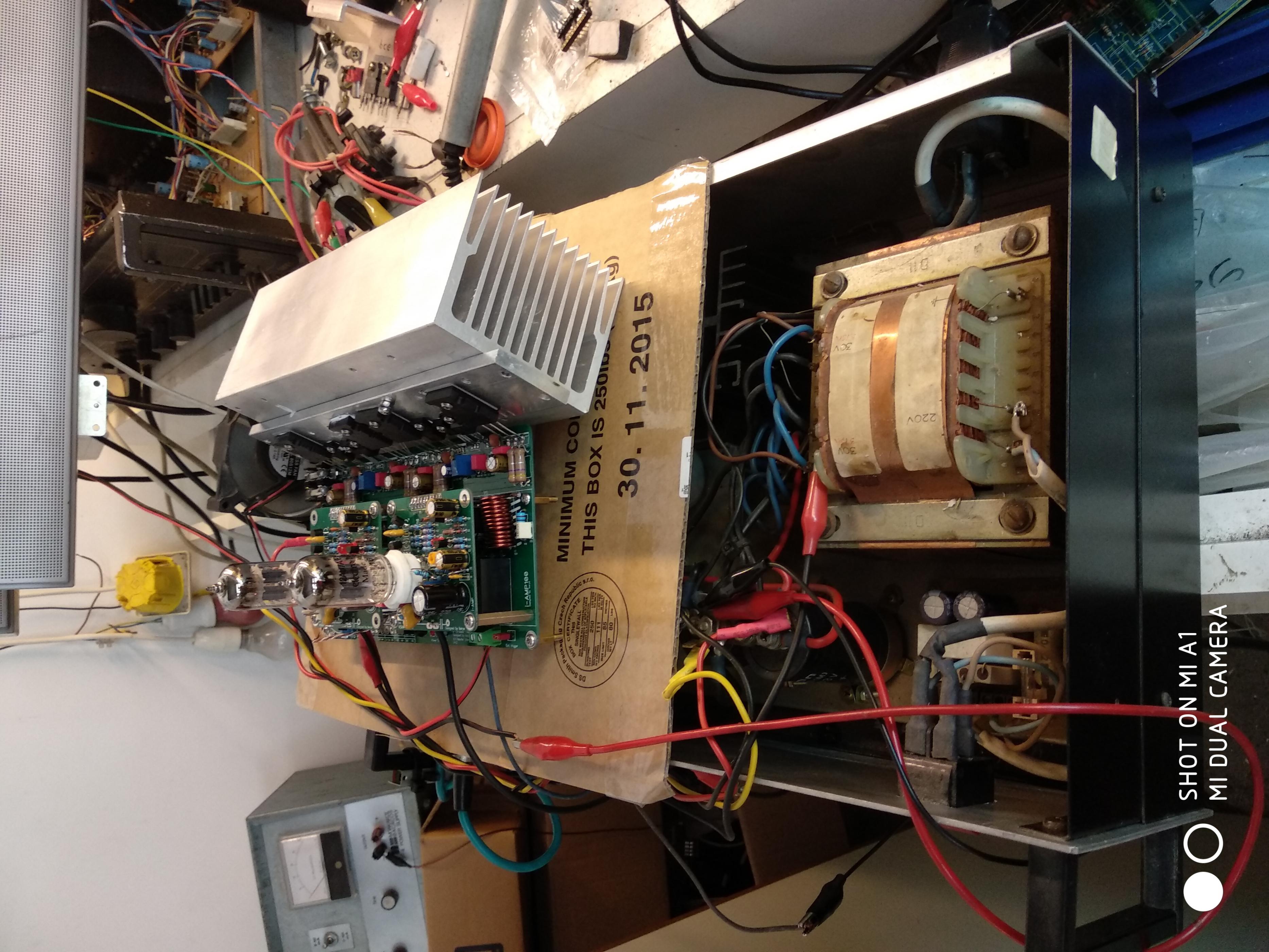

VSHA+I-AMP
Power supply=/-42V
Inp sensivity=130mV
Vout=26v RMS/6R
Pout=112W RMS.
Power supply=/-42V
Inp sensivity=130mV
Vout=26v RMS/6R
Pout=112W RMS.

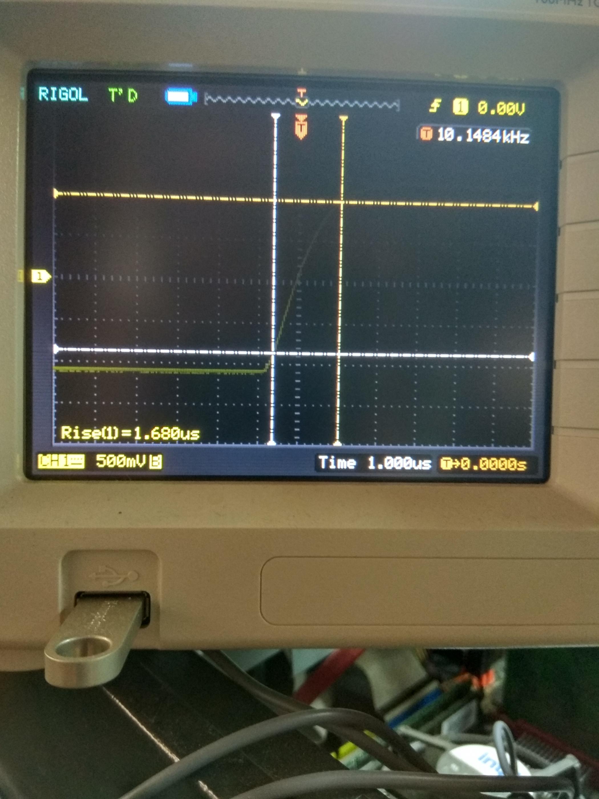

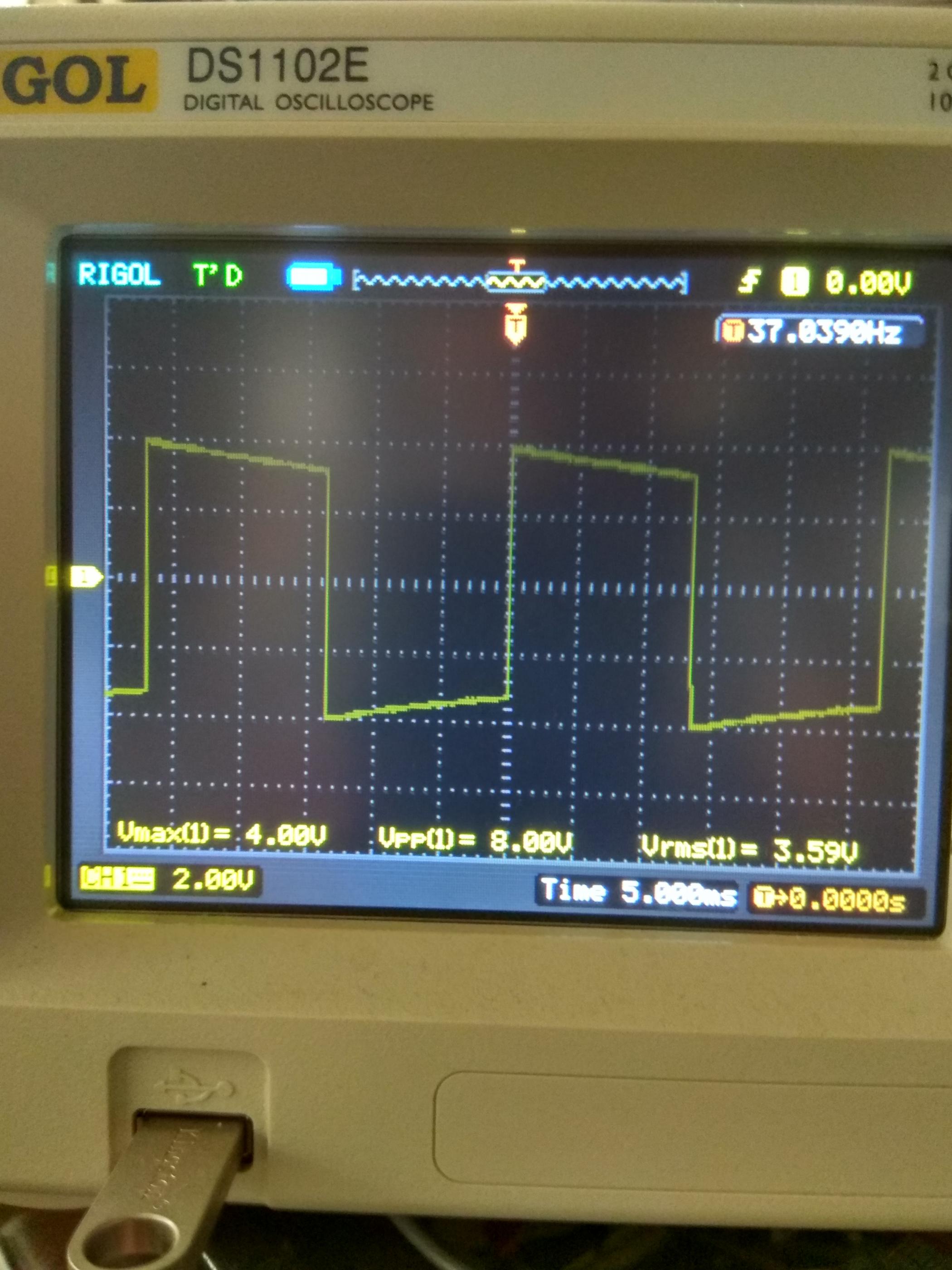

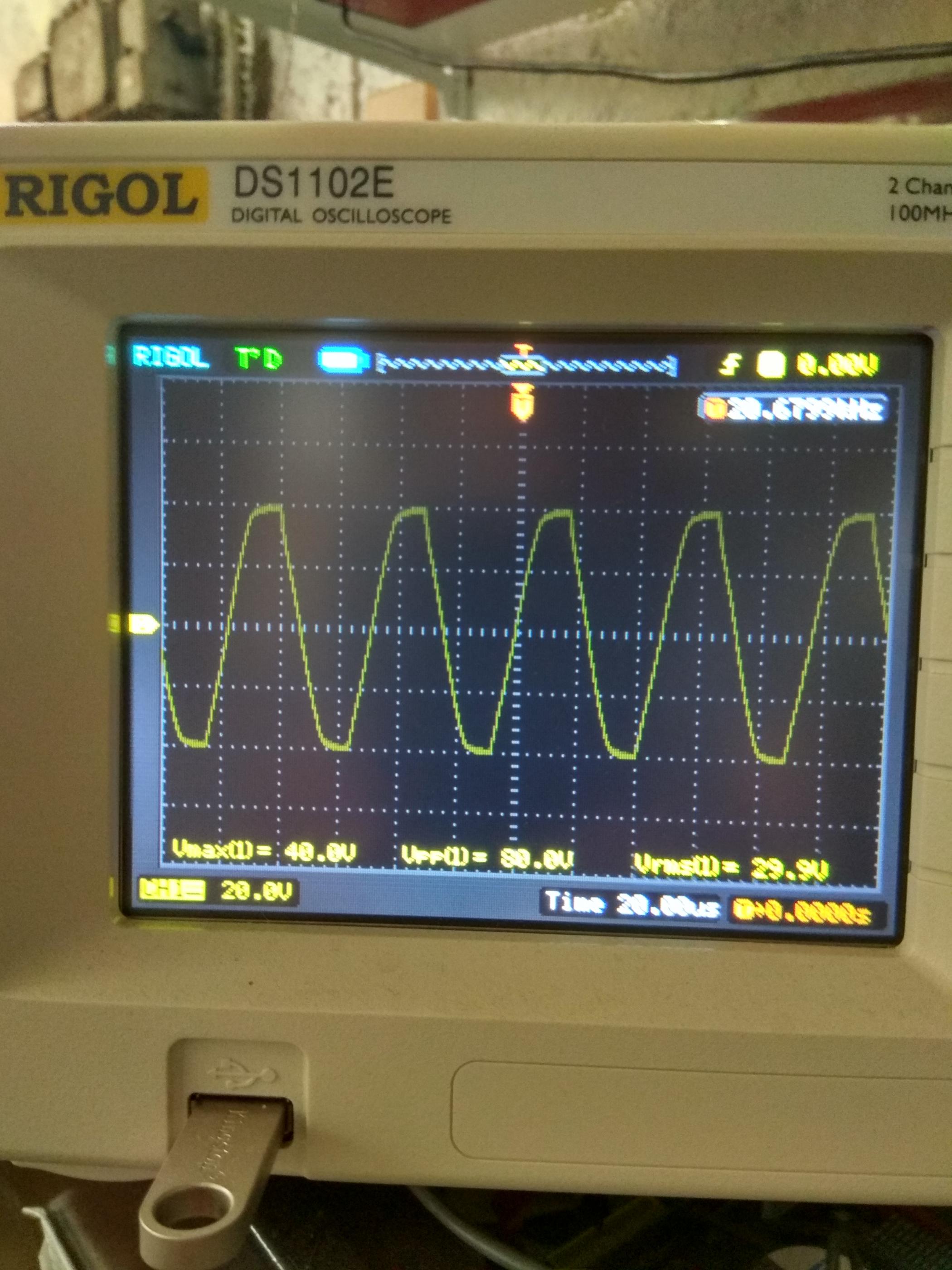

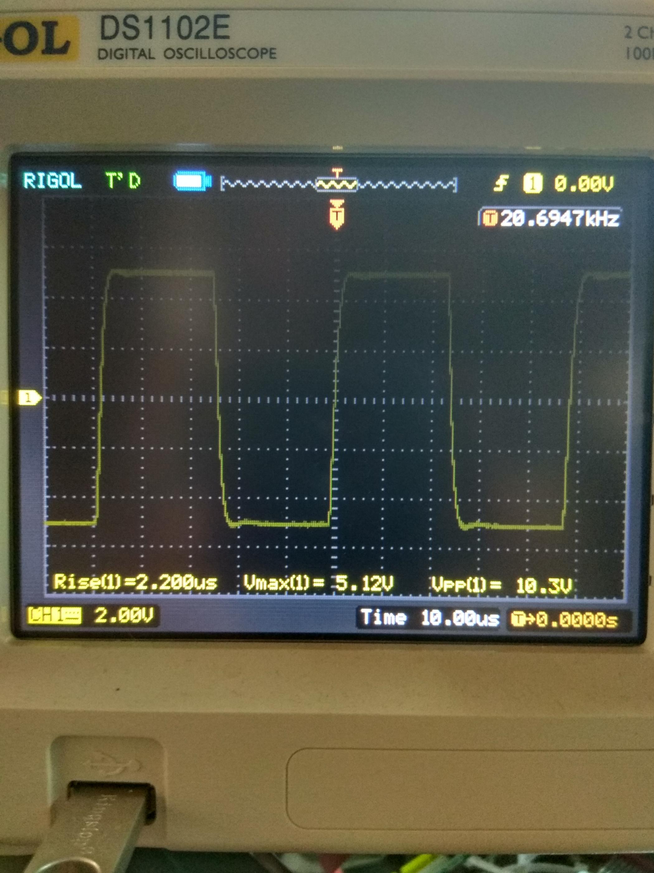

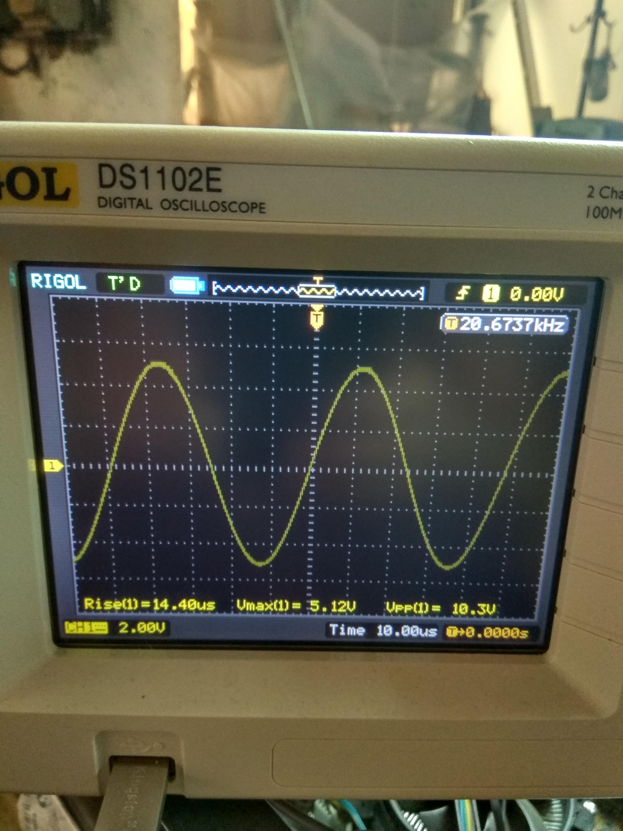

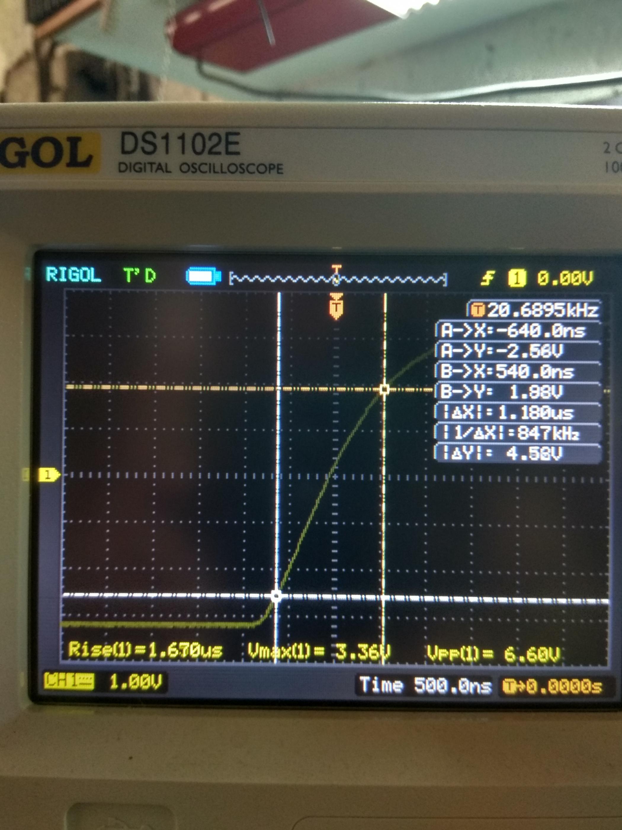

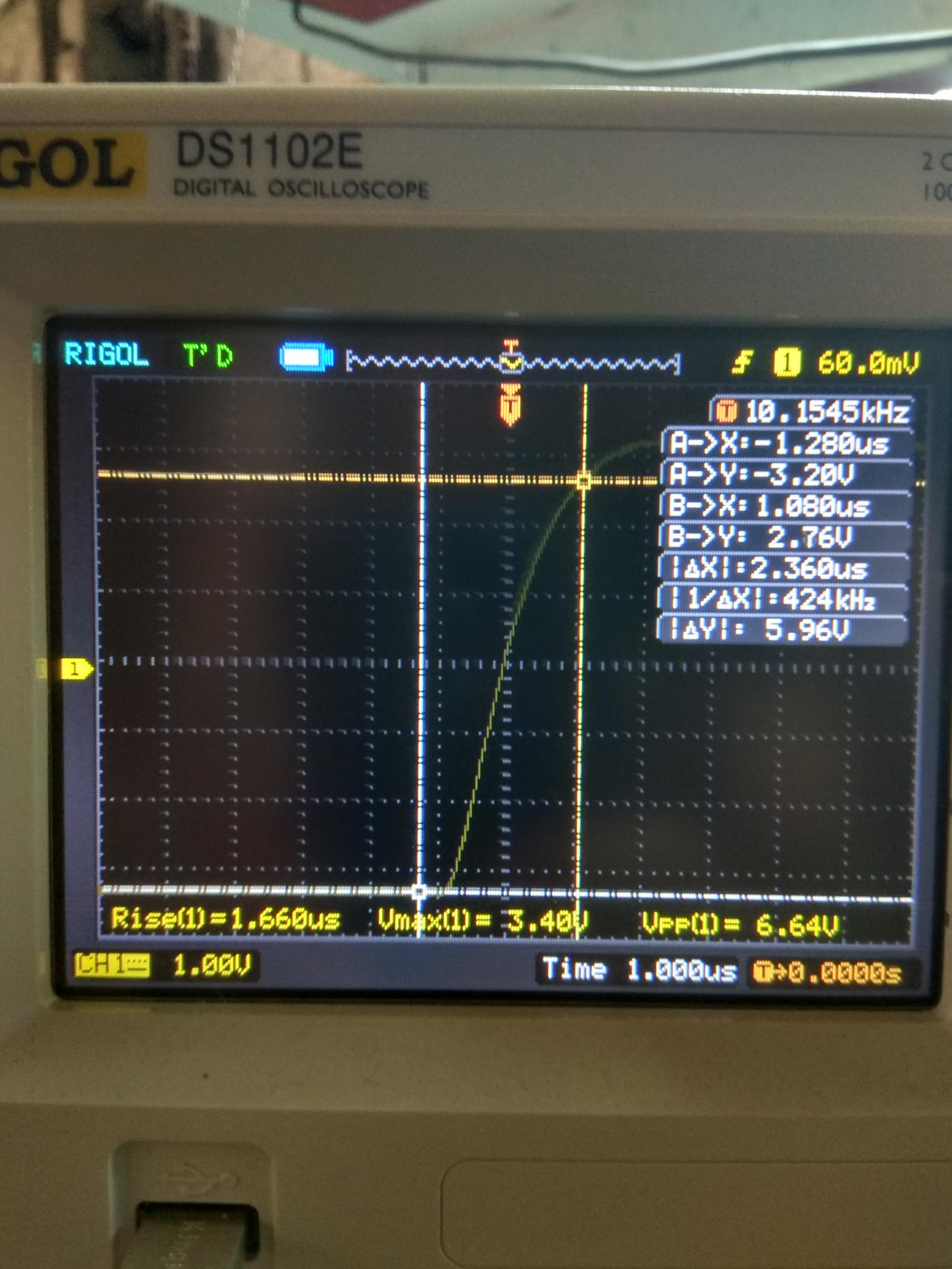

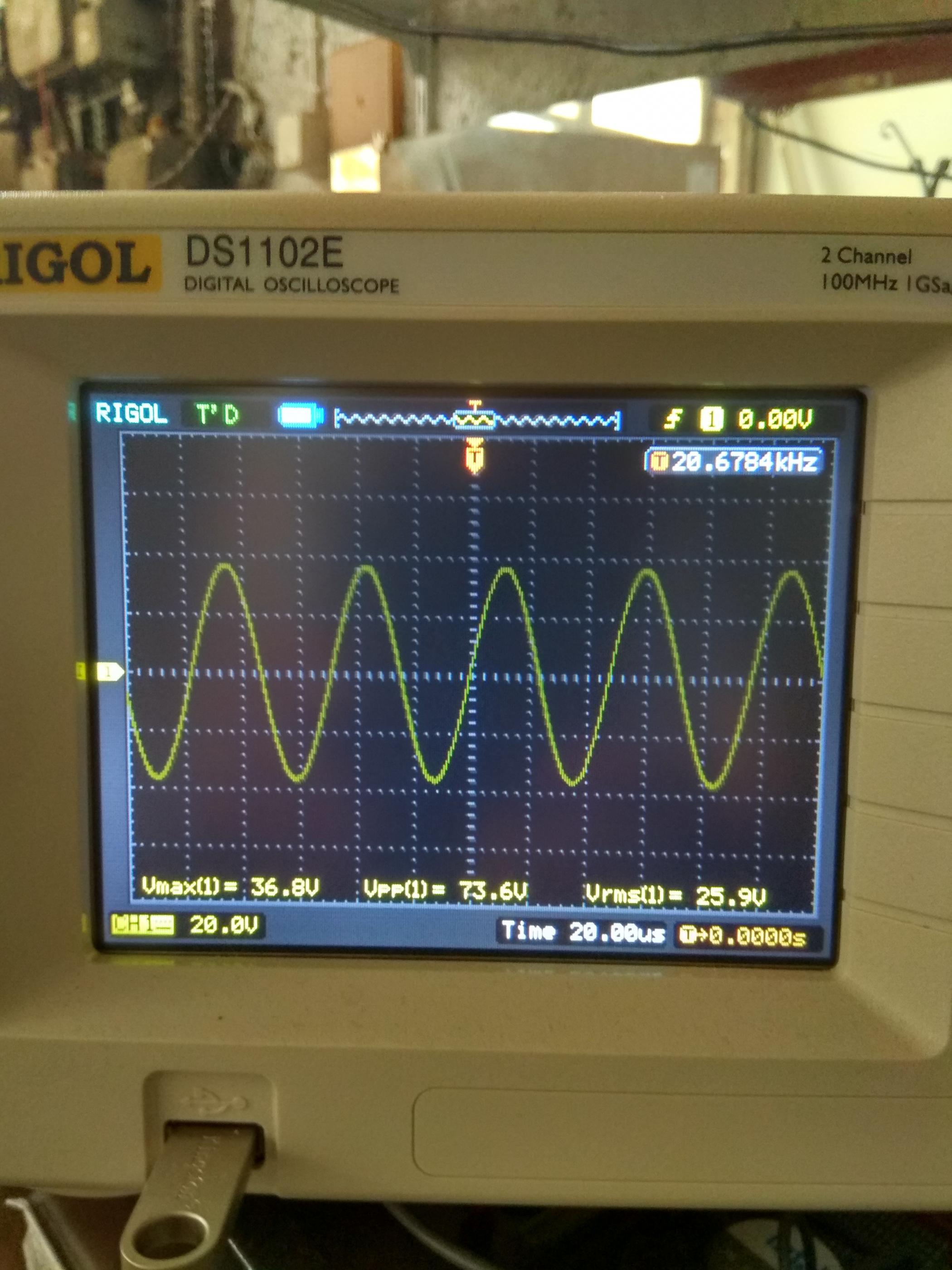

The HD version for 12au7 tube is bellow (same as post no #23), heater is 6.3V ac , but you can cut one track and make it for 12DC.
I didn't have any problems with it but had some with 6n16b tube and had to add another compensation cap.
Just in case I have made a tests on v4 version too with additional miller cap at tranistor T1, amp is rock stable, no changes in performance.
Bellow few squares and triangles from it (2 x 47pF miller caps at the VAS stage)

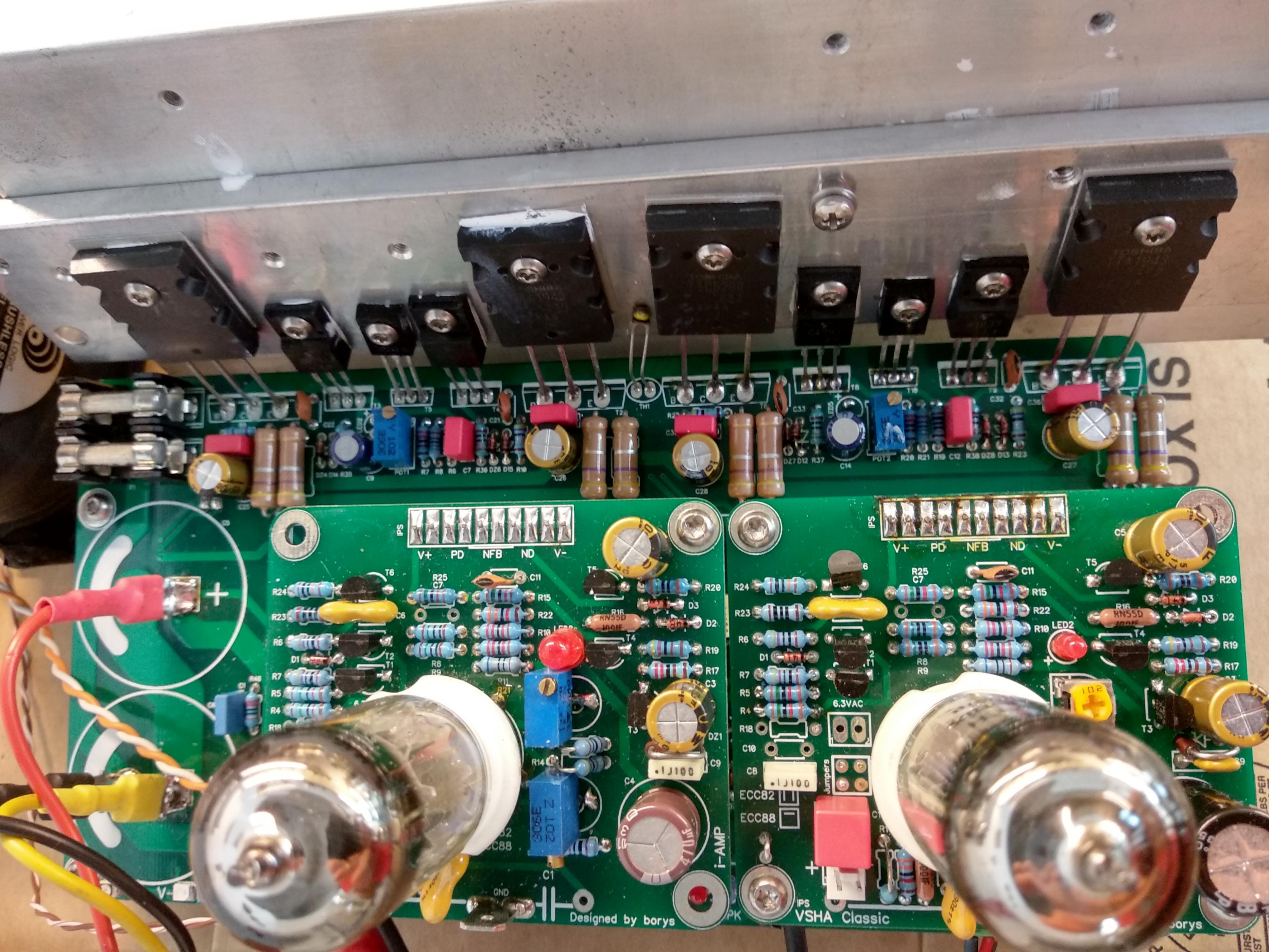

Hi, I am a newbie in building solid state equipment, especially power amps. I am interested to build the VSHA classic because it is a ready tested design with the necessary files to fabricate the pcb.
From studying the schematic for the output stage, it appears that the mosfet source followers are biased by the 4 1n4148 diodes; so as to give approximately 2.4 to 2.6 volts across the gates of the n channel mosfet and the p channel mosfets.
Purpose of the 1k multiturn pot trimmer appears to me as being for further adjusting the bias voltage across the 2 gates by reducing the voltage between the 2 gates.
This is probably a stupid question to all you experienced builders here; but if I may ask, how is the voltage offset at the sources of the 2 mosfets trimmed to 0 volts? as there does not appear to be any off set adjustment?
I know that the 2 halves of each triode is not a perfect match and can never be. So how does one ensure that there is 0 volt offset at the output.
Perhaps someone can explain the output schematic to me.
