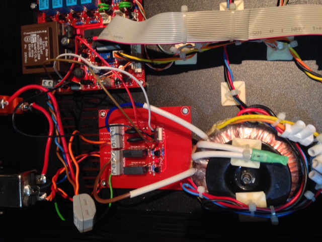

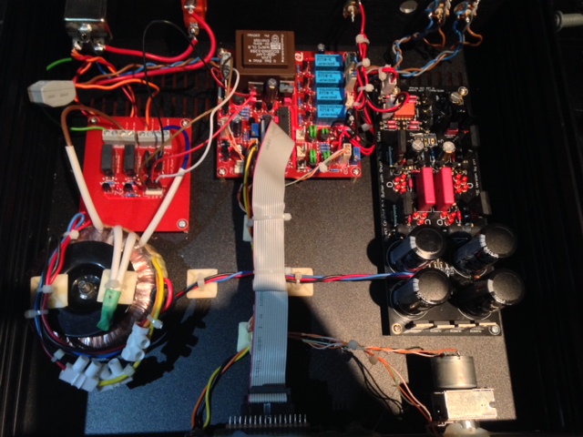

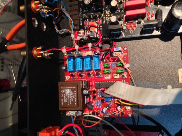

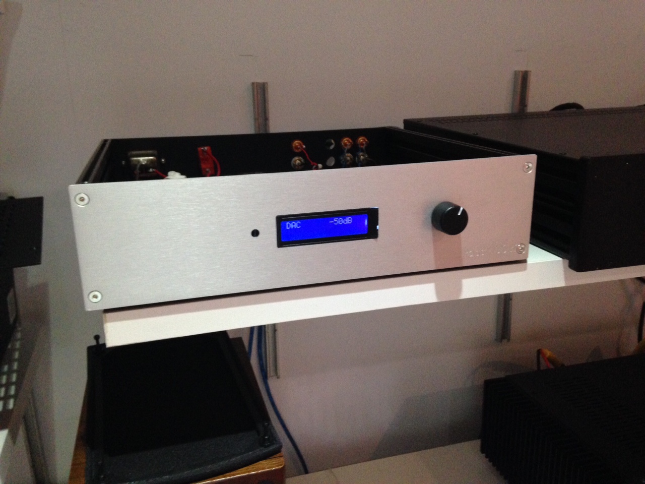

Photos of my Vcpre Gem.

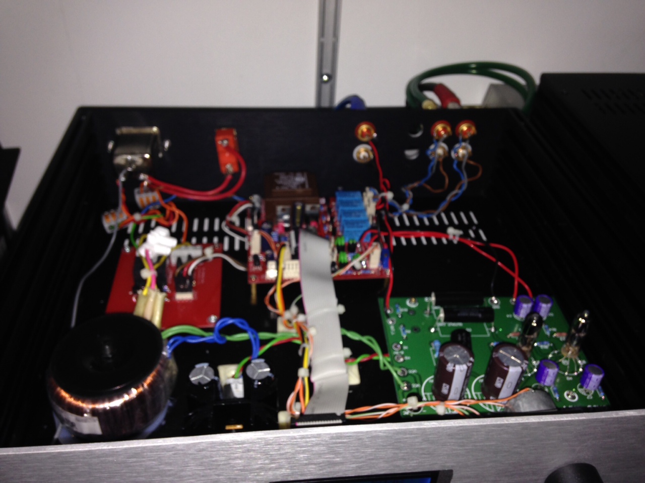

Hi friends,
Here is my Vcpre. It is awesome. It has been partnered with the Pass DCB1 Hot-Rodded from Tea-Bag and was fantastic. As both modules do not have gain and my F5 and me needed some meat, I partnered it then with the Lukasz Fikus Lampizator in preamp mode and now I am fliying.

Hi friends,

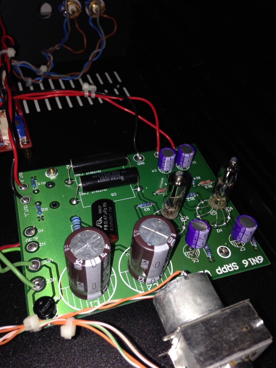

Thanks!
It was conceived as Vcpre --> DCB1 but I needed more gain. Then now I switched to Vcpre ---> SRPP.
I showed photos of both configs...

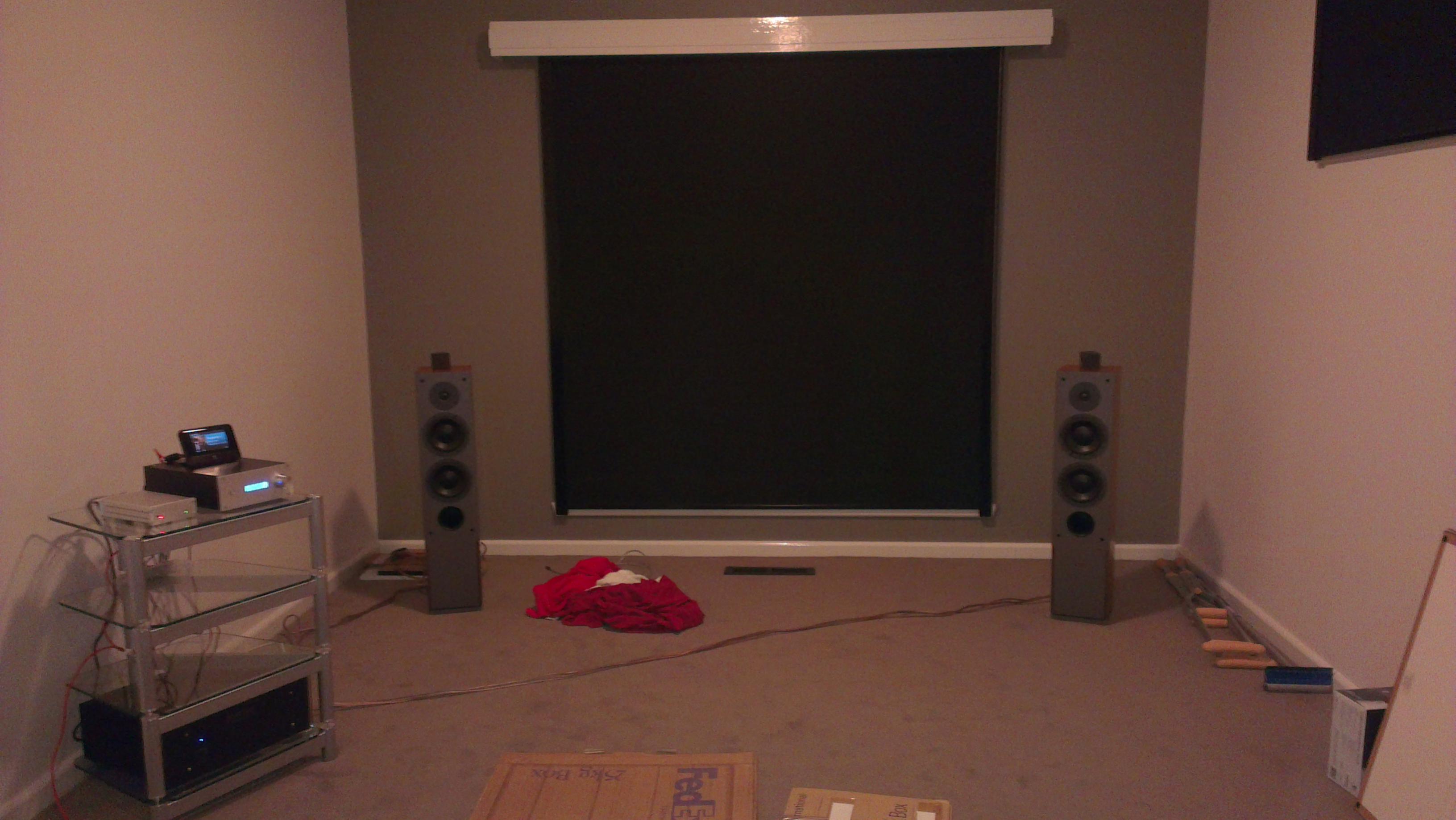

That's awesome Jorge! Very nice result. Finally started setting my system up again last week after home renovations. Initially I used a Squeezebox Touch into a Valab TDA1543 NOS DAC as the source. It sounded very good but a bit bass shy. Last night I setup my SACD player and the difference was astounding. Sweet music with all the clarity and transparency I had previously experienced using my manual DIY LDR attenuator. A sound so "naked" and untainted and vibrant. So thank you once again Rudi!
Looks like I know need to find a new DAC though as it looks like the passive IV stage in the Valab doesn't have low enough source impedance to work well with the VCPre.

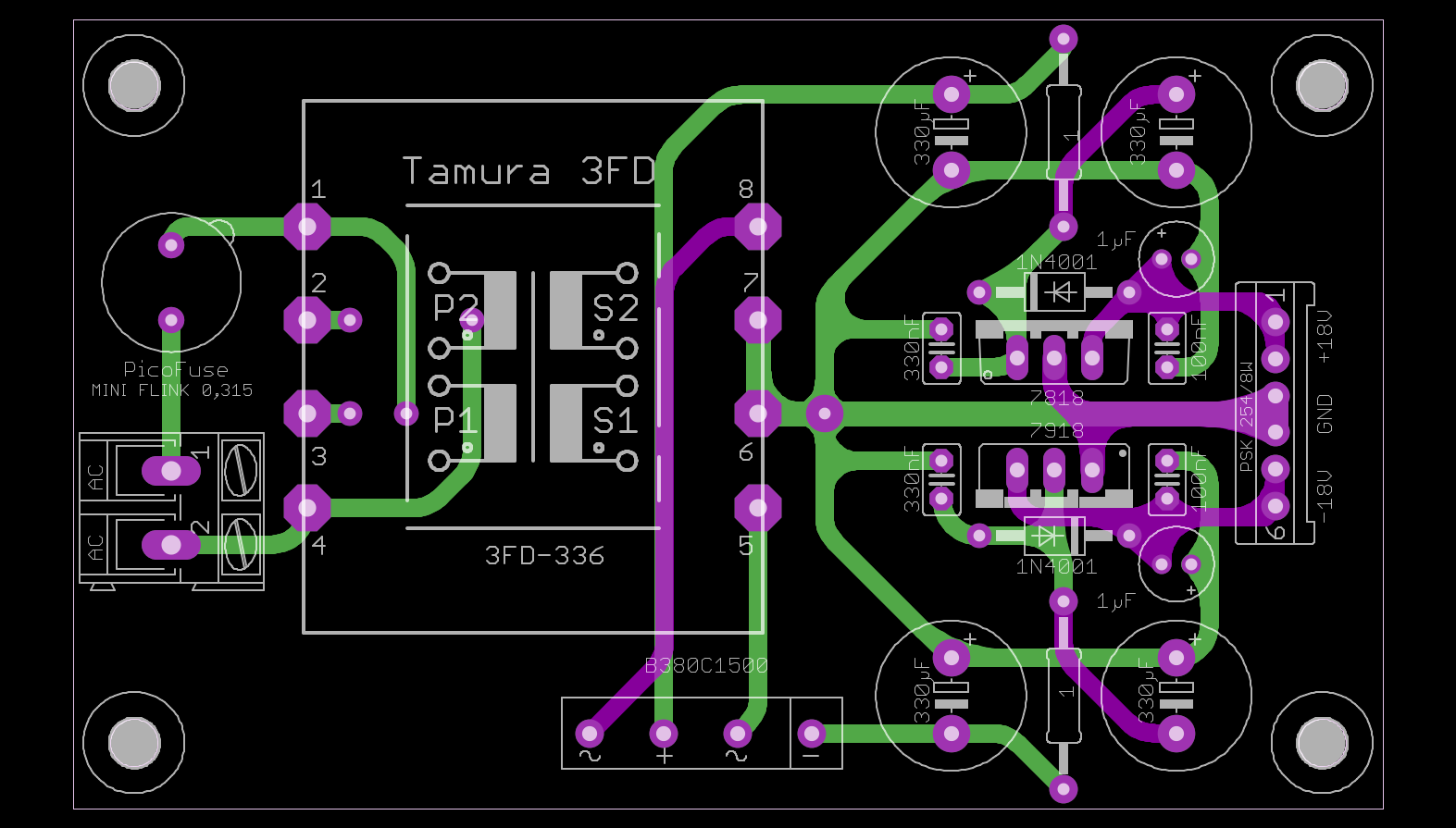

Bill, I will go and use the CALVIN - buffer. The CALVIN - buffer is an enhanced version of the JLH-buffer, and I like its schematic very much.
If you are in need of a PSU for it: I have just layouted a 115VAC/230VAC PSU for the CALVIN-buffer (see attached image).
Do you want some PCBs?
Best regards - Rudi_Ratlos

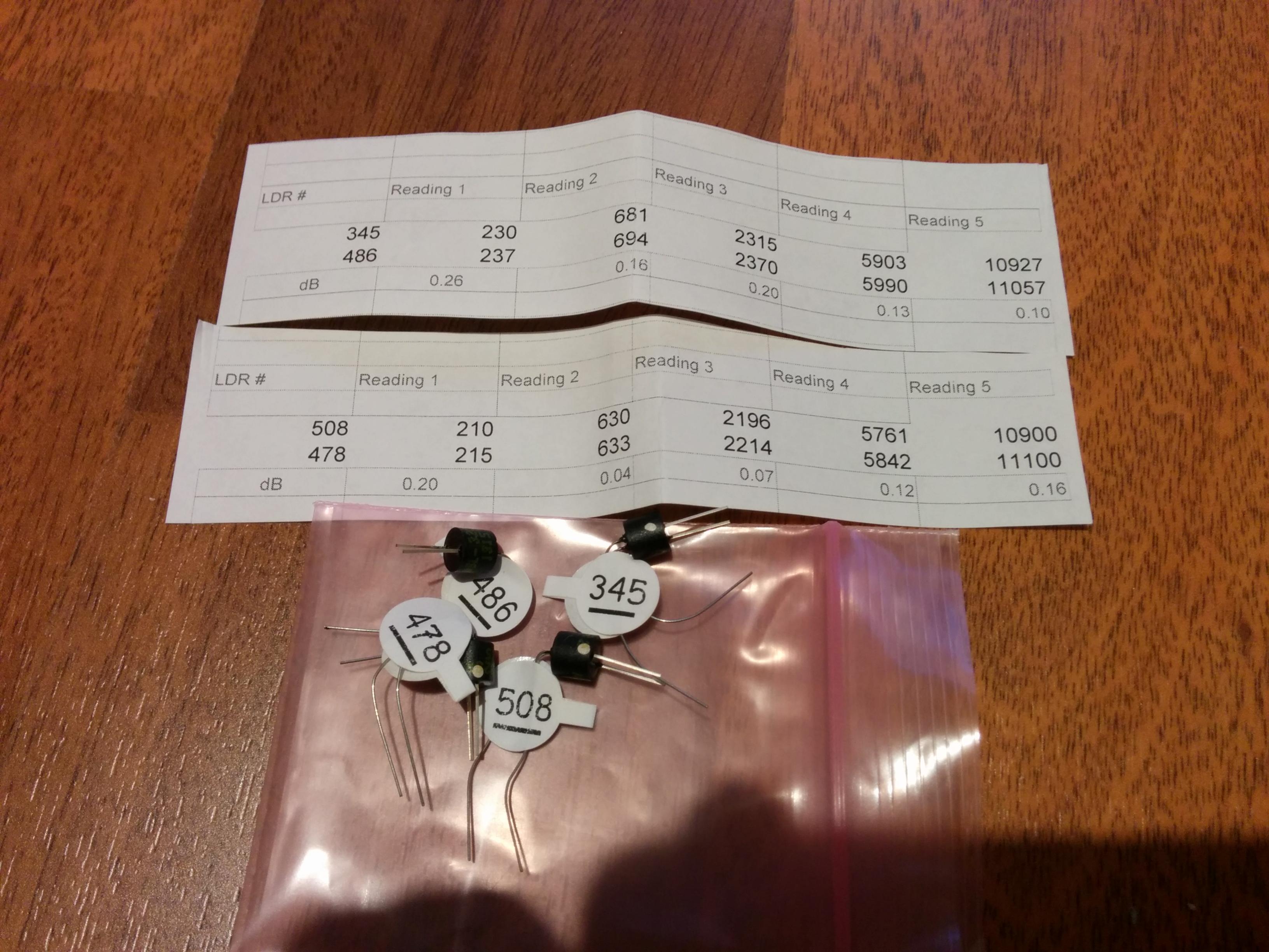

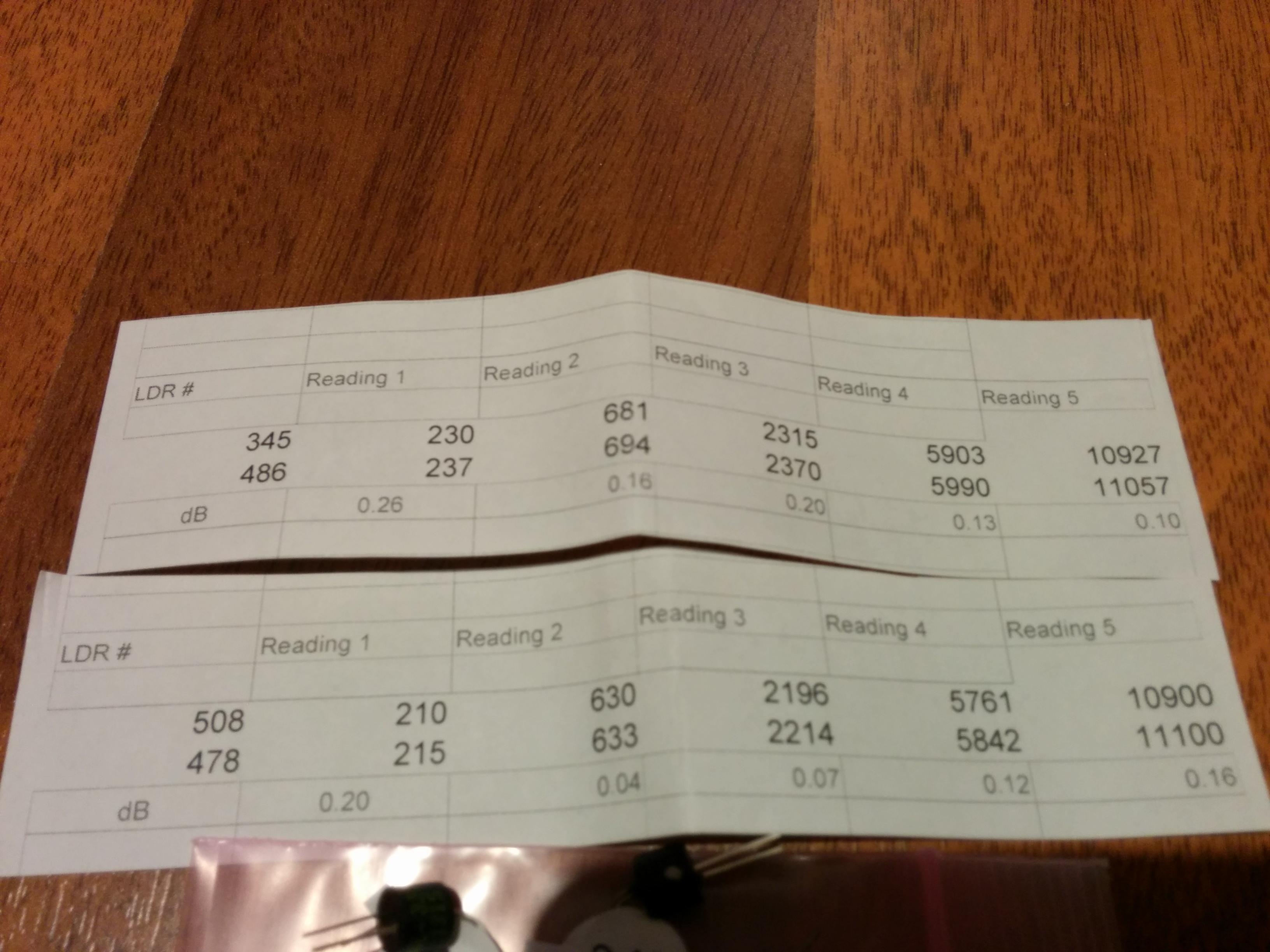

Hi there!
After long waiting I finally got all the electonic parts from reichelt. I read the emails and the instructions from rudi and there was mentioned a pair of the LDRs should be marked as "Series LDRs" and the other pair as " " .
But in the package of the mathced LDRs I do not have any pair marked as "Series LDRs" so I dont know which one to use as series and which one to use as shunt.
I attached 2 pics with the values measured. Could someone help me regarding this!? Don't want to do something wrong!!
Thank you in advance!
Greetings from germany
Ron
Ron
