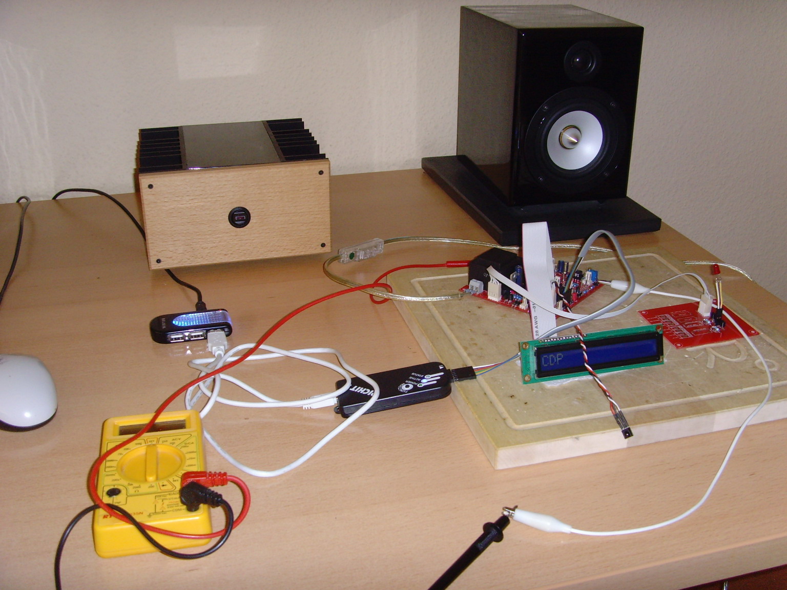

Gentlemen, I have finished the build of my VCPre, installed it into my test-rig and did some final tests.
Everything works as designed.
So I will start shipping your parcels tomorrow.
One reminder: the default names for the music-sources are "CDP, DAC and AUX".
If you want other names like "CDP, TUNER, Phono" (max. 5 chars) please tell me via PM.

Congrats! Looks really nice and great to hear everything works as designed! Is it safe to assume Reichelt BOM is still the same? Have two weeks off in two days, so I have something to do
Thanks for all your hard work!
Not to forget METAL, who programmed the base of the PIC µProcessor's firmware and Uriah, who matched the LDRs.
Best regards - Rudi_Ratlos

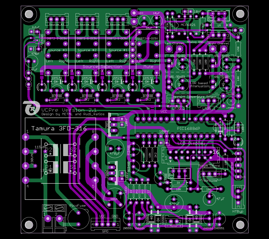

@Michael: the Version 2.1 PCB of the VCPre (the group-buy of which I will start next week) uses the TAMURA 3FD-316
transformer (see image attached).
This transformer can be used for both 115VAC and 230VAC mains. I will tell you in the VCPre Builder's guide, how to adapt
this transformer to your mains.

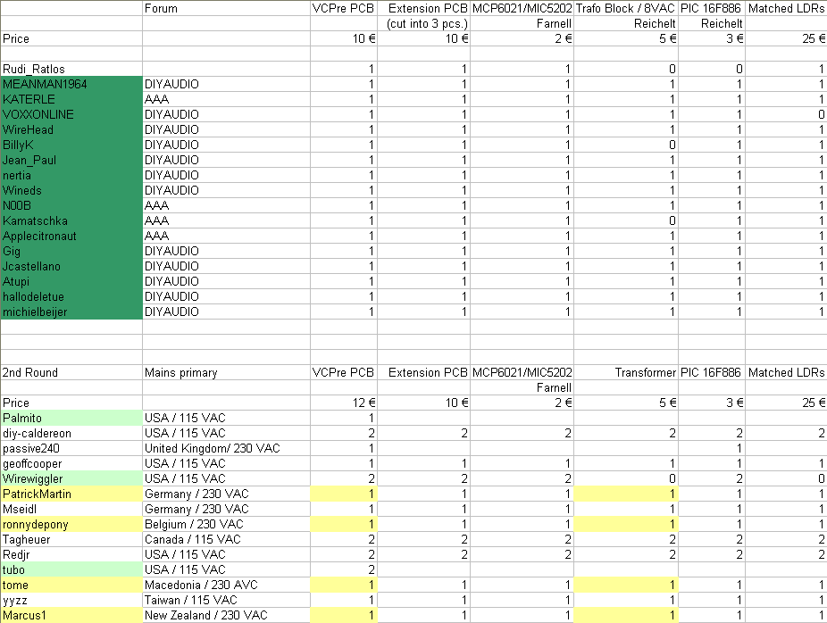

Gentlemen, all of the letters of Groupbuy-round #1 have been dispatched (coloured dark-green) and are on the way to you!
@PALMITO, TUBO, WIREWIGGLER: I have shifted you to round#2, since you wanted support for a 115VAC print-transformer definitely!
@PatrickMartin, Ronnydepony, tome, marcus1: I will give you the Round#1 PCBs with the excellent Block ECO S3,2 / 400 mA print-transformer!
Be sure: this transformer is not inserting any hum into the VCPre's circuit at all!
I am not sure about the TAMURA / 300 mA print-transformer, since I have never used it before.
But since Jean-Paul recommended it, ....
