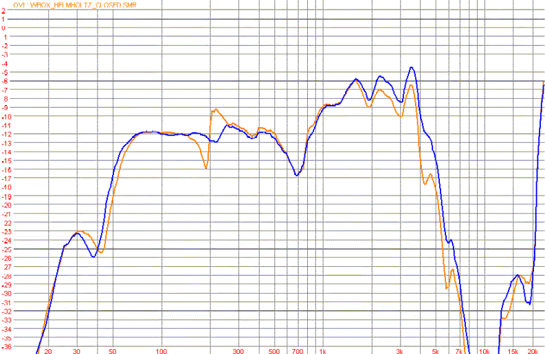

Congratualtions!! Even if you cannot get it down any farther, you have already gone a great deal toward suppressing the "spike".
It actually looks like a usable woofer curve the way it is. If we combine it with Andrew's advice and apread some stuffing around the middle, the "spike" will be reduced still further.
Of course, our aim is to attempt to see if we can suppress the "spike" compeletely through the Helmhotz resonator. However, even if we don't get any further than where we are, you have already shown a usable curve.
Now, one thing. Are you measuring just the woofer of your system, or the output of the whole system-woofer and port together?

kelticwizard said:Zozo:
No, this is just the woofer nearfield. I can take the port tube graph, but cannot do complex summing. It would be useful though ...
Tomorrow I'll try to add some more stuffing and see what happens. What would be the benefit of doubling the volume ? Lowering the Q ?

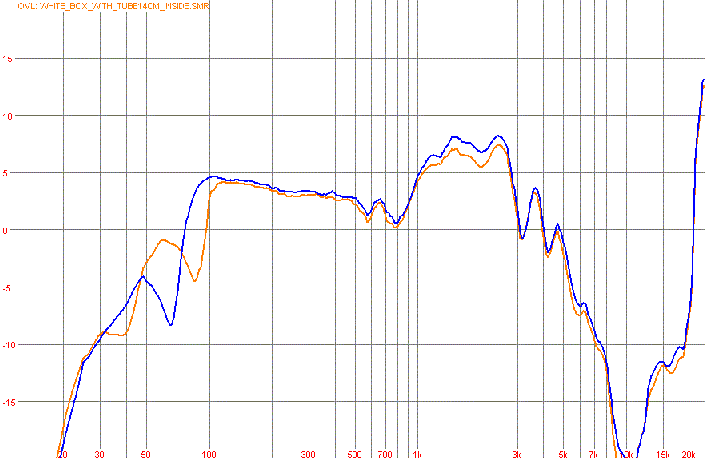

I can't help but note that Zozo's first curve, which was unsatisfactory, the two ports were strongly interacting. The tuning frequency of the overall box was affected. That is because Fb of the box was 40 and the Helmholtz Resonator was around 70 Hz-less than an octave apart.
Here is Aoao's first curve:
http://www.diyaudio.com/forums/attachment.php?attachmentid=8059
In Zozo's second curve, he tunes to around 200, and the Fb of the box-40 Hz, is almost unaffected. The closer Fb is to the Helmholtz Frequency, the more they affect each other. As the two frequencies move apart, the less they affect each other.
This has been noted before in the "6th order bandpass box", where the two chambers are tuned to different frequencies. The two frequencies must be at least an octave apart, preferably more, or bad things happen to the response.

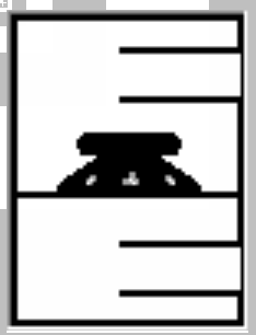

Here is an illustration of the 6th Order Bandpass Box. Despite the drawing, the two vents do pass through the wall of the enclosure and go all the way through to the outside of the box. The two chambers do not have to be equal size. As stated previously, tuning both chambers within an octave of each other usually yields uneven response:
With the possible interaction of the ports-decidedly lessened as the space between the tuning frequencies increases-we might wish to consider the idea that the Helmholtz Resonator might have a different tuning in a Vented Box from a Closed Box of equal volume. Just a guess. The farther apart the tuning of the Helmholtz Resonator is from Fb, the closer the tuning of the Vented Box will be to the Closed Box.

Kelticwizard & 7V,
Thanks for your positive comments and the help giving me. Here are my latest meas with some added stuffing. I think in this setup this is the best I can achive. As you can see the response is within +/- 1dB which is not bad at all.
I have added some more damping to the chamber, but it didn't helped to further reduce the ripple :
