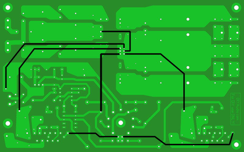

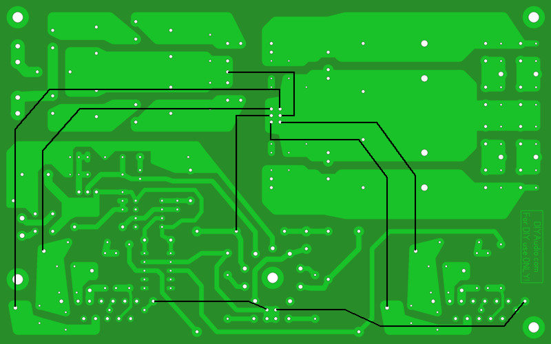

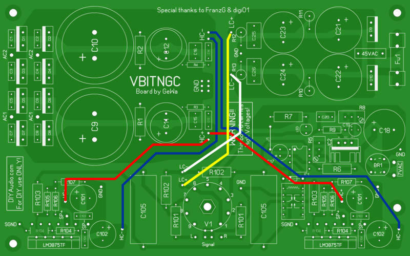

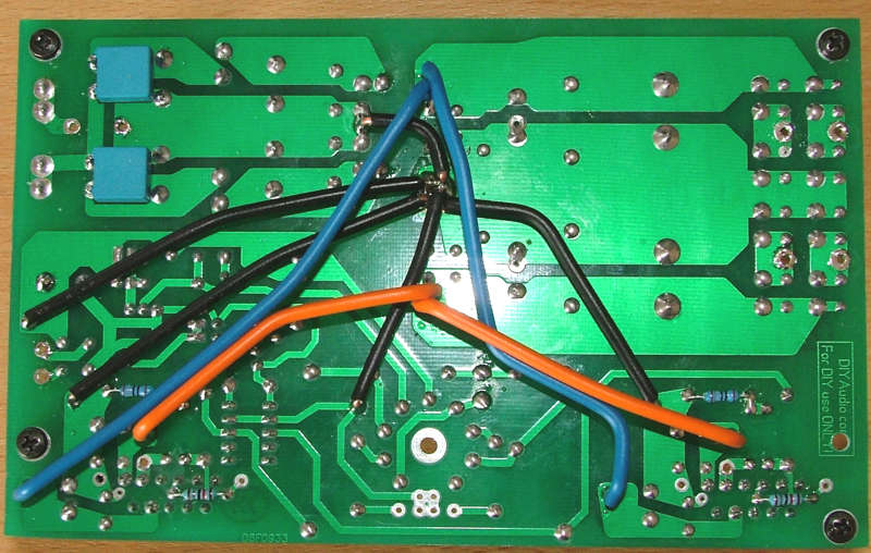

GeWa, do you mean that all the wires that you draw in your previous post have to be made with wire by hand? If so, good that this subject is on the forum. If not, i schould not know about it (the BOM do not speak about it too).
So for everyone who is going to build this amp, take good care off the photo from GeWa, a view posts ago.
Yes.
Also the HC and LC power supply has to be wired manualy. This is one of the disadvantages of a single layer board and the fact that it's only a euro card format (couldn't place the parts idealy). It all sounds a bit dramatically but it isn't. I will post a picture of how it all has to be wired.
Regards
Attached a picture so you can see how the power supply wires have to be connected. For those who are interested, I slapped a small 3 page manual together which includes a parts list and some images and explanation of how to wire the amp. If you want one just send me an email. (to big in size to post it here, 375kb)
