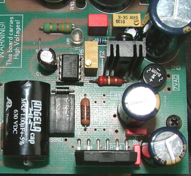

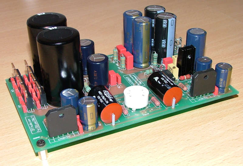

Good looking board!
I hope it will work good ...
My suggestion: put some isolation tube around the wires from the coupling caps, so they cannot touch the needed heathsink for the LM3875 chips.

No exotic components needed Loek, i have the tube for you for free (E88CC),. I build the earlyer version from Zang and Franz, with the boards with some bugs that had to be fixed. I love the sound and i am playing with this amp since he was ready. Very, very good. My friends do not beleve there eyes when they see the very tiny and little design.

I have 2 sets of the old boards that I do not have time to debug so I am certainly intrested in the new PCB so I can make a desk amp.

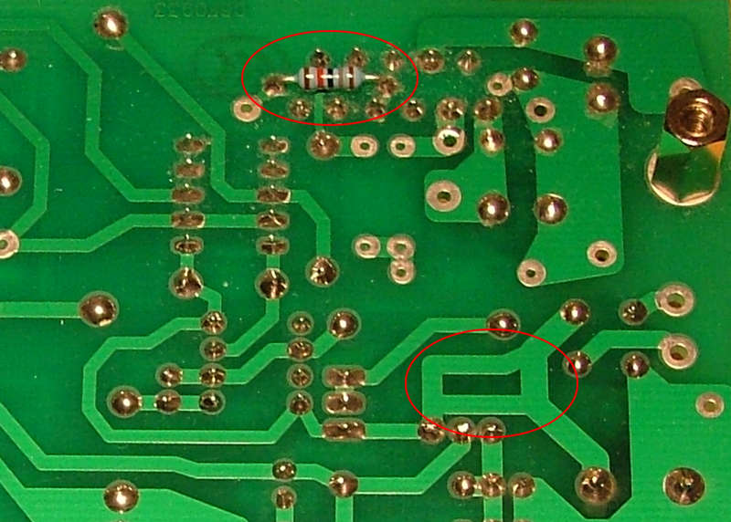

As far as it goes for "bugs", well there are a few. The small heater supply groundplane isn't according to my layout (it has only the outline). I also made a small mistake with the diameter of the electrolytic caps next to the LM chips, they still fit but it's all a bit tighter than planned. For the rest, I'll let you know when I fire up the thing.

Hi Wim
Wel there is actually nothing to fix. What should have been a small groundplane ended up as an outline only. The Gerber files I have sent to digi01 were correct so something happened during the manufacturing process, but as I said nothing to worry about. If one really wants than the soldermask can be carefully scraped away in that area, stick on a small piece of copperfoil and soldered around the edges. (a bit far fetched if you ask me)
Another detail is that R104 has to be soldered on the copper side.
The attached picture shows it all.
I will mail you the BOM right away.
