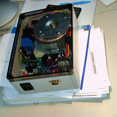

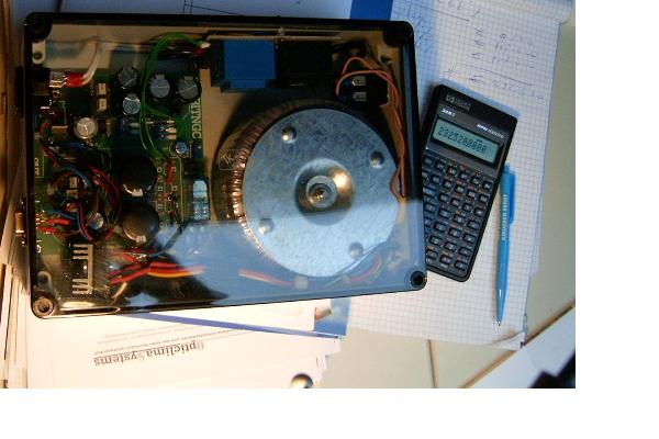

The 6.3V heater lines only give 3.8V when I actualy have the tube in there... this also causes the relay not to switch the amp part on...
If I pull out the tube the pins measure 6.3V and the relay swithces...
It is powered by a 7.2VAC 1.5VA transformer... only other things on the thransformer is 2 leds, the NE555 and a 5V relay.
Apart from this I should be done.
Need help... close to tears now.

Your trafo is way too small. 1.5 VA is close to nothing.... especially if you want to regulate.
You'd better use at least a >10VA trafo (the filament asks for about 300-350mA, plus you have the regulation losses and the relay consumption).
