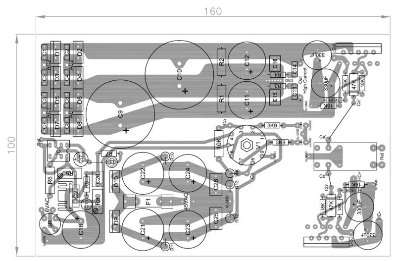

Do you mean it's better that all GND wires go to the ground plane of the 'high current" supply?
Like this?

Hmmmm...
Would it not be a good idea, to test the pcb in reality, before going in "production"?
I remember some experiences with group buy :rolleyes:
Will it work hum free? Do you find a suitable space for the coupling caps? Is it easy to attach all connections?
Just two cents.
Franz
/Edit: another cent: May I ask, why the high current traces are getting narrow at the end?
I suggest to make use of the available space and make this traces as large and as symmetrically as possible.
/Edit /Edit: maybe another good advice to print a high voltage warning on both sides, for this single board solution?
Would it not be a good idea, to test the pcb in reality, before going in "production"? I remember some experiences with group buy
I'm all for that! I offered to post or mail the pdf files if someone was willing to make a test PCB, but apparently there are no volunteers :xeye: . I don't have the equipment or knowledge to produce home made PCB's.
Hum free,..... don't know yet.
Plenty of room to hardwire the coupling caps.
As far as I'm concerned I don't see any problems with the connections.
On Zang's board they also got narrower towards the DB9 connector!?
Good idea, will do that. Safety first!
