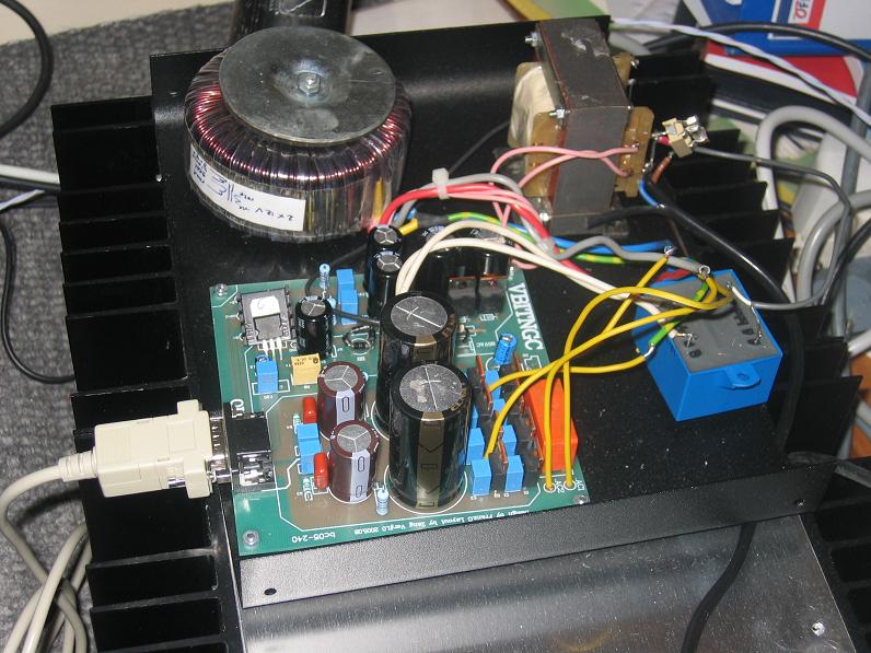

A picture of my fully operational power supply...
The ground wire between HV and HC GNDs helped, but it is not silent as my alephs yet. But good enough anywayz. The supply is not optimal yet as you can see, I do not think my insurance will cover this thing
Anywho, I hope the workshop will re-open soon

Nice Photo of your PSU PCB Hanzwillem, looks good. Is that small heatsink for the 317 regulator enough?
