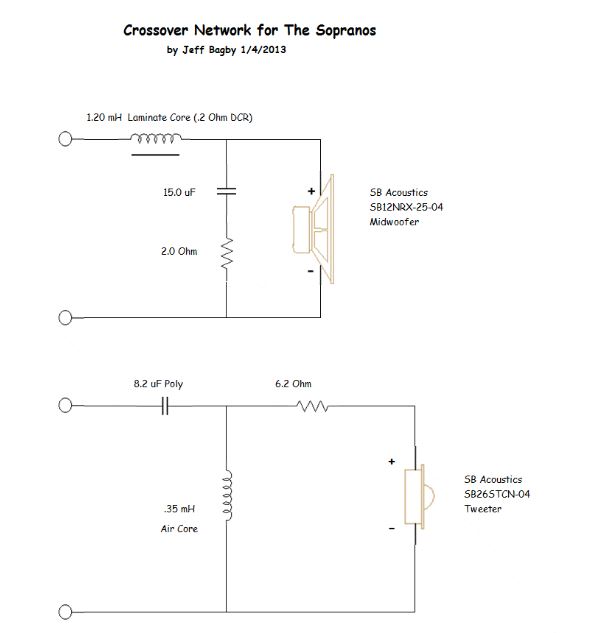

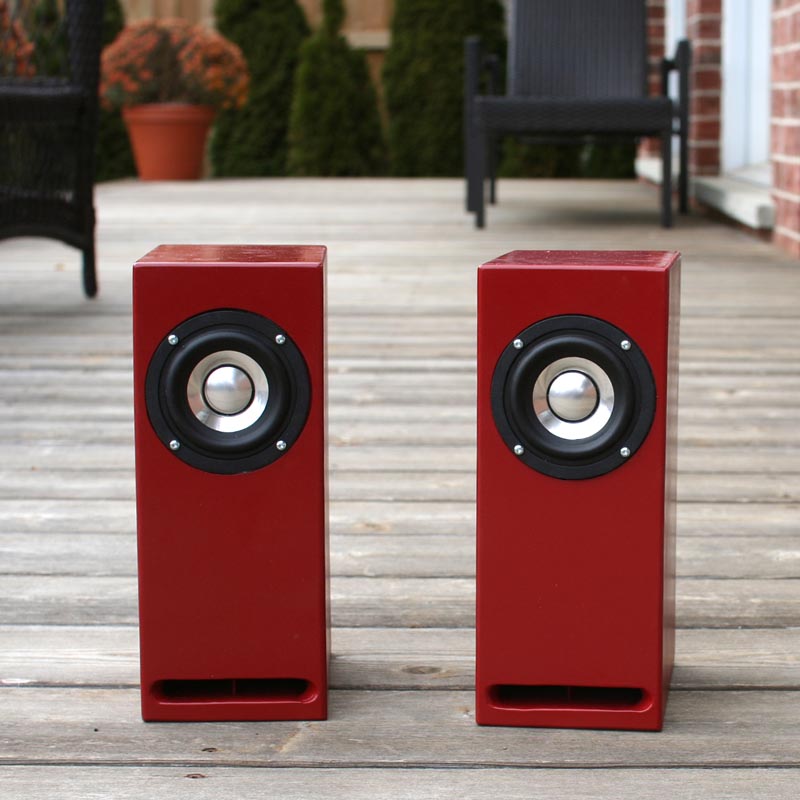

Low cost small 4" 2-way SB Acoustics (Soprano by Jeff Bagby)
To kick off this thread I'm suggesting a small 2-way vented design by Jeff Bagby. Works well in small to medium rooms and great for HT use with a subwoofer. A great speaker for an introduction into the hobby with a good bang for buck as well as plenty of uses.
This is 1 of 2 loudspeakers that I've built from another designer (as a sanity check) and it's a keeper. My enclosure is slightly different and the crossover had a small change with the 15uF cap changed to 6.8uF to make the mids a bit more forward to suit my equipment, room and tastes.
Tweeter SB26STCN-C000-4
Midwoofer SB12NRX25-4
4.7 litres vented
F3=59Hz, F6=53Hz, D35x104 port
4 ohm speaker
Crossover 2 caps, 2 inductors, 2 resistors

The Sopranos is an excellent little design, IMO.
Two flattish drivers and low inductance on the bass making filtering easy.
4” SB12NRX25-4 :: SB Acoustics
SB26STCN-C000-4 :: SB Acoustics
I include the simple Jeff Bagby Sopranos crossover, first below.

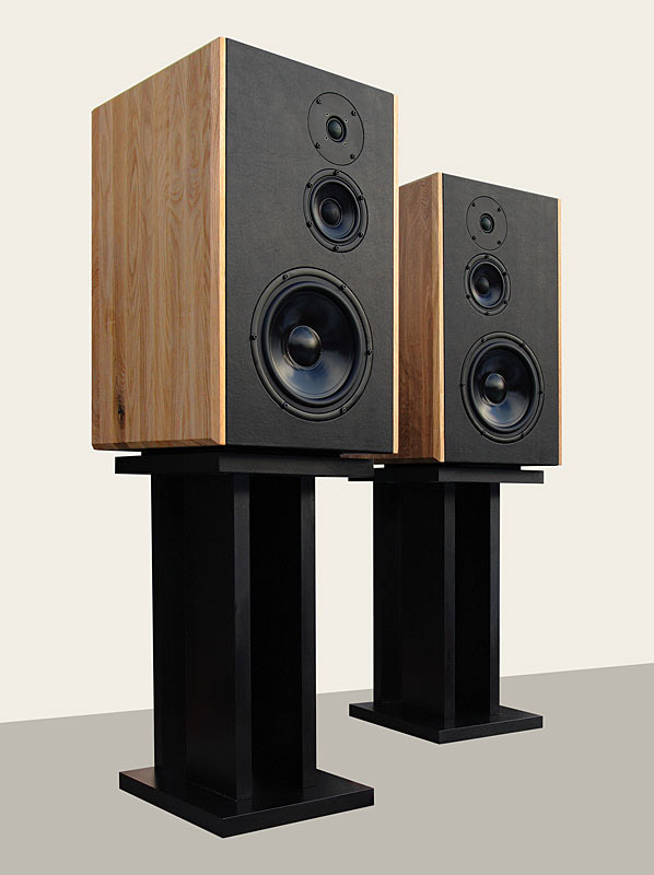

3-Way Classic (SEAS) by Troelsgravesen
There are a lot of older members who will remember 3-Way bookshelf speakers from the 1970s such as the JBL L100 and Yamaha NS-1000M.
This 3-Way Classic captures the essence of this era and has had plenty of favourable mentions in this forum so deserves a place here.
Tweeter SEAS 27TFFC
Mid SEAS MCA12RC
Woofer SEAS CA22RNX
37 litres with F3=43Hz
90dB SPL 2.8V
Since there is no pdf, a link is provided and hope it stays alive for years to come.
SEAS-3-Way-Classic
The designer makes a note about not using a stand with a front panel which also indicates it's not designed for a floorstander.
There are later versions but these do not show crossover values but can be bought as a kit.
