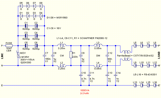

Hi
Few years ago I built and still use DC Filter + RFI/EMI Filter found somewhere in internet. Here is the schematic:
- diodes STTA1206
- elcaps 22000μF/16V BC Components
- film caps X1, X2, Y2 Evox Rifa
- varistor S20K300
- chokes RN222-4/02 4A/250V, RN112-4/02 4A/250V Schaffner
- resistors 3W

Oooo... you just don't *happen* to have pcb drawing as a file, or as black/white image such that one can print and etch some boards oneself?
The grateful (greedy) Olle :p
EDIT:
Or even better: it seems that pre-built EMI filters are abdunant, but does someone know a decent DC filter buyable through say mouser?
