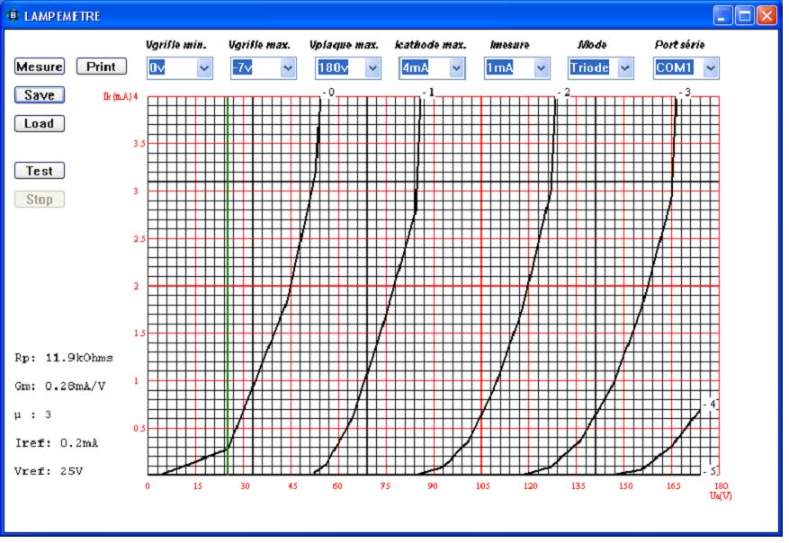

Here is the Triode Connected plot with Va and Ia limited so you can see the 0ma axis better.
I think if anything my Vos is such that it has shifted the plot down and I need to bias mine opposite what you did.
I still don't see how to force the "Imeasure" value to get the bias point where I want it. Int his plot where I wanted to see it biased at 1mA and 150V it went off the left of the 0V grid line where it would require positive grid voltage to get to 1mA of current.

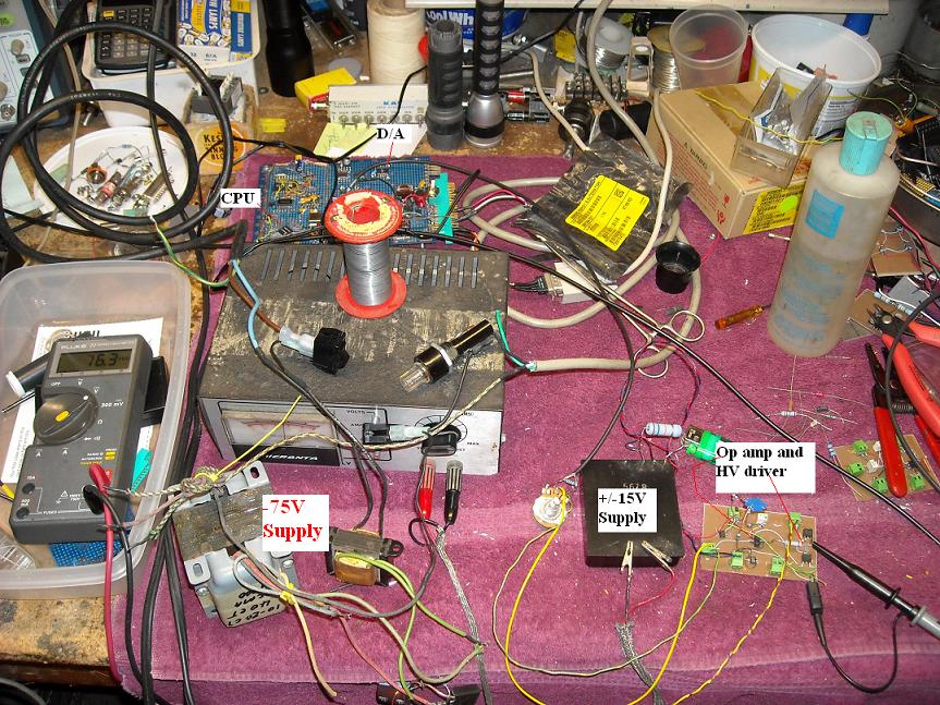

I've been working on my design again. I have an 89C51 running with a couple of D/A converters on a prototype board. It is driving a small board with the level translator for drive the grid. I've got it set for about -64V max, although it would be simple to change it to 0-128V by simply changing the power supply and adjusting the gain.
Code is done for 0-511V for the anode drive (511 steps), and 0-32 steps for the grid drive. Two channels of D/A (12 bit) and four channels of A/D (10 bit) update in 150us per grid step, with 511 anode steps per grid step.
Next I'll test the anode drive(although it is the same as the grid except it uses N-FETs instead of P-FETs) to generate positive drive vs negative for the grid so I'm sure it will work.
It is a bit noisy as it is on breadboard.
Once I have the anode drive tested I'll start working on the computer interface. Probably in Visual C++, although I've been told the learning curve is a bit steep compared to Visual Basic.
This will probably end up a long term project.
HV anode drive works.
I guess the hardware feasibility study can be considered a success. So much for the easy part.
