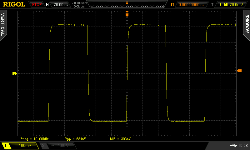

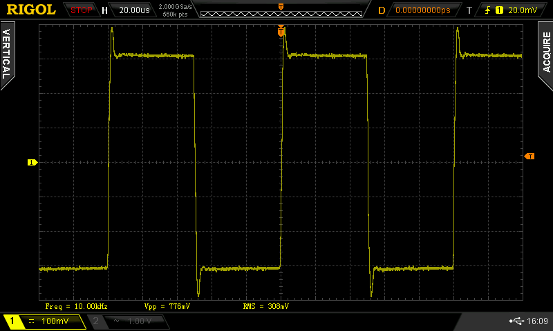

BTW the Jensen JT44 at 10KHZ square before and after Zobel termination on its secondary.

6K8 + 200pF dulled the leading edge too much for me. I ended at 100pF polystyrene for the picture I posted. But this is a test with longer cables so its possible to be optimized at 130-150pF in a build. And there is ear check in the end for each one's cart and phono.
