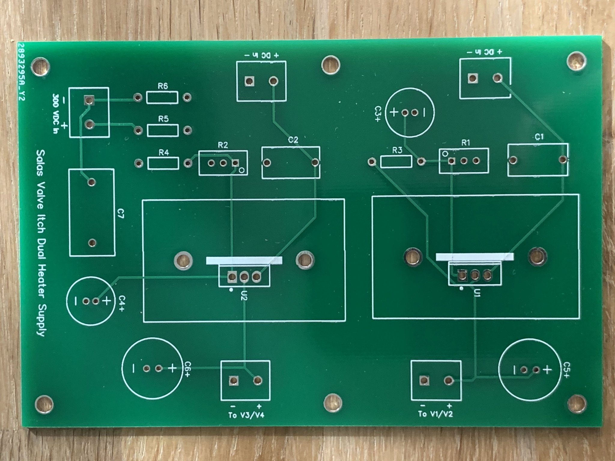

Hi Merlin . Thats all I have , the rectifier has AC heaters and the rest are DC . You have to lift all the heaters to keep within tube specs . The output changed to single 10 ohm and 2 x 47 mf caps see the picture . the whole design is a standard schematic that i adjusted to suit tubes and parts used . I am just a hobbyist and I leave the real work to people like Salas .

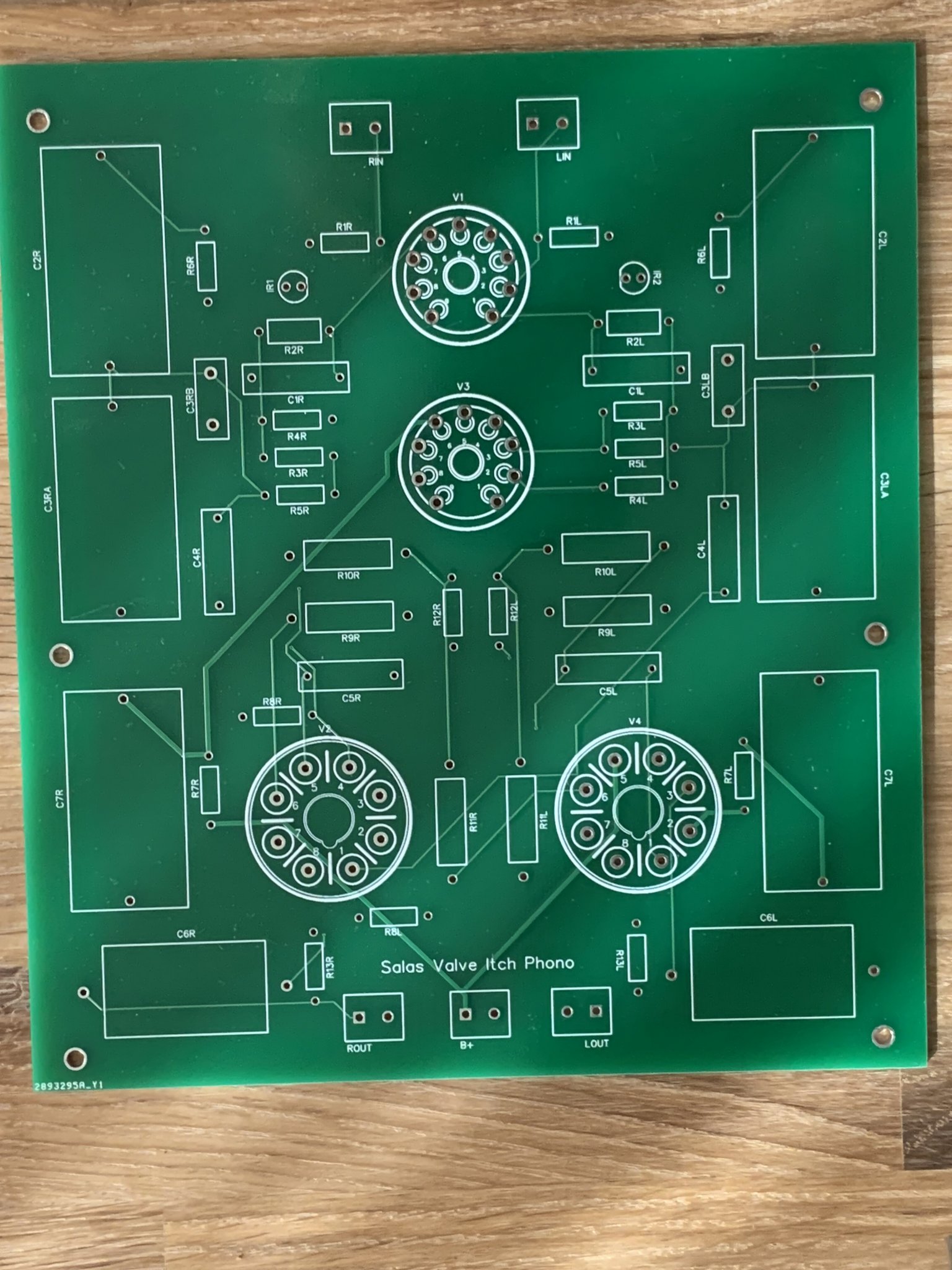

If someone from RU wants to build a pre-amp, I have spare boards left.

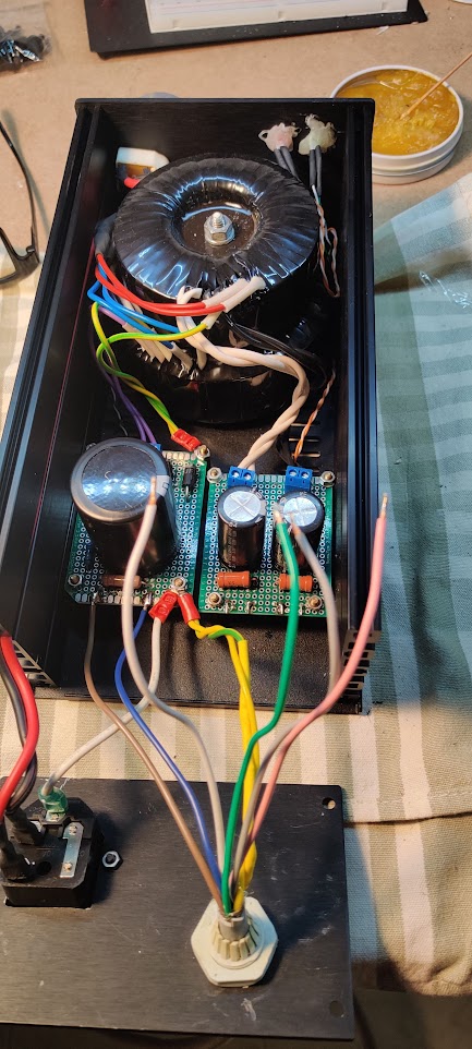

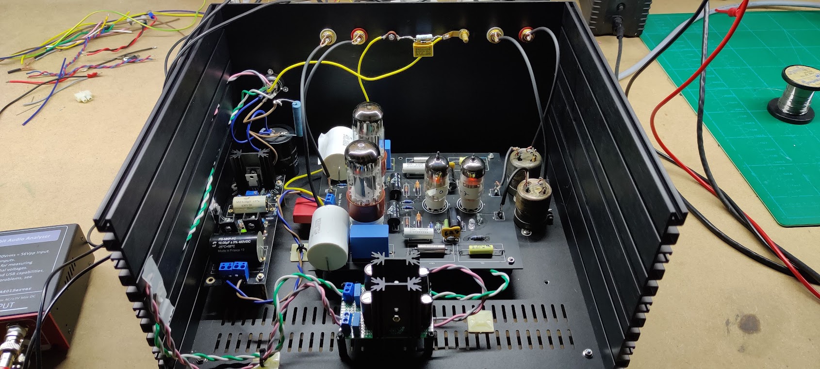

Another valve itch finished. Total gain about 56dB with Partridge transformers.
Extremely quiet for a tube phono. Very nice, detailed and warm sound. I have also ordered some Sowters input transformers, which should give me more gain and of course reduce hiss even more. Not as high resolution as my UFSP but close. Very addictive listening to it!
