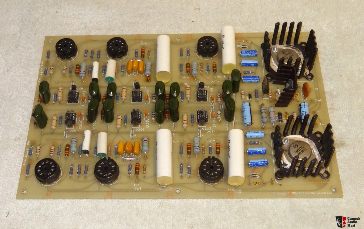

The Daniel preamp was published by Curcio in the Audio Amateur years ago. It used 6DJ8s in a cascode configuration driving a passive EQ network.
The loading of the network is not of great consequence. This is because the EQ network has a series resistor of fairly high value as an input to the rest of the network.

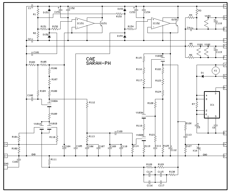

ah, I was a bit hasty, it turns out that there is in fact a successor to the Daniel that retains the all-tube spirit of adventure. The reason I missed it was that it's called 'Sarah'.
CURCIO AUDIO: SARAH - VACUUM TUBE PHONO PREAMPLIFIER

That was my thought as well. Interesting that in the Sarah, they took the same approach we did- paralleling the bottom tubes in the cascode so as to more easily drive the top tube. I found that was a good solution to noise and gain issues. But we did everything differential and so got rid of a bit of noise and improved power supply immunity as a result.
A bit of a side issue is that nearly all cartridges (and arms) are balanced sources anyway so we also use an XLR input.
