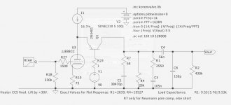

That was my thought as well. Interesting that in the Sarah, they took the same approach we did- paralleling the bottom tubes in the cascode so as to more easily drive the top tube. I found that was a good solution to noise and gain issues. But we did everything differential and so got rid of a bit of noise and improved power supply immunity as a result.
A bit of a side issue is that nearly all cartridges (and arms) are balanced sources anyway so we also use an XLR input.
Cascode is extremely useful in building networks with unusual frequency responses as its output impedance is precisely the load of the upper device.

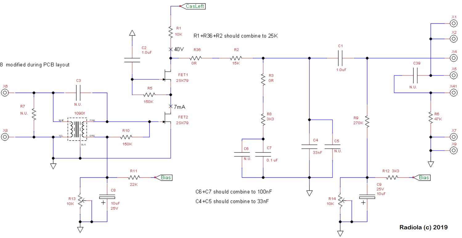

Here is the example of the MM project I am currently working on, it has been fully prototyped and it set the bar for the quality of a phono preamp for me at a new hight. Using Lipschitz RC correction circuit it produces 0.2dB max deviation in full audio range. Output stage is also a powerful SIT with a choke load.
any update for 2SK79 sit phono preamp.I have found some pair of the 2sk79 and also plan to use it for the riaa
