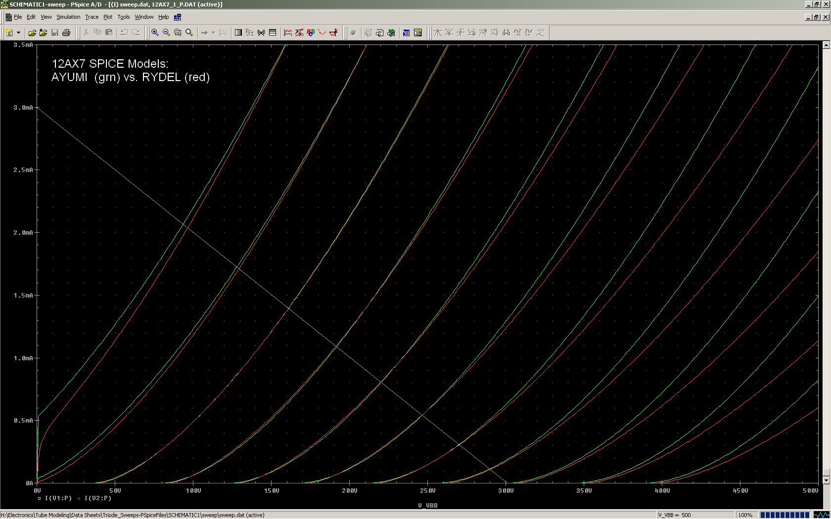

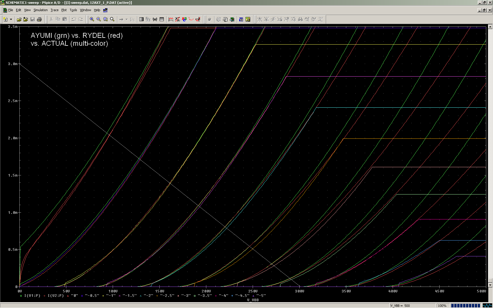

In case anyone is interested, here is a comparison of Ayumi's vs. Rydel's (created by Wayne using Curvecaptor) plate curves for the 12AX7. First is direct comparison between the two, then with the actual curves taken from the GE datasheet.
Ayumi's Vg=0V trace goes a little off.

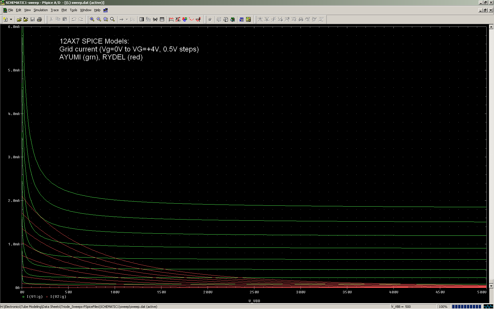

Next I'm going to compare the Ig models from Ayumi and Rydel.

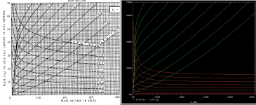

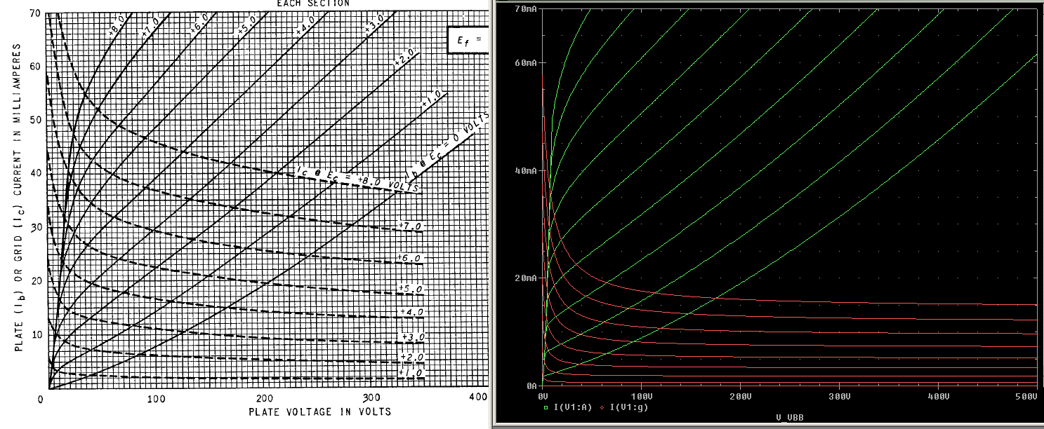

For those that may be interested, here is a comparison of Ayumi's 12AT7 model with the GE data sheet (sorry I don't have ripped data yet), in the overdrive regime (Vg=0V to Vg=+8V).
The plate curves don't appear to be terribly accurate. The grid current is quite a bit off. A good starting point perhaps.

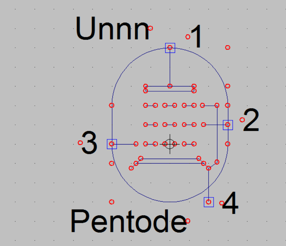

Do SPICEy pentodes really have 4 pins?
I tried to go through the (as of today) 122 pages of http://www.diyaudio.com/forums/tubes-valves/243950-vacuum-tube-spice-models.html for a model of an EL91. I've come across the Koren model, but I want to make sure that I'm not making a gross error. Most pentode SPICE models have 4 connections, rather than 5. So In LTSpice, it would look like this:-
attachment.php
It works in a simulation, but why do we not just use the proper pentode schematic image that comes supplied? I know that typically a grid is shorted out, but that seems like confusing the details. Is this one of my fundamental misunderstandings again :confused: ?
PS. Are there any alternative (better) models than Koren? Ayumi doesn't have it.

.SUBCKT EF91 1 2 3 4 ; A G2 G1 C (Pentode)
Open Pentode.asy file edit the pin number as above (and attached) and save as say Pentode3.asy, it should work. Each time you run into similar problem always check first if pin is mismatched with model. Paint a new model if you want, using model paint tool from Model Paint Tools: Trace Tube Parameters over Plate Curves, Interactively
Some datasheets do not show screen current so you cannot sim correctly for the screen parameter with model painted as such. EF91 is same as 6AM6.
