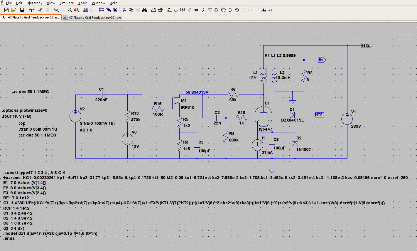

Thanks jazbo8 and jackinnj. The tetrode pins i use is A S G K, in that order.
I took a second look at the model and changed R1 value and D3 pins. It works and at least screen current at idle is close to the the datasheet now.

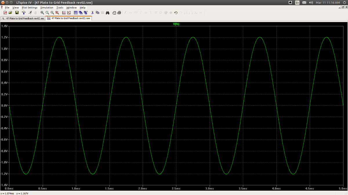

@ballpencil, I've tinkered with your sim in LTspice. I've edited your 47 model as there were a few inconsistencies. I've simplified the diode model from the control grid to the cathode. Also in the sim I've added a reversed biased diode across the current source to aid in convergence. Below I've attached the edited model, a LTspice file and two screen shots. Be aware that I'm not firing on all cylinders today, so I might have made a goof or two. :D
Code:
.subckt type47 1 2 3 4 ; A S G K
+params: KG1=0.00230261 kp1=-6.471 kp2=31.77 kp3=-5.93e-6 kp4=0.1736 kt1=50 kt2=0.08 kc1=6.721e-4 kc2=7.588e-2 kc3=1.708 ks1=3.462e-6 ks2=3.451e-4 ks3=-1.169e-2 kcs=0.09196 ecref=0 esref=250
E1  7 0 Value={V(1,4)}
E2  8 0 Value={V(3,4)}
E3  9 0 Value={V(2,4)}
RE1 7 0 1e12
G1  1 4 VALUE={(KG1*V(7)+((kp1/(kp2+v(7))+(kp3*v(7))+kp4)-KG1*V(7))/(1+EXP((KT1-V(7))*KT2)))*((kc1*V(8)**2)+kc2*v(8)+kc3)*((ks1*V(9 )**2)+ks2*v(9)+ks3)*(1/(1-kcs*(V(8)-ecref)*(1-V(9)/esref)))}
RCP 1 4 1e12
C1  3 4 2.4e-12
C2  1 4 3.9e-12
C3  1 3 0.7e-12
d3  3 4 dx1
.model dx1 d(is=1n rs=2k cjo=0.1p N=1.5 tt=1n)
.ends
  • 47 Plate to Grid Feedback rev02.asc
