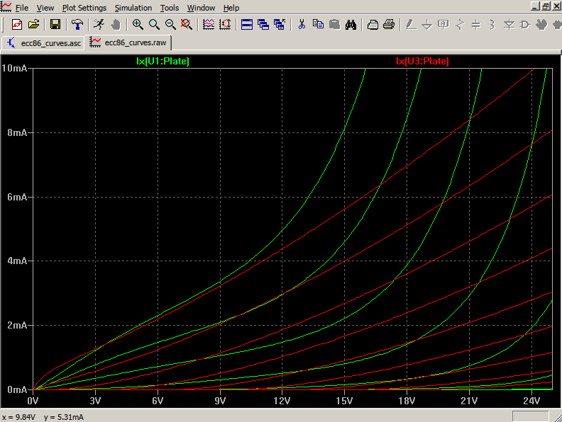

That model is way off from the data sheet. Looks a little "out there".

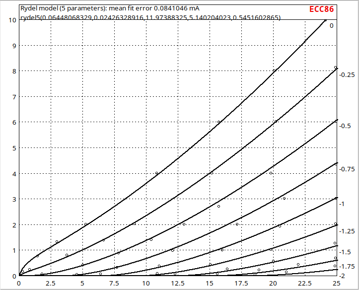

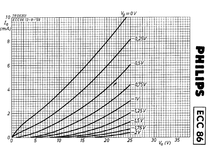

Here's an ECC86 model I just made from the Philips data sheet:
Code:
* ECC86 LTSpice model
* Rydel model (5 parameters) mean fit error 0.0841046mA
* Traced by Wayne Clay on 03/31/2021 using Curve Captor v0.9.1
* and Engauge Digitizer from Philips datasheet.
.subckt ECC86  P G K
    Bp  P K  I=((0.06448068329m)+(0.02426328916m)*V(G,K))*uramp((11.97388325)*V(G,K)+V(P,K)+(5.140204023))**1.5 * V(P,K)/(V(P,K)+(0.5451602865))
    Cgp G P 2.0p ; 0.7p added (1.3p)
    Cgk G K 3.7p ; 0.7p added (3.0p)
    Cpk P K 2.0p ; 0.2p added (1.8p)
    Rpk P K 1.0G ; to avoid floating nodes
    d3  G K dx1
.model dx1 d(is=1n rs=2k cjo=1pf N=1.5 tt=1n)
.ends ECC86
Also I've included a screenie of the comparison of my ECC86 model and the ecc86_krn model you posted in LTspice and my model in Curve Captor. And yes... it's a Rydel model. Sometimes a Koren model doesn't do a good job of modeling that little offset near 0Vg. ;)

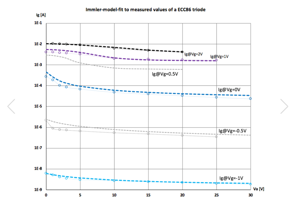

Hi all
Please note that the ECC86's gridcurrent-free headroom is super small. You have to stay below -0.75V gridvoltage. At -0.5V or more positive, you will have a no longer ignorable gridcurrent which causes significant voltage drop across a 1Meg grid resistor. See my measurements attached.
Note that most ECC86 spice models have a poor grid current quality which may let you trust in simulation results that are not possible in reality...
all the best, Adrian
PS: This tube was intended for high frequency stages in 12V powered car radios - such circuits had no need for a large headroom ;)
Hi all

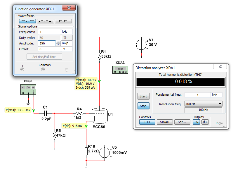

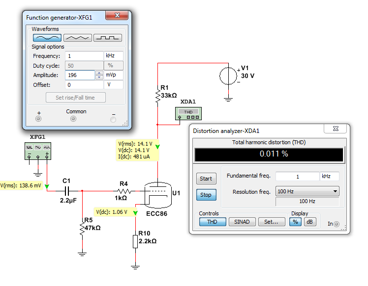

Thanks.
@Adrian Immler
Can you give an example of a ECC86 circuit that is acceptable?
And one that will not work?
I have 5 ECC86 tubes.
I want to use 30 Volt supply.
Hi lineup
With the small signal amplitude you use and a bias of -1V, the results are ok.

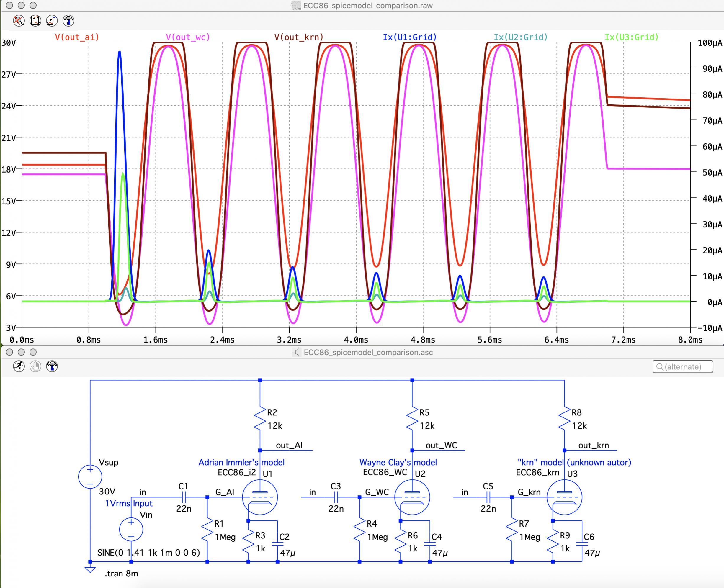

Here is the promised ECC86 model comparison. I used a 1Vrms signal. At this level, the models differ much. Please note:
1) The Wayne Clay (cogsncogs) model tells you a more or less undistorted output signal. The grid just starts to rectify a bit. But reality is much more worse.
2) There will be strong bias shifting because of the grid acting as a rectifier
3) The krn model shows this effect also, but not as strong as a real tube will do.
4) The krn model shows too hard clipping. A real tube clips much softer.
5) Wayne Clay and krn model deliver a too big amplitude of the output signal
regards, Adrian
... at 0.4Vrms Input signal, the rectifying effect just starts. Below that value, all 3 models delivers similar anode bias voltages. The krn model has a too big gain.
How ever, for your small signal levels, cogsncogs model is ok.
Happy Easter!
cheers, Adrian
