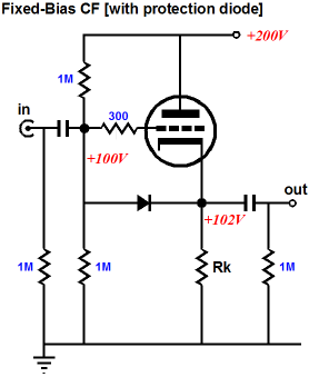

A standard diode would be better 1N4007 has been used in the past..
1n4148..etc

Resistor failure probably to low voltage rating.
