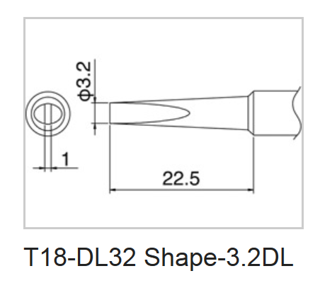

I bought some 3.2mm wide chisel-tips for heating up fat 5mm desoldering braid (Pro wick #6), to work on a PSU board that uses rectifier diodes in the massive R6 package. I find these tips work well both for soldering and desoldering, of huge diodes attached to whomping fat traces. Mine's the Hakko T18-D32.
