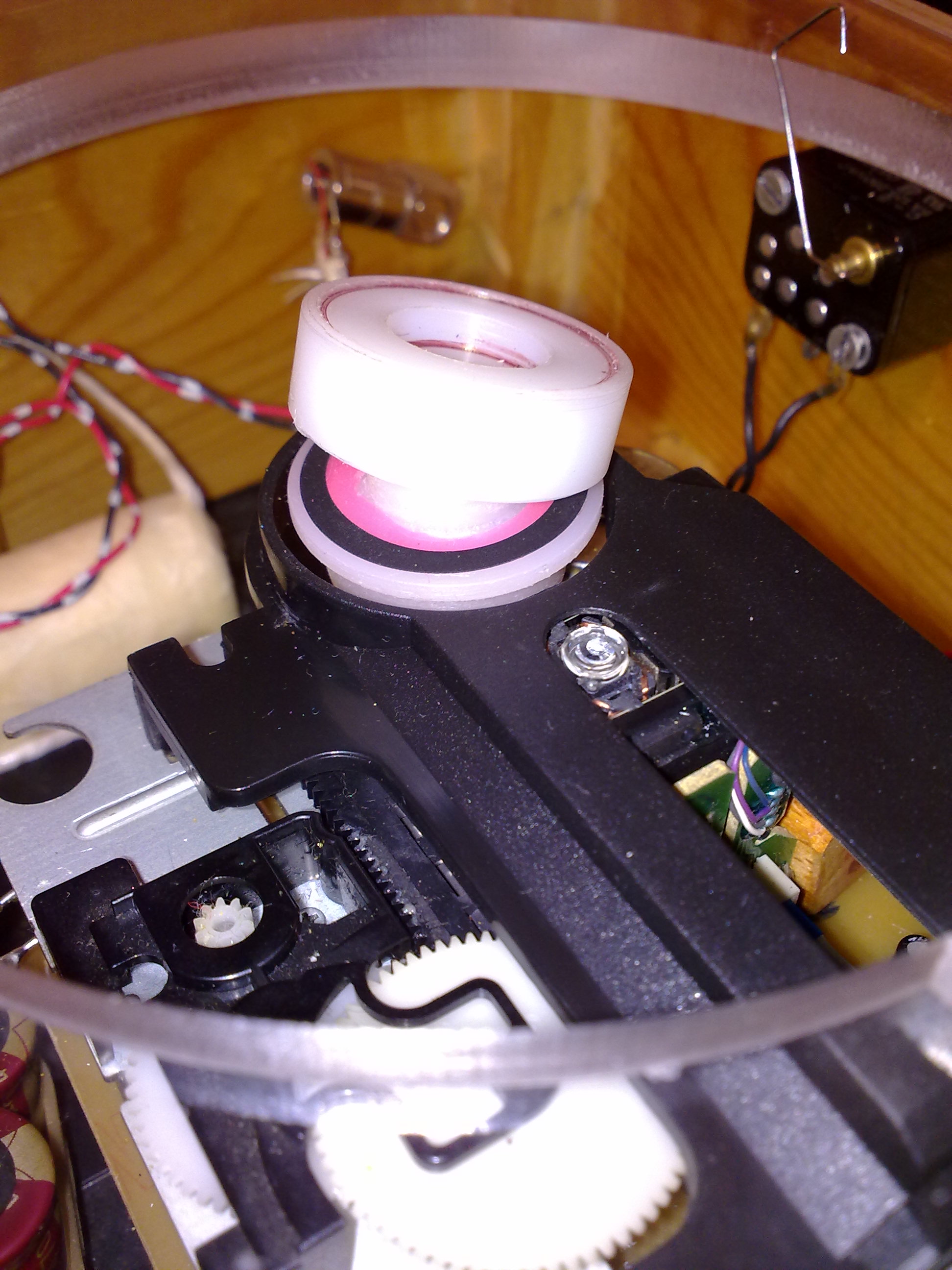

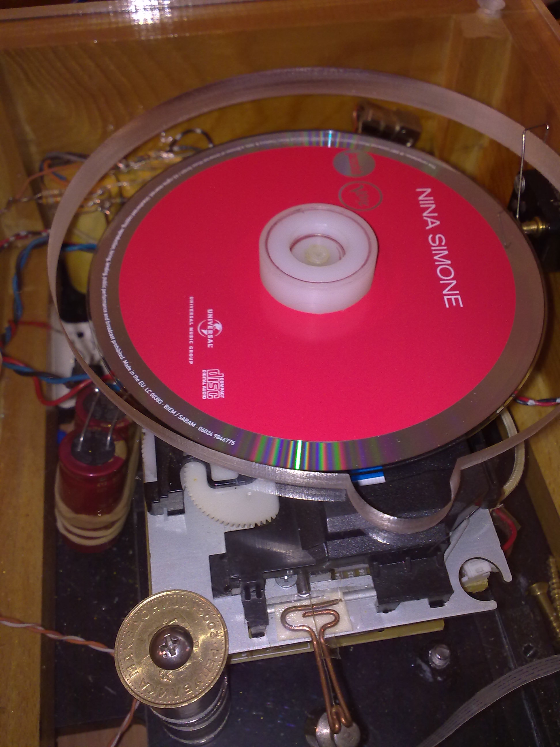

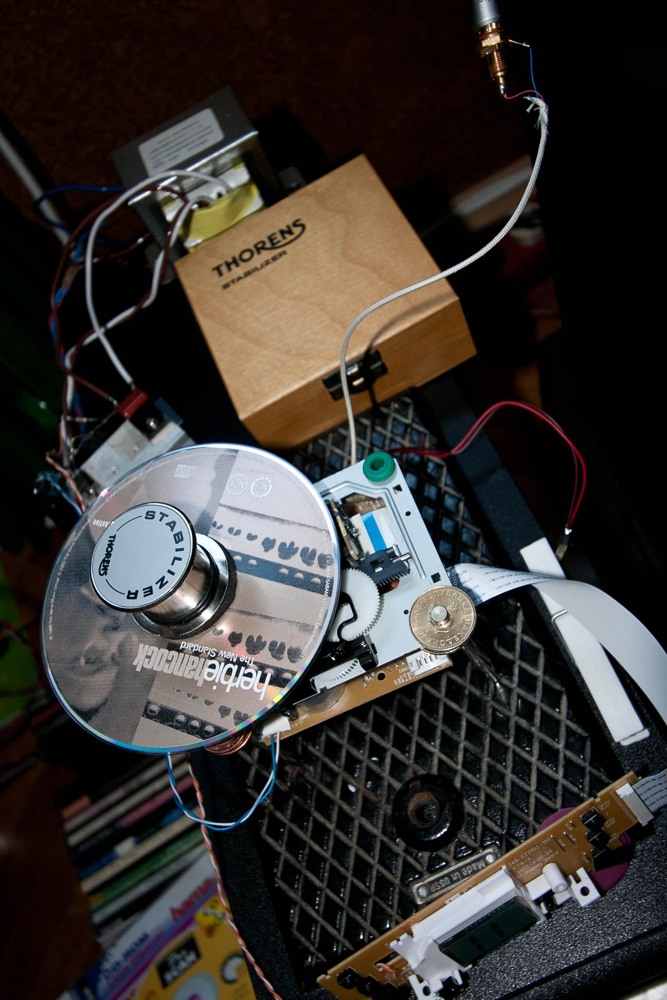

Hi All
I am a little confuse regarding PUCK???
As I learn from tread "Finally, an affordable CD Transport: the Shigaclone story" the best puck is Light puck... from ebony, aluminium...
I also try magnetic original... heavy from brass... and light from nylon... And for all that i fine nylon a best solution see the picture.
Any explanations or confirmation ???
Regards
Cici
I see two possible approaches to the puck. (1) as light as possible to minimize imbalance. (2) heavy within the limits of loading the motor so as to stabilize imbalance due to eccentricity of the CD itself.
Considering the weight of the CD and the fact that it's weight extends much further out than the puck, I believe light is the best way to go.
In addition, a heavy puck will load the motor more, although it might help with minimizing rotational variation.

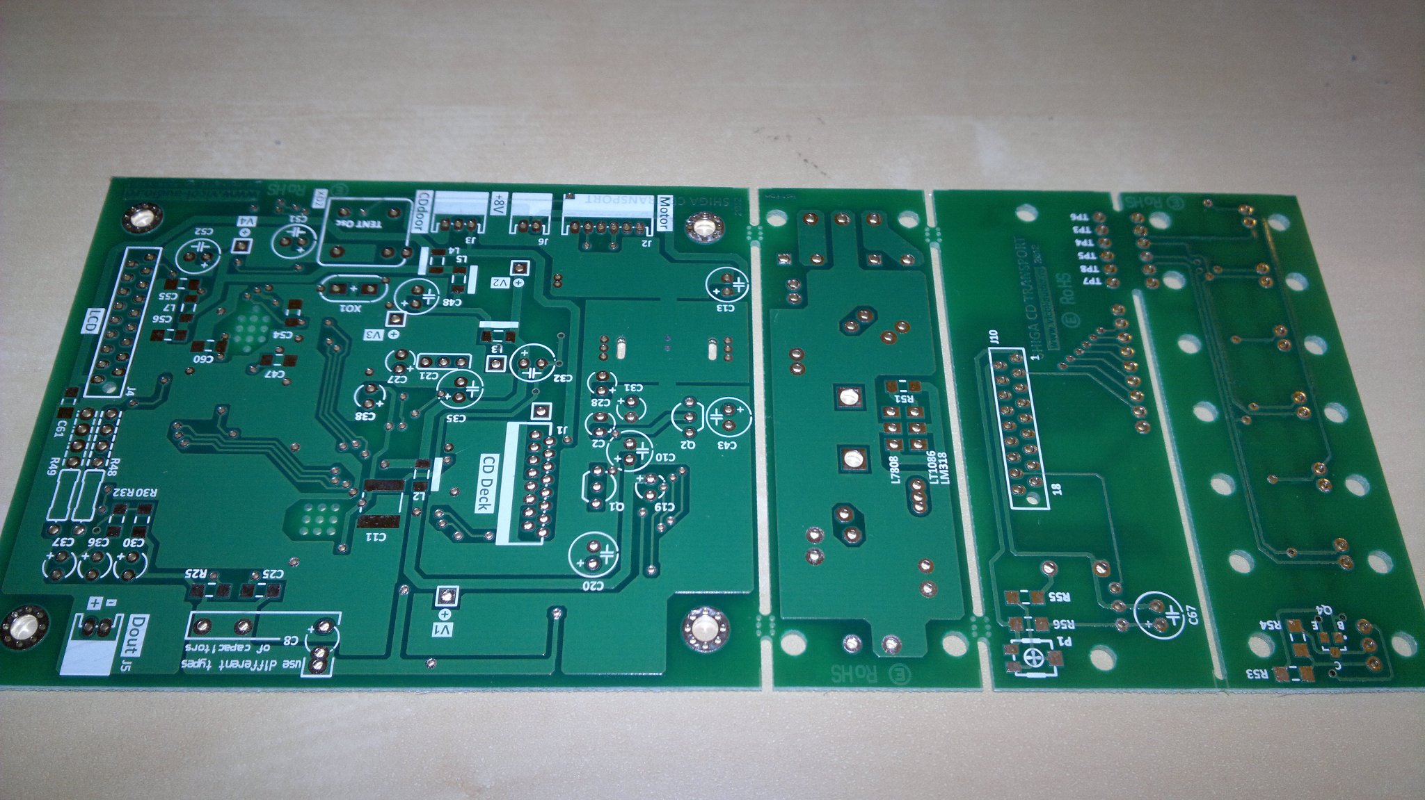

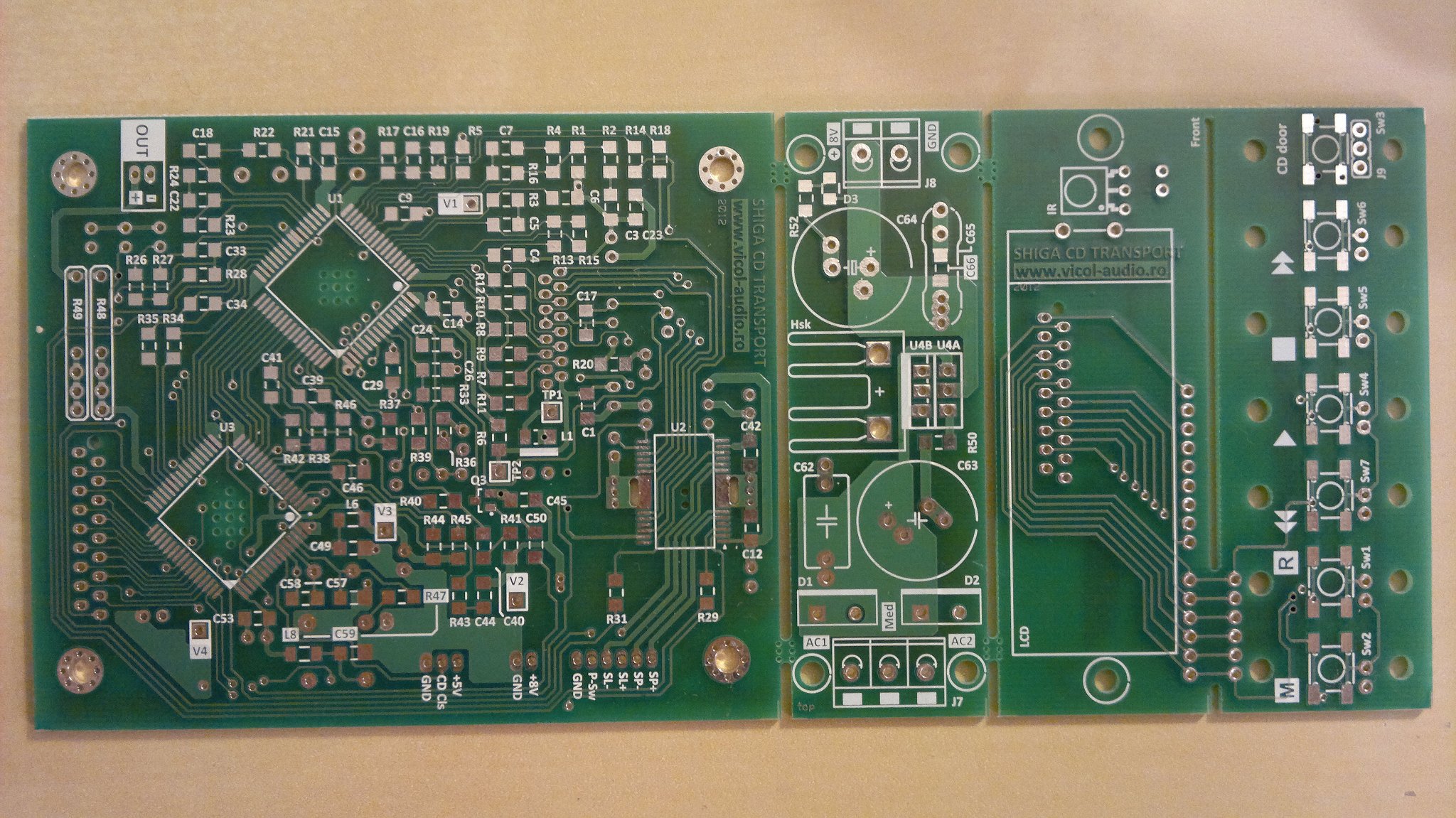

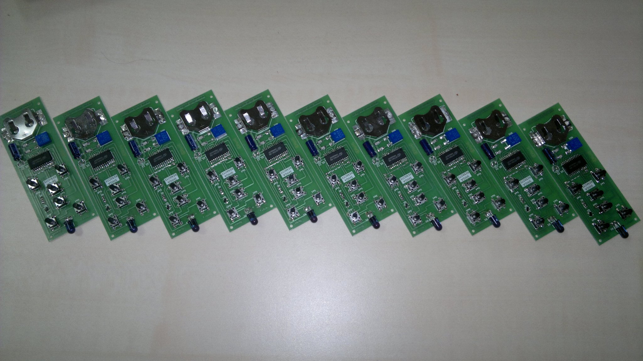

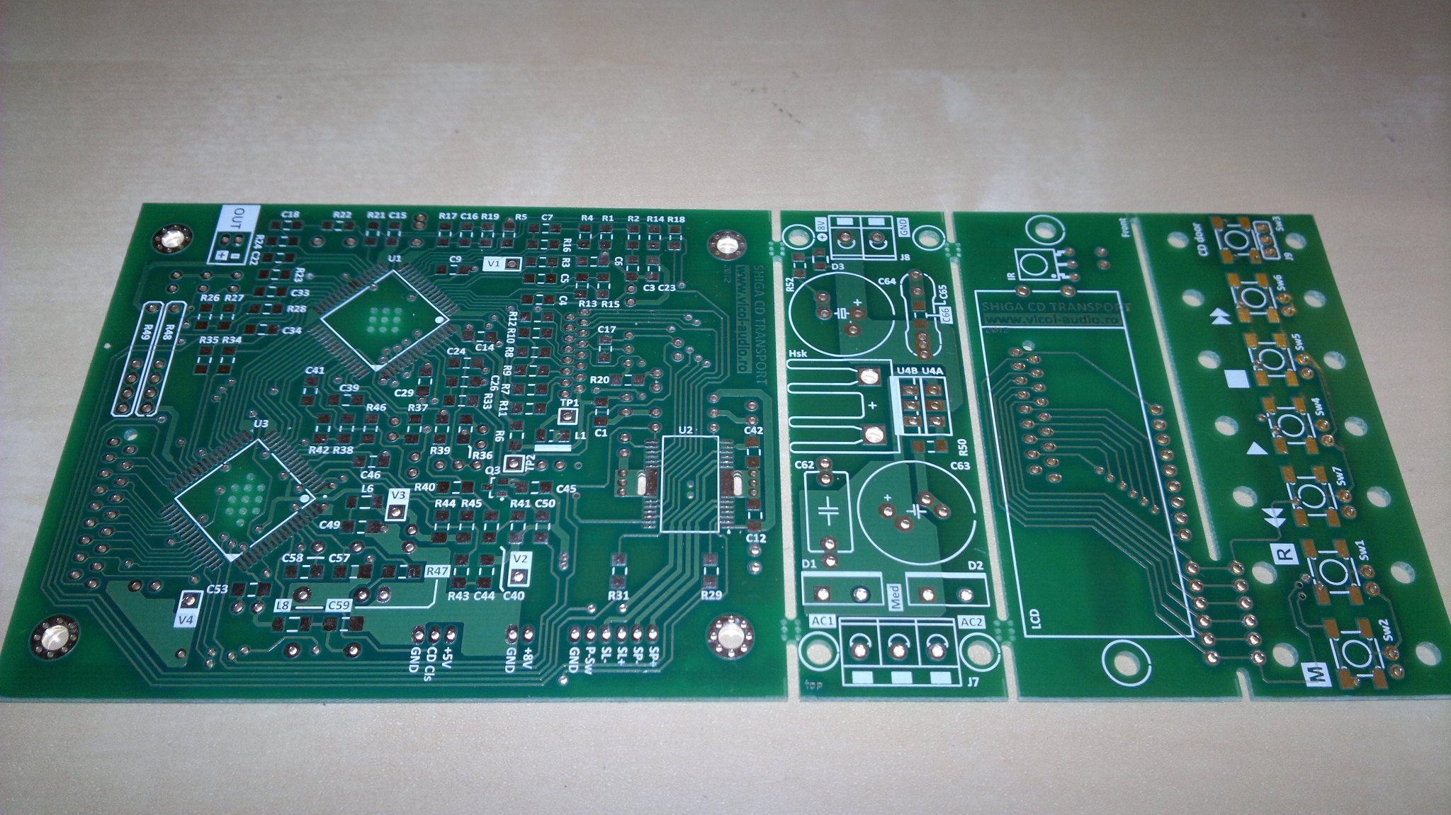

As shipping started, I will try to add here information about our boards, soldering, mounting and testing.
Please do not expect from me to be very responsive. Beside my daily job, I need to prepare kit´s for shipping, mounting and also delivering.
What you don´t know is that we are already on the third version board. First and second have been test boards.
During the initial tests we have performed many major modifications and obvious we had to redesign entire board.
Tibi

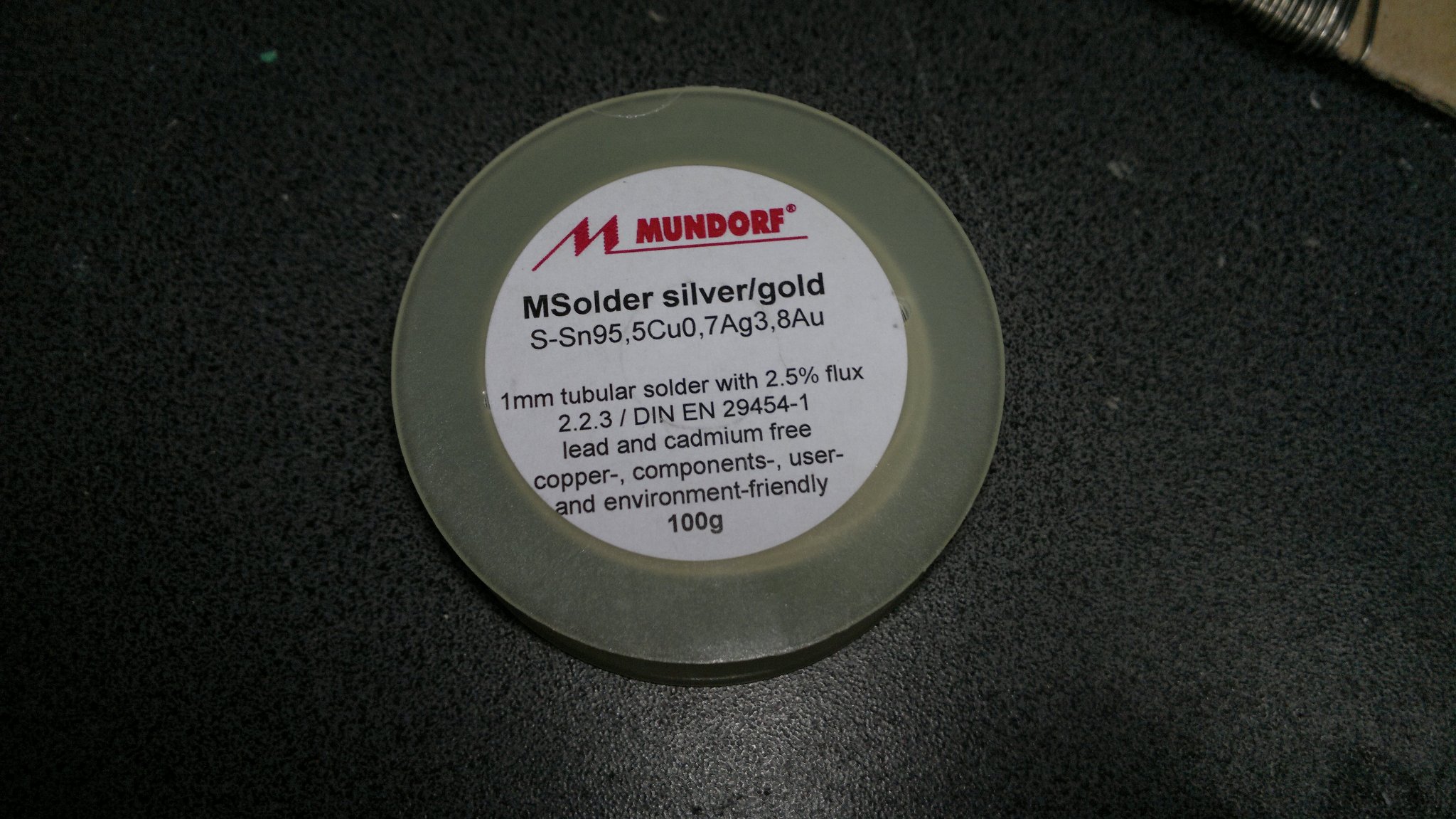

All Shiga mounted and tested are RoHS.
On all kits we use Cynel RoHS solder with 3%Ag.

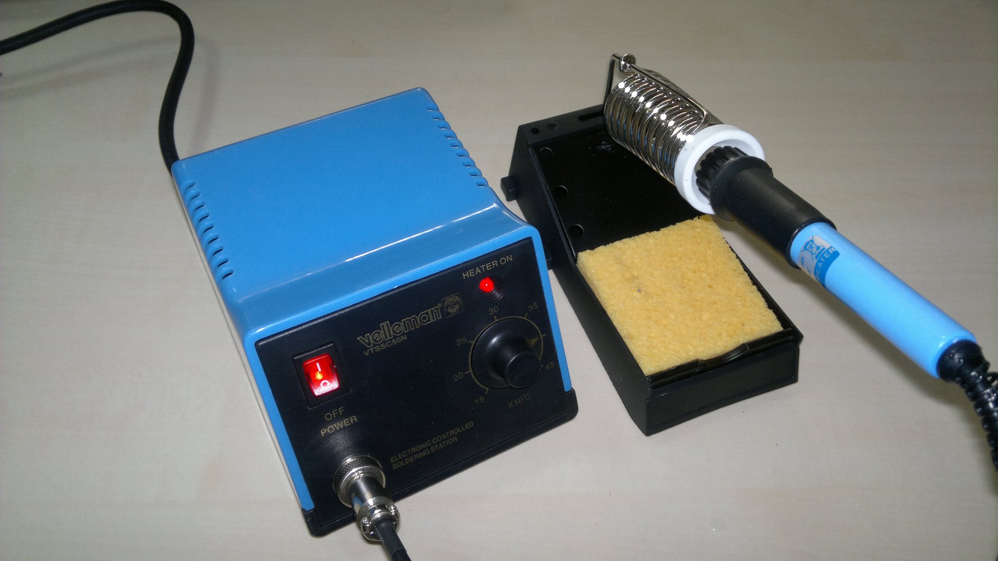

For those who are looking for the best, IMHO Mundorf is one of the best solders available on market.
Also, an inexpensive and very good soldering station is Vellemann VTSSC50N.
