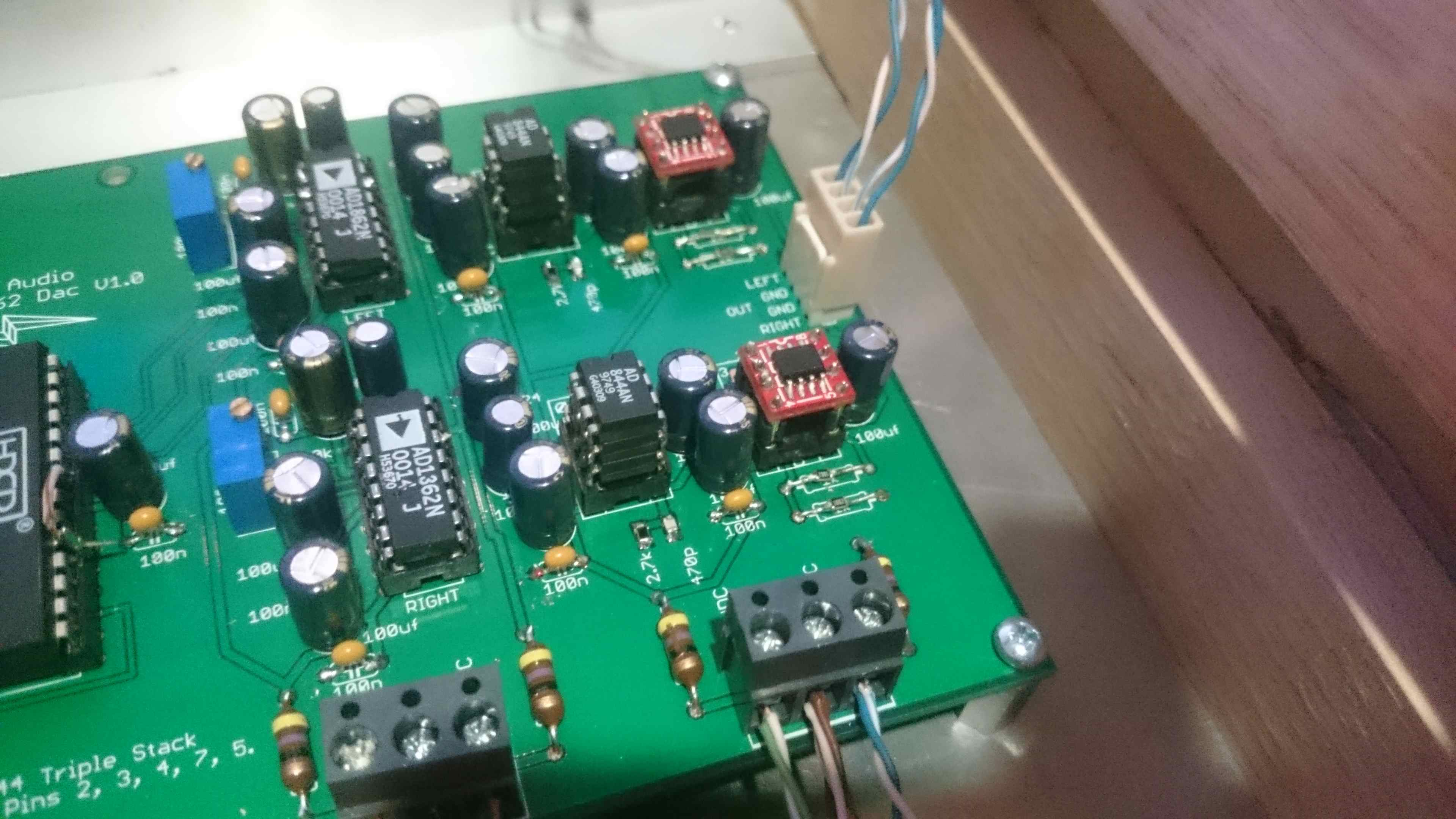

Here is an AD844 triple in a new Dac I just built.
Nice work, howsit sound?
Cheers George
Sounds great. Like a typical r2r dac. Certainly very involving and lots of micro details with extra balls. Have only done a little bit of comparing with my Pdx dac. Will do some more critical listening tommorow against an Audio Gd sigma delta dac.
