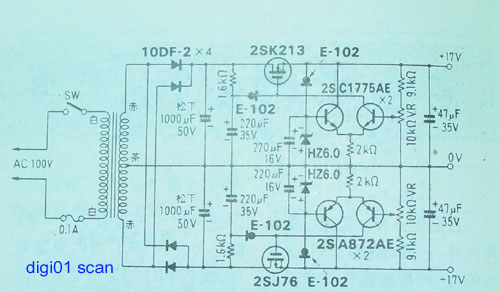

If you want the best performance, try Salas shunt regulator that is very popular on this forum.
If you want something simpler please try the attached deaign. PCB can be obtained from ebay. LM329 is much better than TL431 if you use as voltage reference.
Now this looks interesting Quan, whose selling this in Ebay ?
Thks
Here you are https://www.ebay.com/itm/291686204228
Beware of the fake version which does not use LM329 and constant current diodes.
Make sure you can find the constant current diodes before ordering the PCB. They can be purchased from farnell or digikey, I think.
The schematics reminds me of what Lesha used
on his parallel TDA 1541 dac
FYI
http://www.diyaudio.com/forums/solid-state/11661-regulators.html#post135268
The Lm329 substitute the two zener diodes in the schematic. They are Z1 and Z2 on the PCB. You can use normal zener diodes but Lm329 is best.Thank again Quan
Btw I dont see the Lm329
on the Bom or on the PCB
Thks
