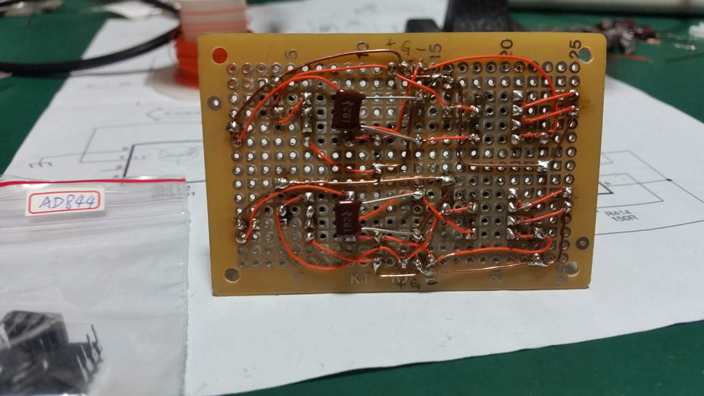

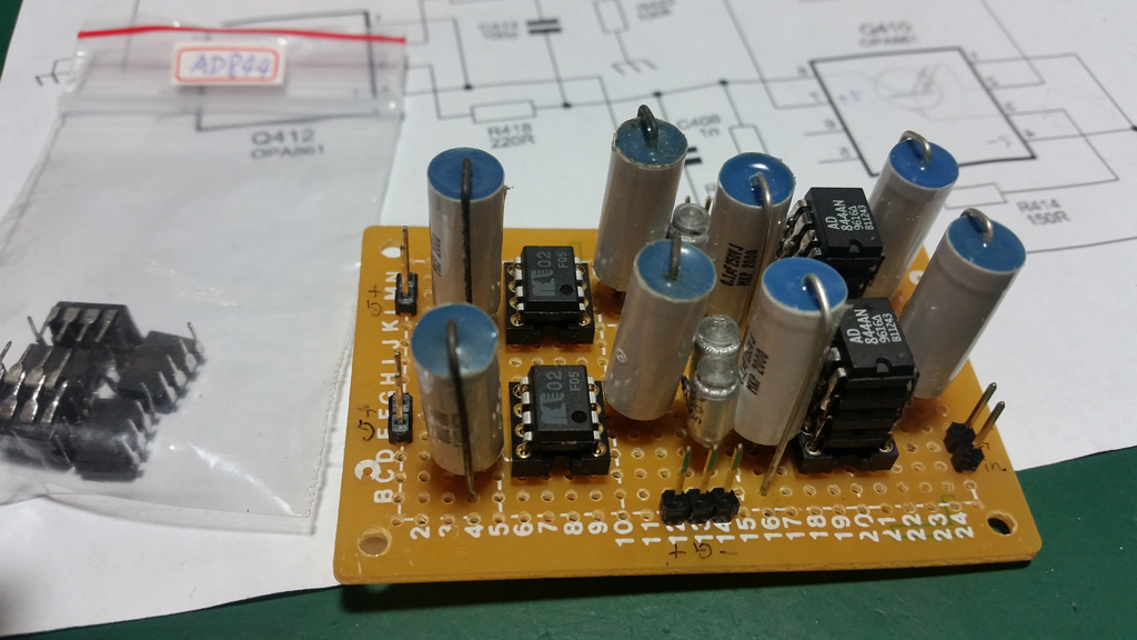

Hi guys,
Last night I quickly built the circuit, and this is my 2nd attempt. Good news is that it works perfectly. In my opinion, a better solution to my OPA861 I/V+buffer board. I am not saying OPA861 is inferior, but my implementation included ultra low noise +-5V LDOs which may be the cause of that. Anyway, I like the stacked AD844 very much. The external buffer I like are still ADA4627 or Muses02, both have their advantage. ADA4627 is more precise, whereas Muses02 produces more relaxed sound. It's hard to choose between them. I still need time to make the judgement...
PS. I am not including input 1.8nF cap as Pedja's circuit. I/V resistor is 1.8K with two 3nf foil caps in series (=1.5nF). This foil cap is very inexpensive but has performance almost equal to Soshin SE99 mica
Looking at the first pic, it seems you have soldered all 8 legs to each other???
You only need 2 3 4 6 7 and wire the null pot only to the bottom 844 pins 1 8 if needed.

Hi George,
Yes, I did. (I followed the same pattern as my stacked ad1860s - solder all pins together.) It turns out the sound is very good. Is there any downside if I keep it like this way? Do you think the stacked TZ pin will have more power to drive the IV resistor?

I would caution against that. You are kind of assuming that all the chips behave the same. In my experience they are close however tying the pin 6's together without 100 Ohm safety resistors could cause some unintended problems. You may have some bias issues internally since the null pins all tie together as well. TZ = more power? Well in a sense no. You are averaging the current mirrors. Which makes for more accuracy. AD844's have actually very low internal current likely due to die heating concerns. So.... It works. If you like the sound enjoy it. I am not telling you to undue any of the pins. I do it as George pointed out in the other post. Play it and see if any issues occur. Do the op amps get really Hot?Hi George,

Thanks for the warning. I will try to isolate those unnecessary pins tonight. I am not using pin6. Do I need to un-tie it also? As George has mentioned, pin 2,3,4,6,7 can be tied together. BTW, I didn't look into buffer OP yet. I tried single AD844 without problem, and then staked them for listening.
Leave all pin 6's float, never tie them together, if using an external buffer.
Only if you want to use the 844's buffers stacked, don't tie them directly together, they each need a series 100ohm isolating resistor on each leg then the other side of the resistor can be together and the output taken from there.
