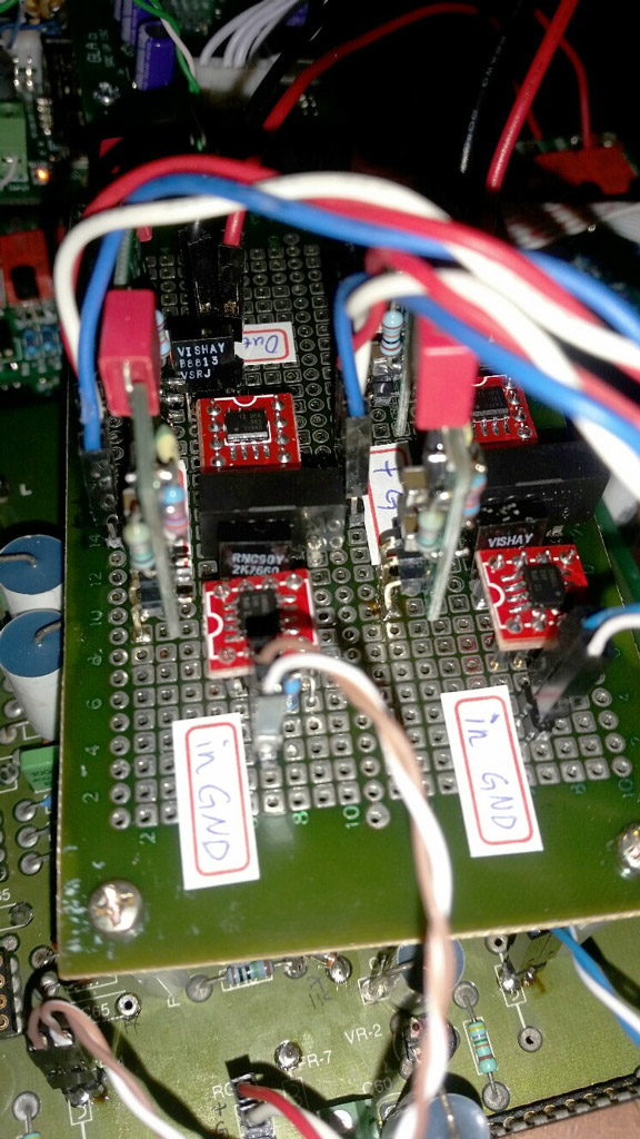

I finally built Pedja's OPA861 IV+Buffer. You won't believe how much time it took me to build this simple circuit. (I spent my whole weekend on this.) The layout is important! In my first attempt, I got very noisy output (+-100mv noise) simply because the trace of IV stage is a bit longer. It took me many hours to figure that out.
Here is my impression on Pedja's circuit. It reveals much more details than previous setup (AD811 IV + ADA4627 + LME49990). Very nice. However, the sound is thinner and less in bass. The filter of IV resistor plays an important role. I found 1000pf is not enough. I replaced it with 2200pf silver mica, and it helps a lot. Finally, I ended up with 3000pf foil capacitor. The sound is better now, but HF still needs some kind of tweaking.
My supply is 15V OP based regulator. In order to supply +-5V, a pair of TPS7A4701/TPS7A3301 are used as secondary regulator. I suspect the output and bypass capacitors (both X7R ceramic) are part of the cause. I will replace them with electrolytic and film capacitors. Will report back.

This is good point particularly if using breadboard. I think the I/V resistor and the parallel cap should be connected directly to ground pin of the opamp at the other end. This would minimize current loop.

Thanks, George and Torchwood421. I have connected the offset adjustment circuit and trimmed them down to about +/-2 mV on tda1541 output. Now I have about +/-8 mV at the output of the ad844. Is this good or can be better?.
The sound after adjusting seem tighter but I am not sure. Result is very good even through the capacitors. I still keep them for safety. I am afraid of temperature drift ...

You should now add the null circuit in the datasheet for the AD844. I believe there is a typographical error there. The trimmer should be 20K Ohm as I recall. George can confirm that. On my TDA1541 I was able to get less then 1 mV at the DAC side and 0.1 mV's at the output of the AD844. You should allow the DAC to warm up and stabilize before trimming. It is slightly temperature sensitive as you noted. I would be happy with a couple of mV's on the output of the AD844. I will be offline a few days as I will be having a medical procedure.Thanks, George and Torchwood421. I have connected the offset adjustment circuit and trimmed them down to about +/-2 mV on tda1541 output. Now I have about +/-8 mV at the output of the ad844. Is this good or can be better?.

Thanks Torchwood421. I have looked at the data sheet and remember that the nulling circuit has quite a few parts. I become lazy and I think I will just trim for zero V at ad844 output using the ccs in Pedja's design. it's not far from where I am now. I have both channels at 10mV when the output pin of tda1541a is at <1mV. I think if I trim for zero at the ad844 output I will have a very small dc at output pin of tda1541a.

The ideal situation is to zero the DAC output with the 2SK170 current source. Then null the AD844 with it's null circuit. In my builds the drift was very good. Not that sensitive. Maybe I was just lucky. The DDNF discrete circuit drifts a lot although I now have a few ideas. DDNF has it all, detail, bass slam and I like it quite a lot.Thanks Torchwood421. I have looked at the data sheet and remember that the nulling circuit has quite a few parts. I become lazy and I think I will just trim for zero V at ad844 output using the ccs in Pedja's design. it's not far from where I am now. I have both channels at 10mV when the output pin of tda1541a is at <1mV. I think if I trim for zero at the ad844 output I will have a very small dc at output pin of tda1541a.

the 8d844 is very stable now. once warmed up the tda1541 output pin always stay at <1mV. It is currently sharing the power (+-18v Kubota discrete regulator) with the DAC board. I will make a separate PS for it later but the sound is so good now. Just one observation that it has a typical AD tone in the lower midrange that is different from Burr Brown or Philips tone. It's not a bad thing but just different sound signature.
