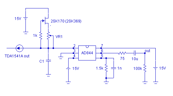

This is the IV implementation of TDA1541A using AD844.
Yes, take the output to your RCA's from pin 6, it is very good, but if you want a better buffer than the internal one of the AD844, I would take the signal not from pin 6, but from pin 5 to a separate BUF03 output buffer.
Cheers George

Using TDA1541A with AD844
Yes, You can eliminate the capacitor. You adjust the 2SK170 so that when measuring at the input you get as low a value as possible. Should be a mV or less. The output of the 844 will then be around -1.2 mV (typical). This is an easy direct couple. You can get better results as George says by using a BUF03 across the pin 5 TZ resistor. With that setup I get 0.1 mV offset direct coupled all the way. I use a nulling circuit at the BUF03 also. I also have a discrete version of Pedja's circuit up and running. That did require a cap although I am told there are ways around that too.that 10u output capacitor cannot be eliminated somehow ?

Just out of interest, (if you measured it) what is the dc offset before the coupling cap on Pedja's discrete circuit?

Pedja Discrete offset
Hi George, Due to the 2SK170 current source you'd think it would be possible to null it. I ran into a situation where 10 to 12 mV was the best I could do. The trouble is the circuit is a bit thermally sensitive. So if you blow across the transistors in the current mirror. The offset goes all over the place. The cap was an ends to a means. I think if you matched devices and made a sink to join the transistors so the temp was averaged.... Maybe you could direct couple.
thanks for the tip, but what is the value of the adjustable VR1 from the schematic? I would be needing also a simple diagram or description in a few words about the dc offset nulling on the BUF03's side in case I decide to try that one too (I saw they are pretty expensive on ebay)

First page of the PDF
http://www.diyaudio.com/forums/atta...1397769863-using-ad844-i-v-buf03-original.pdf
5kohm trimer between pin 1 and 5 wiper goes to 7.

AD844 with TDA1541A current source adjustment
Hi, I apologize for the late response. The value of VR1 is 1541A dependent. So I will tell you how to adjust it. First you will need a multimeter with a DC Voltmeter setting with a mV scale (milliVolts). Attach the positive lead to pin 2 on the AD844. The negative lead goes to a ground near the AD844. It maybe necessary to go to a higher scale for the initial adjustment. If so. Use a 2 Volt or 5 Volt scale. Adjust VR1 for 0 volts. Once your there switch to the mV scale and readjust for 0 mV. You may see some settling. It helps to have the dac warmed up. Try and get a value near 0. It isn't necessary to be dead on. The purpose of the current source is to counter the 1541's normal offset. Once you happy with the zero. (No music playing) It is time to check your AD844's offset. Probe pin 6 on the AD844 with the positive lead and the negative lead on ground. Most measure -1.2 mV or so. Repeat the procedure for the other channel. For the BUF03 across the TZ pin 5 resistor. First you do VR1. as above. Once the zero is good on the dac. Measure at the BUF03 output pin. You will have the positive lead on the output pin and the negative lead on the ground. Use the nulling pot. to adjust for 0 mV. I usually can get to about .1 mV. Make sure you heatsink the BUF03. It is heavy class A and will burn up without a sink on it. Reference post #787 for the AD844 circuit schematic. Once your happy with all that consider stacking AD844's. Two are nice. I have a 3 stack. If you try stacking throw me an email and I will tell you which pins to hook up and which ones to float. I hope that helps. Dave
