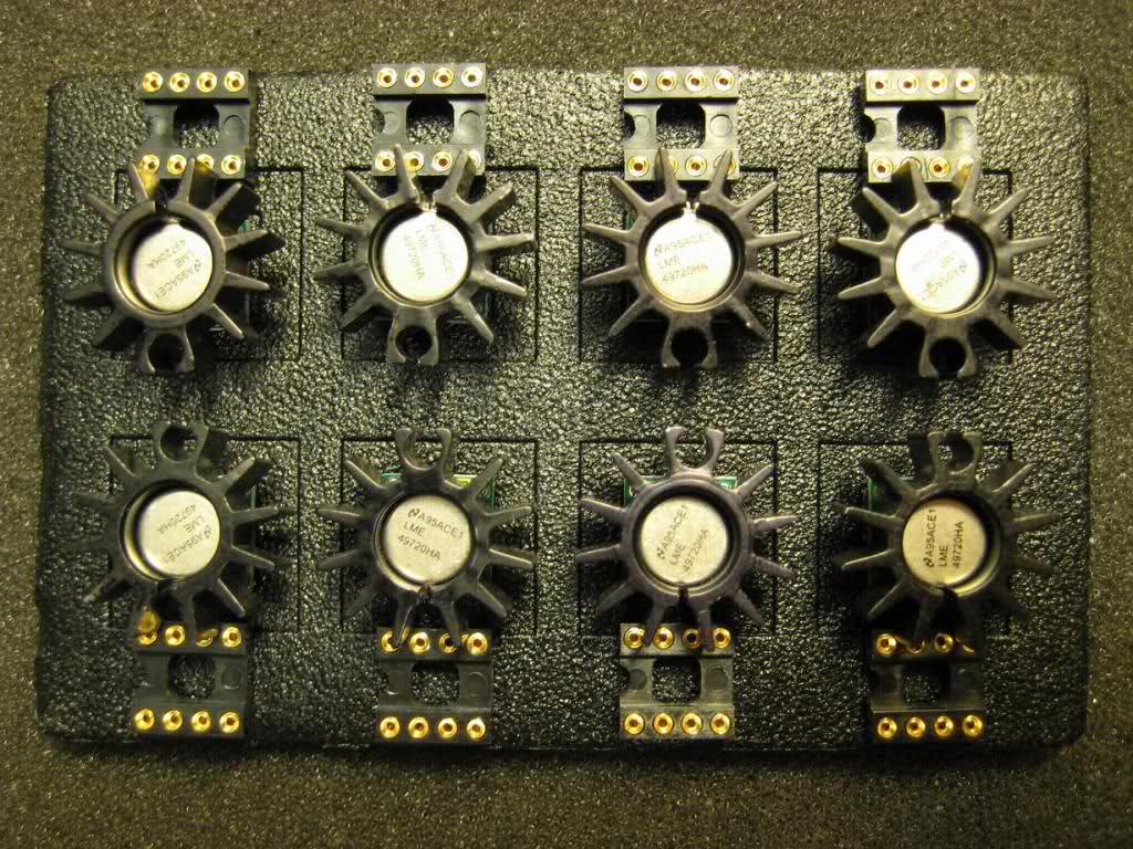

Yes the BUF03 runs very hi bias, it needs a big heatsinks, I use one like the one in the first pic but they still hit 50c, (no oscillations). The one in the second pic would be nice.
I believe the sweetness of the highs and rich midrange comes from the amount of class A bias, but the punch and awesome bass tightness, comes from the 1ohm output impedance and peak 100mA output current.

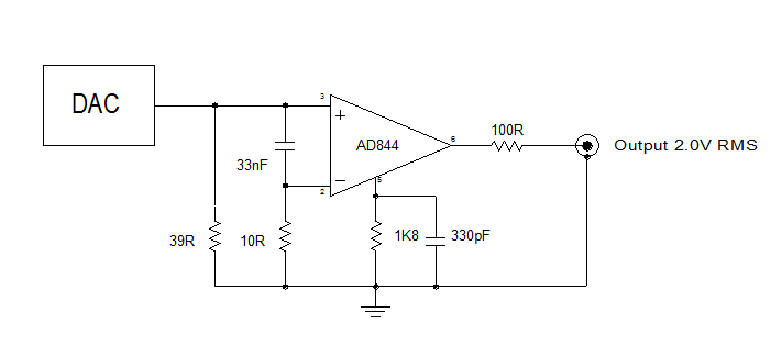

Hi Guys
I promised George to post this last time we met up on August the 1st, and of course we discussed matters related to AD844's.
I said I would show a couple of techniques that overcomes the need for stacking.
I am not saying not to stack, but simply that the reason for stacking is that in the OTA part (Diamond Transistor) current is so low, almost certainly sub 1mA. Hence, what other shots do we have in our armory? Worth at least looking at.
George feels the input impedance, what is seen by the DAC, is also important to keep low, and indeed the ideal has always be zero Z. But does 0 to 50 Ohm make that much of a difference? I see many using TDA1541A into 33R and then tubes afterward (a la Steve Garland's KillerDAC). They don't complain about the sound. How much does the DAC deteriorate not seeing zero Z? It's a matter of degree. Relative to the high Z of the DAC, it can be argued minimally.
Hera two techniques shown here will reduce the DAC's current to overwhelm that of the OTA part of AD844:
Technique 1.
Zero current induced into the OTA.
The 39R here replicates what is normally seen on "-" input in Pedja's original circuit, which I saw first time about ten years ago.
Now, with this arrangement, then all DAC's current goes to ground via 39R, as "+" input is high Z.
The component values shown are only guides and the caps are filters and may/will vary from DAC to DAC (use one or the other or both, but get their values right as they do affect the sonics). The 1K8 value is adjusted to gives 2.0V RMS output. Any DC offset can be trimmed used by the facility inbuilt in the buffer, by simply adding a 20K trimpot from Pin 1 and Pin 8 and the wiper to Pin 7.
Note, as George told me he does, the output can be taken from Pin 5 (by-pass internal buffer) and then use a separate buffer like BUF03 etc.

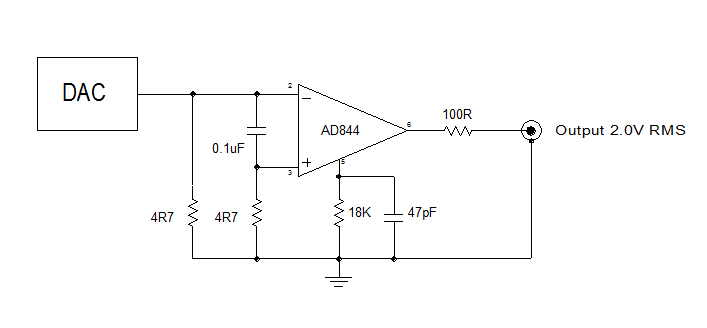

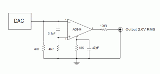

Technique 2.
This one may interest George as it actually makes the DAC see a much lower Z than even stacking could achieve.
The nominal input Z on "-" is 50 Ohm (that may be a max spec or more like 40?). But using a much lower value (about 1/10th) the current gets shunted to ground and very little DAC current ends up upsetting the OTA.
This may well be an equivalent of stacking up to 10 x AD844?
All the other details as far as constructing this, is the same as for Technique 1. That 18K value shown indicates that much higher gain is required, but the AD844 is suitably low noise and can handle it, so adjust 18K to give 2.0V RMS output.

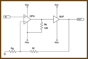

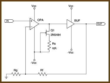

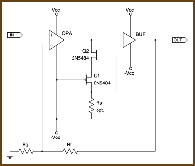

Very interesting. Do you guys think a class A bias with a single or cascoded jfets would be worthwile in 2 or 3 stack AD844? Are there any drawbacks?
Biasing Op-Amps into Class A
That article takes the traditional view of class A - that its about reducing crossover distortion (and thermal distortions). I don't subscribe to that view, but that by no means negates their circuit proposals.
Drawbacks of class A biassing are increased circuit complexity and increased power consumption. Both a small price to pay for improved punchiness (aka dynamics).
... but that by no means negates their circuit proposals.
Which circuit would you recommend (hmm, simple vs complex) and why? Other?
