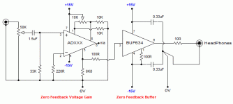

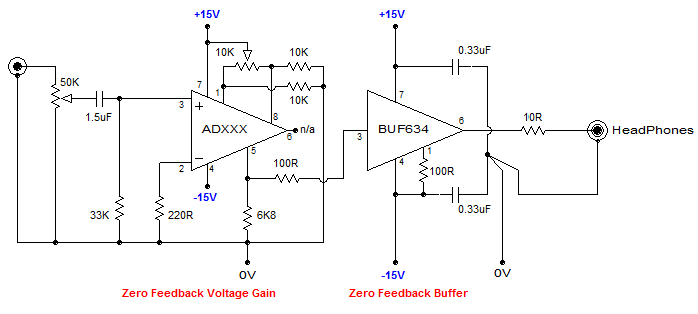

One very well-know audio designer of a very famous brand, uses the 844 with the output on pin 5 and adds his own buffer. Indeed you could use something like BUF634.
I did a head-phone amplifier using that exact combination. Keep in mind that if there is no feedback around the BUF634, then the DC will shift, but interestingly, even though you are not using the 844 internal buffer, it is still internally connected to Pin 5, so we can still use the in-built DC trim of the 844 to null the output of the added buffer. I know it sounds weird, yet it occurred to me it would work and then actually did it. The offset will now be transferred to Pin 6 but the added buffer will be nulled. And quite stable after everything is thermally settled.
Another thing, what value are you using on Pin 5? If that value is low, then it figures that the output Z at Pin 5 is that resistor divided by the load value minus the resistor value.
You say you use 1K5 and then connect a highish 50K load to that. Then the output Z is effectively a low 44 Ohm. Keep the load impedance high and the Pin 5 value resistor low, and you will have low Z (in effect there is a kind of current output effect going on here). The lower the value load, the output Z goes up. So keep the two values as far apart as possible to get the lowest output Z.
Can you see what I am getting at?
Why not try to listen to it without the buffer?
Use the Trim to null the DC at Pin 5 with the load in place- and stick with that load. Or DC offset will creep back into the picture if you change the load value.
But this is only a pure DIY thing, you wouldn't do it commercially without a buffer, no way. But DIY, hey, we can do this no problem - and set it up to exactly for our system only - for our own pleasure.
Charles Hanson designer for Ayre used 8 x Ad844's in one of the Ayre CDP's also Krell uses one (do know how) in their best ever cdp the KAV-300CD

BTW, the schematic shown above was a headphone amp and did need an external buffer, specially driving as low as 16 Ohm - but otherwise I agree, the internal buffer is not that bad. (It can drive 600 Ohm Sennheisers of yore.)
