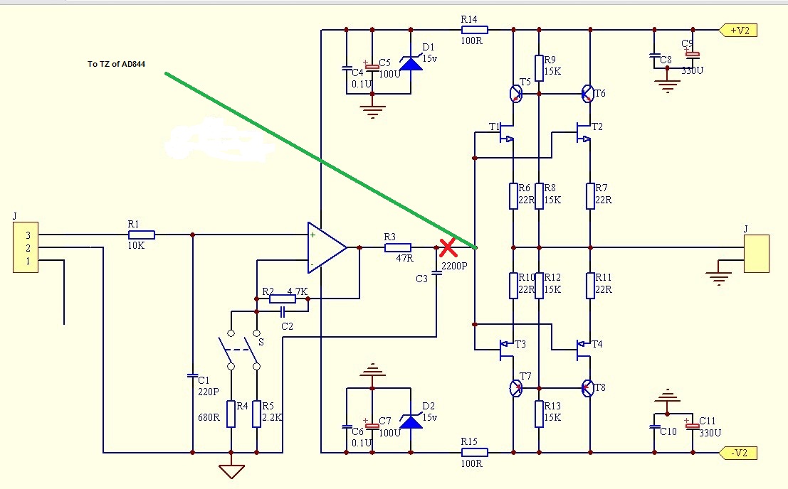

Hi George, Sounds like a BUF03 might be good as a buffer for the TZ output pin. FET input very high input impedance. I have several of those. Never cared for the sound of the BUF04 or AD811's. Have you tried Pedja's discrete current mirrors? I see the PDF was posted earlier in this thread. I may try the OPA637 for I/V, if they are affordable. I think these maybe very expensive now. If you know of a better buffer please point me to it. Dave
Very happy with the buffer I'm using at the moment http://www.diyaudio.com/forums/atta...ng-ad844-i-v-fetbuffer-2-dc-offset-adjust.jpg
But I have found this ready made one on ebay, do you buffer gurus think it's any better than the one I'm using? As the one I'm using I have measured at 100ohms output impedance, I would like to get lower if possible if this is or it's a better circuit?

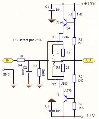

Hey George, sorry I dropped off the face of the earth but I see you've been going great guns! You are a wild man: no fear, I love it!
Looking into the output of your buffer, the lowest resistance is the pairs of 22 ohms on the top and bottom. So that means you'd see four 22 ohms in parallel or 5.5ohms.
Layout will be important, care to share the address or is it hush-hush ...
The output is doubled and the other trans must be doing some sort of cascode-thingy that I'll let the smart people talk about.

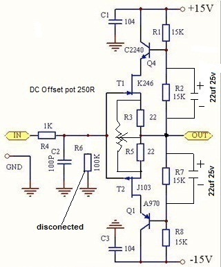

This is the one I'm using now, and when I loaded it's output with 100ohm I got half the output, so it's output is 100ohm a bit high for a discrete I thought.

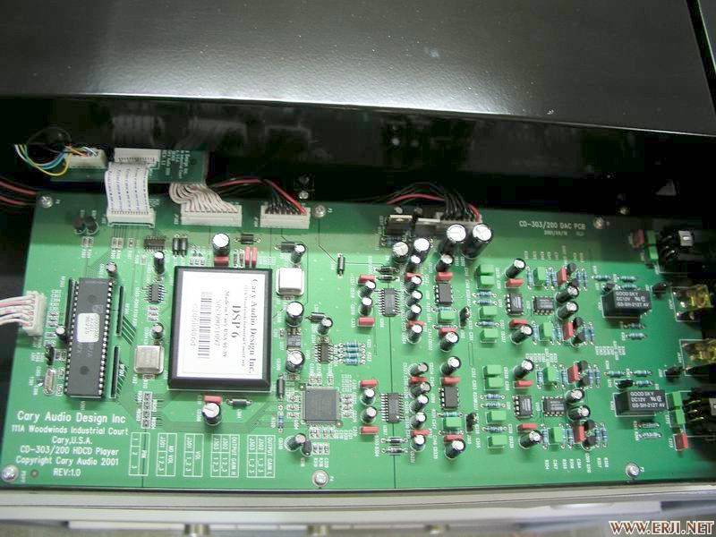

My AD844's are powered from whatever powered the original opamp opa627 I/V in the Cary CDP, I'm using the same socket.

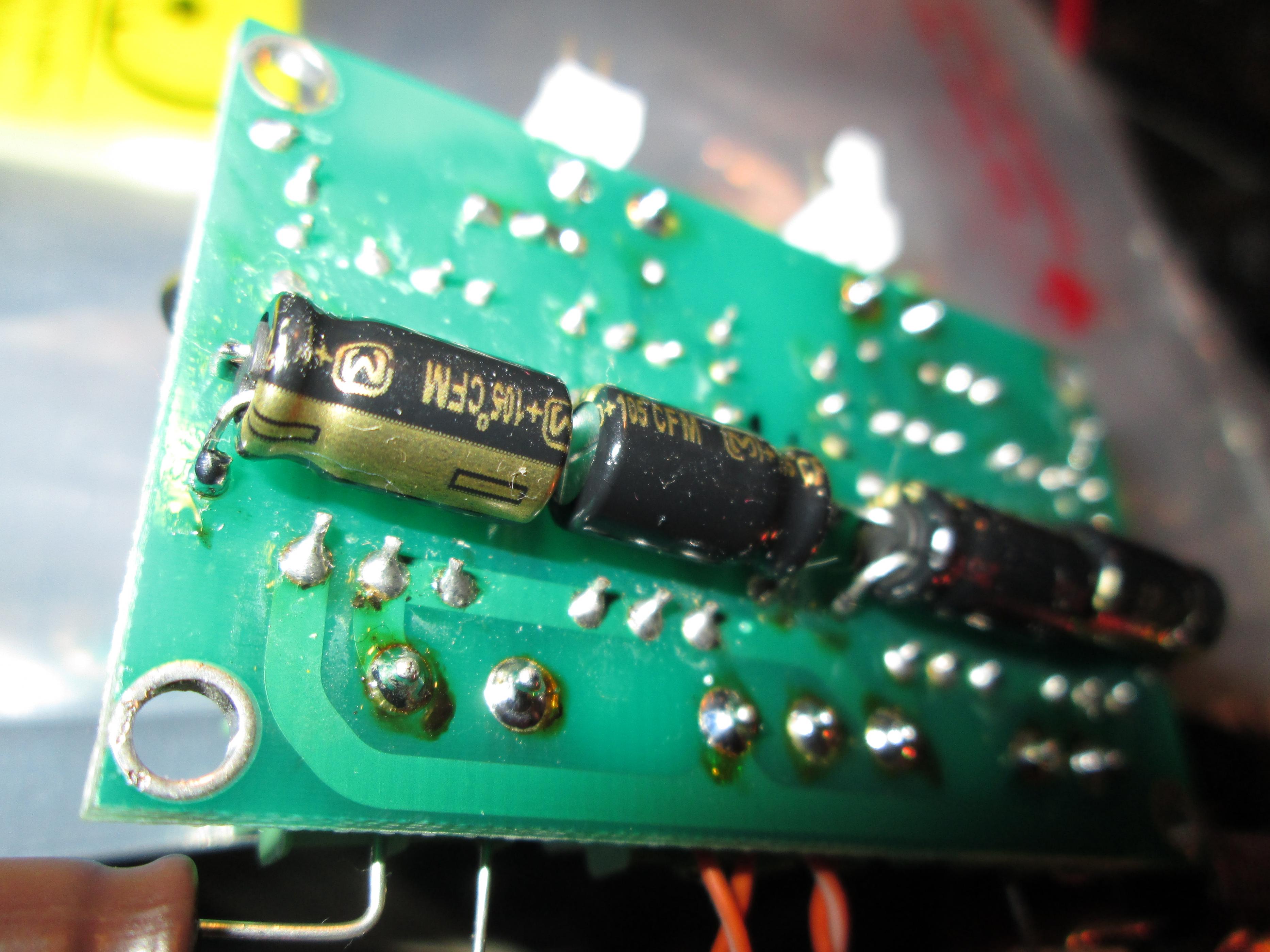

Interesting asymmetry in the ps bypass. Top of chips: hf and electro as close as possible--nice. Bottom: hf and electro a bit further behind a filter or something. If you can get at the back side of the PCB you could try removing the two caps and soldering them right to the pins of the opamp socket (top set too since on the pins is pretty much 'as close as possible') BUT you need appropriate GND connections super close ... we'd have to see.

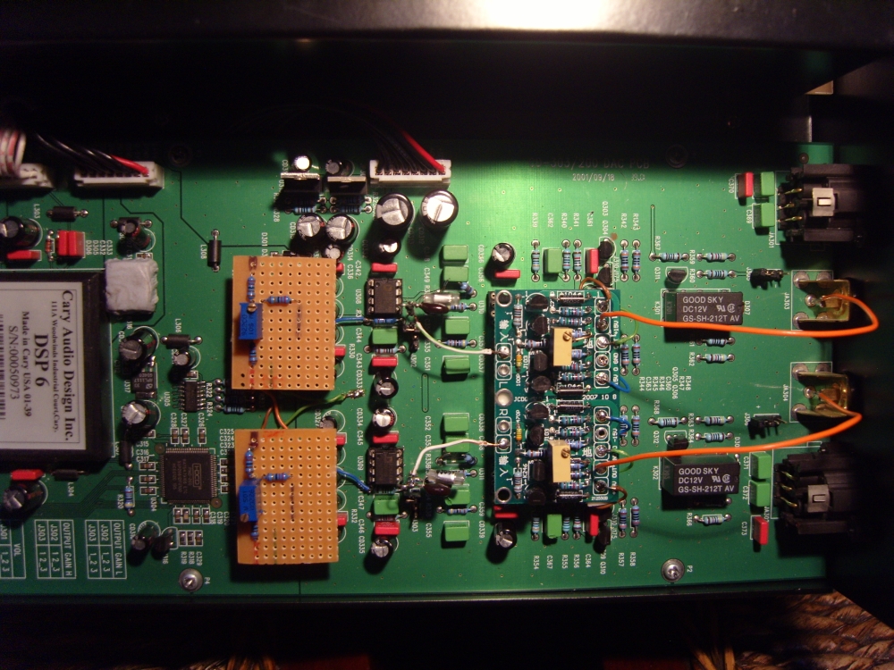

I have scoped it, with a 200meg Tek with all my tech bench test disc's till I was xeyed. Stable as rock under all conditions.
What happened sound wise with the 2x stacking was a sense of ease to everything, like there is now unlimited headroom for want of a better word. Yet the dynamics, punch and transparency and detail are still all there as it was with one.
I have all left off all fitering caps, across TZ resistor and the input of the buffer and no input resistor to the buffer, TZ straight into the fets. I do have 2mV of very high noise now on the output, but it's so high even the scopes 20mhz filter doesn't touch it, I scoped it all the way back to the PCM1704's itself giving it out, nothing to do with the AD844's or buffers.
