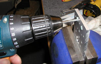

So I'm saying once again: cordless drill gun with a clutch is definitely the easiest and fastest way to tap. Trust me, I do it almost every day.

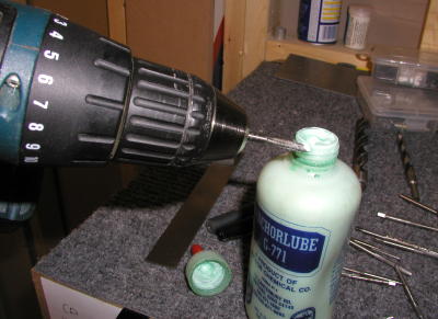

My favourite gun for that purpose is Bosch. It has more finese than Makita and deWalt is good only for heavy construction work. The clutch is set to 5 on a scale of 24. I mount the tap and put some lubricant to the tip. I'm using that lubricant, but any oil is good and I even had good results with WD40.
For the demonstration purpose I mounted the 1/4" aluminum piece in a vice, but usually I hold it by hand. I'm tapping with 8-32 tap and the hole is 9/64". I run the tap and approx. halfway the clutch engages. I put the drill in reverse, clean the tap and go again. This time it goes through completely. Whole procedure took less than 10 seconds. Don't tell me you can do it faster by hand or Tapmatic. Also using drill gun has this advantage that it's much easier to align the tap straight and holding it that way while tapping (comparing to doing it by hand).
I also tapped 4-40 size thread. The hole is 3/32". This time the tap went through in a first run. 2 seconds maximum and it's done. While doing it this way it's impossible to break the tap. The only possibility it may happen is either dull tap or very hard material. Some aluminum alloys are easier to machine than others.

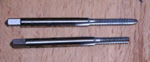

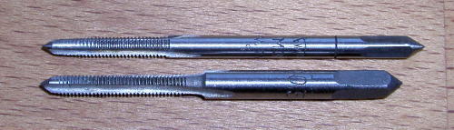

Remember also, that most of the taps you see are machine taps and supposed to be used in Tapmatic sort of heads. For hand tapping, proper tap sets come with 3 taps per set. One is used for starting thread and it has has the grooves starting very slowly, far from a tip and they are not deep. Second one is intermediate and the last one is a finishing tap, which makes final thread. You can usually omit the second one and use only the other two. When you have access to such tools using taps and doing it by hand is also very easy and it is impossible to break anything.
I recommend to use oil all the time. If I don't have oil I use saliva and it works too.
The pic shows what I was talking about. Both taps are M3. The top one is for starting a thread, it goes very nicely into a hole (which should be 2.5mm) and it's very easy to keep it straight. The second one is to finish what first one started.

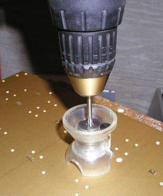

How to tap with drill press?
Peter,
Thanks a lot for all the illustrations, it is a great help.

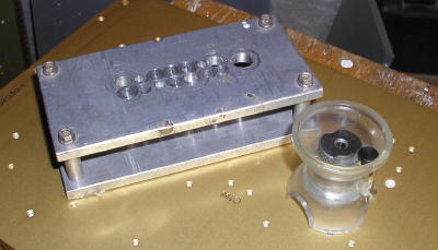

After reading a lot of threads I picked up a router and a drill press. I did not buy a saw as I can use router to cut wood (and I am not planning to cut a lot of it anyway) - still learning how to use it properly, getting better though. I bought a drill press instead of a portable drill as I read that it gives better accuracy and control. I was going to practice drilling and tapping on scrap aluminum this weekend. But till reading these posts I did not realize that you would need a clutch for tapping
So, is there a clutch that you can attach to the drill press? Or some other technique can be used. I don't think I want a drill press if I cannot use it for tapping as well. I guess I can make some of drill guides as shown above before returning it
