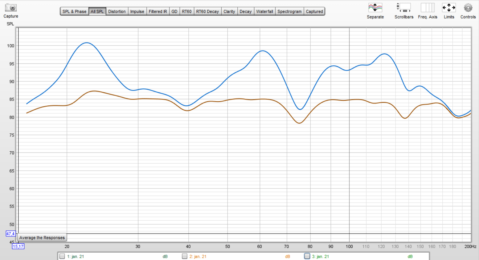

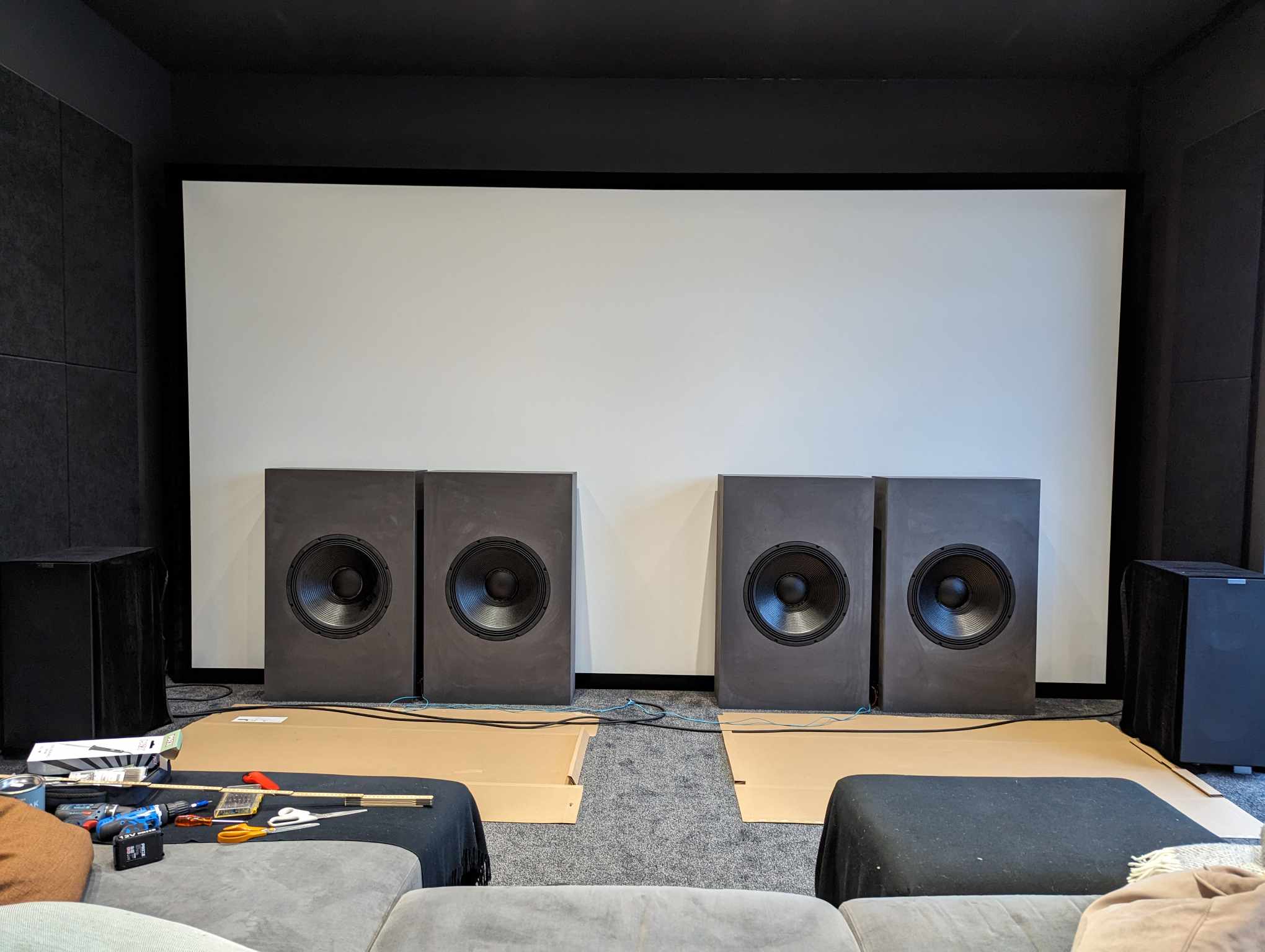

Just finished building 4 of the 8 subwoofers and did some quick measurements.
I just did a quick EQ import from REW into my Storm Audio and managed decent EQ'd results. Blue is no EQ and the other with EQ.
I did not boost the low end so in my room atleast these 4 x 21" Nero subwoofers are flat down to around 15hz.

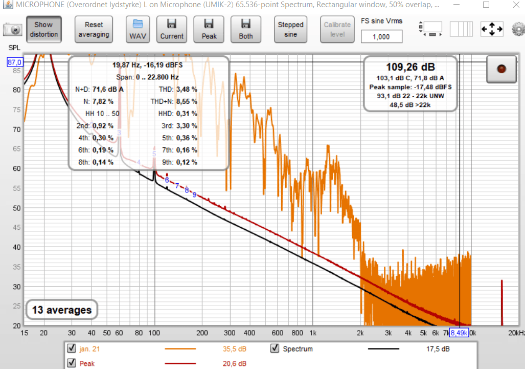

I did a 20hz THD test at around 110dB, was pretty intense already at this level and it sounded very clean, no wierd mechanical sounds etc.
Everything running off an Inuke 6000DSP for the time being. Woofers in parallel in pairs.
Please don't mind the mess, it's a workshop right now :)

Very nice results both for the build and the measurements!
4 of them can do 118dB @ 20Hz before over-excursion. 8 subs can do 124dB so I'm curious to hear about their combined output when all of the subs are ready. Also nice to see that they do 15Hz in room ;)

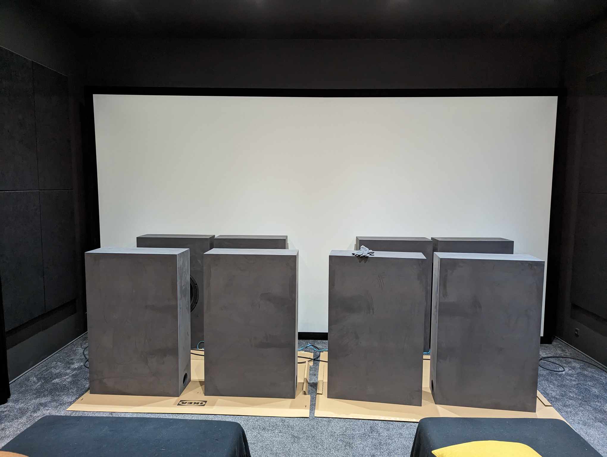

I build 8 cabinets, but the remaining 4 woofers are not arriving until feb. 23. So in total there will be 8 x 21" on the frontwall behind the screen.
To be able to fit the LCR's, and possibly larger LCR's in the future I planned on stacking subs on top of each other. I used REW room sim to predict the respons with 8 subwoofers stacked on the frontwall and in practice it seems very promising. So imagine the 4 in the picture with 4 stacked on top of them as the end result.
Combined acoustical power including my 10 x 12" rear subs + 8 x 21" in front should be 120dB@20hz with low distortion and I think that will be enough. Already at ~ 110dB@20hz it was fairly intensive! In theory adding another 4 would be 6dB, in practice maybe less, but with the rear subwoofers included I will hit 120dB@20hz with less then 5% THD I hope. Once everything is installed I hope to make more measurements before running DIRAC/ART, to confirm everything is performing as expected.

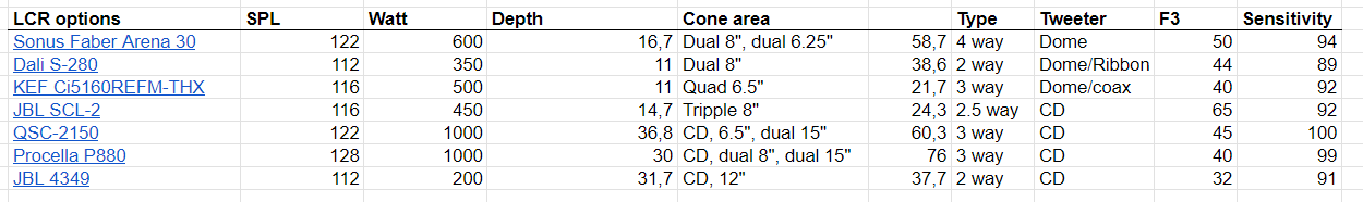

I am looking into other options for LCR's, but I am somewhat limited with a ~40cm/15.75" depth behind the screen. I've compiled a small list of alternatives. I am looking for something that can play loud and I have plenty of space width and height, just not depth.
I am considering building some of my own LCR's instead of the candidates on the list.

I like Dali and have considered the S-280 too but I disliked the low sensitivity and the passive radiators.
The Procella P880 look exactly like what I have in mind for my own HT. I already bought the speakers (Kartesian CD, dual Purifi PTT6.5 and dual PHL 15" woofers to get a 96dB sensitivity) I'm still doubting to go active or passive. Once done, passive crossovers will last very long. OTOH the coils for the passive 300Hz crossover between PHL and Purifi would be quite expensive. With an active plate amp like the Hypex Fusion it's easier and faster to get a decent sounding speaker. OTOH active amps can fail and I would be the only member of the family with the knowledge to replace and repair them. Choices...
