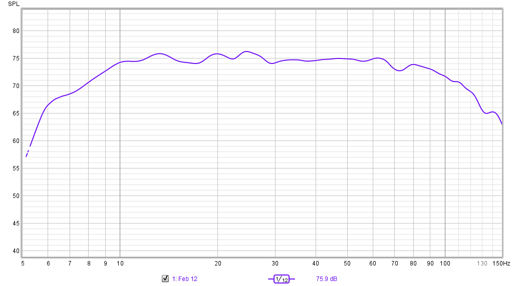

I can certainly feel stuff below 20 Hz on movie soundtracks, so it may be useful to have 10 Hz. For music its just annoying to hear subsonic noise, which do happen on a lot of records.
Anyway - here's my Double Bass Array measured in the main listening position, with LPF at 120 Hz :
Very impressive graph! I've read many good things about DBA's but my living room simply doesn't allow such a setup. My house was insulated by the previous owners and they did a poor job with sagging glass wool and cold bridges on the rain side as a result. The back wall needs to have enough breathing space to allow the moisture to evaporate so no dangerous mould can grow there.
