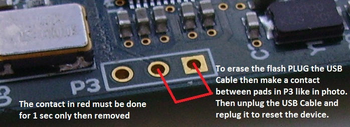

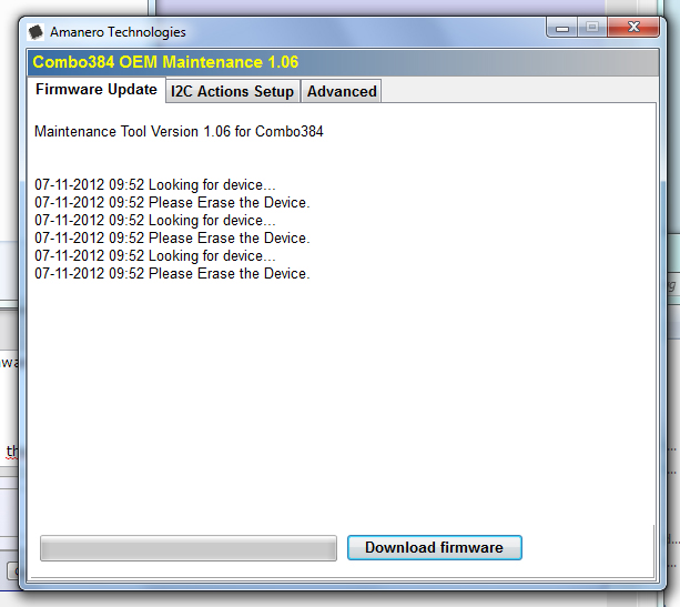

And then I have an issue with updating the firmware :-( Followed the steps in the "how to" link:
Amanero Technologies
but when trying to download the new firmware, the configtool.exe says "Please erase the Device" ... ? It says so even if I unplug the device...
My guess would be that the device is erased already since windows tried to install a new driver when I re-plugged it.
Any experiences with this?
Appreciate help :)
Jesper

Did you follow the instructions on the "How to" page?
After erasing the device you need to disconnect it, and once you plug it in again and it is detected by Windows as an unkwon device you need to install the driver that comes in the same zip as the tool. It will be then identified as an "USB to serial device" only then you can update the firmware.
I did exactly as described in the update "how to" and first off windows detected that this was an unknown device and that drivers was needed (or a wording with this meaning). However, windows didn't do anything & the config tool kept writing "please erase the device ..."
Also, when I plugged-in the board the computer gave a "do-do" sound as if it had registered the device.
Anyway, I went into control panel - hardware manager - devices - and at some point I was able to ask windows to search for a driver. I chose the folder with the update tools and windows apparently installed the driver software.
After this I was able to download the new firmware and it apparently installed what should be installed (?). Now it appears as a device in "devices" in the control panel.
