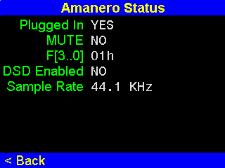

I've got all of those already set. I've tried two SACD's so far and both get converted to 44.1 PCM first. Does it work for you ?
I'm just wondering if it's a DRM issue that the raw data has to be converted to PCM first in order to protect the raw data stream from being copied ?

HI David.
Peharps your problems is for you don´t know the following.
SACD disc only can be played in DSD mode with dedicated SACD players, never with computer. The computers only can read PCM layer of SACD disc.
With computer you can play DSD files previusly extracted and decoded from SACD disc with modified PS3.

You maybe right about that. From the Jriver wiki. https://wiki.jriver.com/index.php/DSD#Ripping_from_SACD
Ripping from SACD
This can't be done with a normal PC. It is possible using an original Sony PS3. Here's a thread at ComputerAudiophile
However there maybe other exceptions to this but this is what my Amanero board is reporting through my dell Win 7/64 PC when playing an SACD.
Hi David,
Just clarifying- are you actually playing a physical SACD disc in the PC optical drive?
Or ripping a SACD via the PC?
If yes to either case then smanz explanation is spot on - you will never get DSD playback mode.
I've now tried a five or six different different SACD image files & they all play fine in DSD 64 mode. I'm guessing they were all ripped by the modified PS3 method.

Thanks clay, that explains the inconsistencies.
