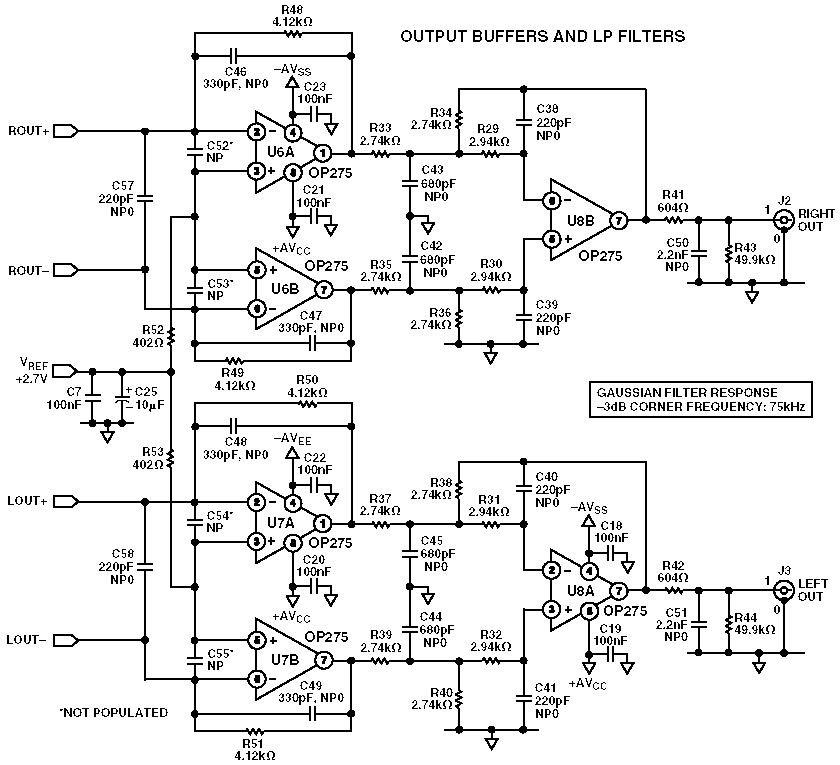

"-Download the datasheet of the AD1853 D/A converter. The layout fromt he first 4 opamps after the D/A converter is identical to the datsheet in the DAC1."
Is this the layout you reference? from Analog Devices Rev. A specs.
ichiban said:
Yest for 100% only the Benchmark use a dual opamp in the last stage, and the second half of it have the function of a unitygain buffer. Between the output and the input of the second half of the dual opamp you find the nasty elco's in the signalflow. I don't get why no other mod company bypass al those opamps after this circuit, because the decrease the sound. My advice take the output from the second opamp after the I-V conversion. The dac1 original use 4 dual opamps in the signal flow before it finaly reach the outputstage!!
All values for resistors and feedback cap's are equal from the datasheet. If you still want to use the headphone amp, replace the unity gain buffer in the secondhalf of the opamp with a wire. The signal will be buffert again be the next opamp in the Buf634 circuit.

Dear,
To tune out DC on the output can be diffficult. Analoge Devices (and so Benchmark) already did it by feed a voltage of 2.7 volt into the negative inputs of the I-V cconvertors to compensate the DC offset of the dac chip. However you still get a remaining 200mV DC. For DIY-ers that is ok because most of us know how to deal with it and take care of it in our pre-amplifier. But for comemrcial use the dac should have near zero DC offset on the output. Compensate it by change to voltage applied to the negatieve input of the I-V covnerter wont work 100% because the DC drift is dependend on temperatuur etc. We designed a dedicated DC servo circuit, that does the job verry wel, and much better then every CAP or Elco in the signalflow IMHO.

Wel, the most important thing is to replace at first those SMD caps in the signal flow.
A: I don't like SMD caps (ment for power supplys) in the signal flow.
B: I don't like the capacitance of 1000mF!!! and
C: I don't like al those bypass caps.
Replace bij a simply 47mF blackgate hiq NX makes miracles (but I prefer a good designed DC servo though).
This give the dac more freedom and less grain. The grain some people complain about is gone already for 60%
The next step is to remove the NE5532. Doesn't matter what Benchmark says about how great those perform... I don't like the sound :D. Especialy not as an I-V converter with the NE5532 slewrate limitations. Even though the OPA2134 measure less good I like the sound so much more. Replacment of opamps give the DAC1 more depth and insight in the recording room. With the NE5532 I feel like the DAC1 sound dark and a little bit compressed (in an unconsious way) and nasal.
The AD1896 upsampler ic (what benchmark called "ultralock") works nice with the FIFO buffer. We can discuss about those upsampling and FIFO buffer principes but let's not do it in this topic :D. For me it works fine with knowing the compromises and the limitations. However the performance is now for a big part dependent on the internal asynchroon clock. Sadly the DAC1 have the XO and the AD1896 fed bij a noisy 7805 voltage regulator wich decrease the performance. The Tentlabs XO-2 (www.tentlabs.com) clock with an super clean onboard voltageregulator provide a better and more stable clock. Here the DAC1 gains great in performance. Simply tighter lows more definition and details I never heard before. Now the dac1 sounds like reference class.
The power supply mod. like we do (12000uF of capacitance instead of 2000) gives the dac1 simply more rest and bass slamm. And we like slamm and tigh bass. :D (I'm I bass player you can't blame me :D)
The standard dac1 straight out of the box perform great for the money. It give some detail and resolution unheard of for this price point. But it is also not very involving and musical sounding. It is detailed but I miss a texture and natrual flowing of the sound. After all the mods
-I-V conversion for AD797
-Buffer opamp for OPA627
-Bypass of all the other opamps signal straight after the second opamp to the output like the analoge devices datasheet
-Power wuply upgrade with 12000uF capactitance
-Local powersupply capacitance of 220uF near the opamp supply pins
-new masterklok
-New decoule cap in the digital input
Now the dac1 sounds big with a lot of depth. No grain but a big inside in the recording room with plenty of detail Tight and fast bass with a real chest feeling slamm.
I still think the AD1853 is a little big dark sounding, but I really like the performance of the upgraded dac1. Especialy the resolution and the details and the musicality.

Bas, can you share more detail about it? I was thinking that we might be able to reuse the 1/2 opamp (after the 1000uf/6.3V el caps; C13 and C14) for the DC servo.
Dear Marin,
You are correct. We remove the 1000uF and bypass caps after the 1/2 opamp. We inject the servo output into the negative input of the 1/2 opamp. With the Op27 and a 50Khom trimpot between pin 1 and 8 you can tune dc offset as low as 0,01mV. proper care have to be taken of the filter caps of the servo and local powersupply. One problem is, is that the servo acts slow when first turn on. It needs 8 seconds to tot make the 200mV dissapear :D So wait 8 seconds with turning on your preamp :D. Our servo will have a relais that short the outputs for 12 seconds.
Iexperiemnt with many DC servo ideas, but for now it turn out the most simple way sounded the best. But we are always searching for beter and stille experiment with servo's with a higher order of filtering with cascade connection.
If I had to design a dac from the groun up I would not inject the servo output to the inverted input of the buffer opamp, but I would try to let the servo ajust the offset compensation pins of the opamp tot ajust the bias generators.
