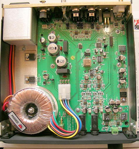

I thought of what is making it sound thin...this tone I have heard before...and then it dawned on me! Sounds like 5532! Ok I opened it up...11 NE5532's! silicon bridge rectifiers, smd coupling caps...
Gentlemen! your attention please! Suggestions are in order. Remember, there must be a double opamp thats unity stable and not a rare species with touchy behaviour for throwing out the 5532 among other hot rod suggestions.
P.S. The DPA little bit has 2604 smd, can a resistor from out to V+ or V- help it ? Had good results with 627 doing this once. If yes where is better with this chip? V+ or V-? ...Carlos FM?
See a picture of the benchmark with lid off :

78xx everywhere! What an inferno!
You can say that.
The board is not practical to work on, at all.
Standard rectifier bridges, SMD electrolythic caps, 78/9xx regs... :bs:
I can't see the bottom side of the board, but those regs should be bypassed (input and output to ground) with some small caps (100nF is fine) right on their legs.
No electrolythic psu caps on the analog stage... limits the opamp choice to... NE5532, and some others. :D
How practical is it to make a decent psu bypass on those op-amps?
Is this an expensive dac?
:bawling:
salas said:
How much overall capacitance on analogue +/- PSU?.
Before the regs, at least 4,700uF. But if that board allowed you to make an RCRC PSU...
Right after the regs, no big caps. Up to 100uF.

salas, how old was the Benchmark DAC-1 when you performed your listening test? thin tonality is usually a problem before a component is broken in (i have a class D amp in-house now suffering from that as well). these IC-packed digital designs in particular need several hundred hours of playing time to loosen up.
i would be careful writing off the component choices before the unit is fully broken in and the design and implementation details are understood. audio design is a holistic process, and often substituting "audiophile" parts is more an exercise in futzing around with different colorations than truly improving fidelity. not saying i wouldn't tweak the Benchmark myself (i would), but only with great care, particularly in regard to the SMD components.

You need some guts to charge $1050 for below mods, on the DAC that can be bought for $700 used:
Two bridge rectifiers replaced with HEXFRED's
Replace regulated voltage filter caps
Improve power delivery to DAC and upsampler chips
Improve power delivery to 9 op-amps - Black Gates and HF caps
Upgrade DAC filtering
Replace all voltage regulators.
Eliminate AC-coupling and tune-out DC offset
Improve digital input coupling
