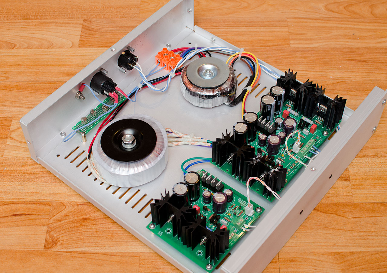

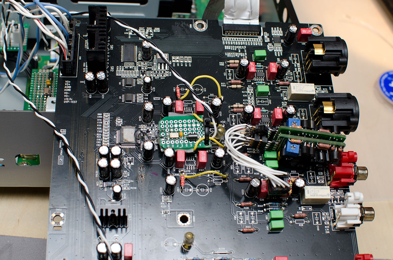

Here it is, my version of mods on oppo 95 based on Coris and Joe experiences. Thank you all for being generous with shearing your knowledge.
It used to be love/hate relationship with my stock oppo 95. Love because of it's functionality and hate because of the sound. Never liked oppo 95 sound character because in my opinion it suffered from "digitisis", harshness, flat sounding, uninvolved etc... (my reference is Marantz SA-11S1). It's worth mentioning that these mods were done over Modwright so called "Solid State 2channel" mod.
what I've done:
list sorted in importance order (the most affect on sound):
- Burson opamp for SE stereo
- Separate linear PSU unit for +/-15v and +9.5v (design: AMB Laboratories DIY Audio Site)
- DAC oscillators (right now I'm having SAW 100MHz 50ppm on stereo and cheaper FOX 100MHz 25ppm on M-channel)
- 25MHz Connor Winfield 0.5ppm oscillator on main board.
- Belleson reg 3.3v for oscillators.
The biggest surprise was expensive CW 0.5ppm 25MHz oscillator which clearly improved video but sound become "slow", lighter in balance and lost "meat off a bones", although there was more details. That was done before changing dac oscillators, which brought back "all that was lost".
Right now I'm awaiting delivery of CW 100MHz 1ppm and will install it on stereo and see how things change.
P.S. any comments welcome

Hi Qkizz
I can see that was quite a lot of work on your player...
To be a little bit critic, I will say that are quite many and long enough wires all around your moded areas. In my opinion this is not very fortunate, specially when about oscillators. You may find some solutions to solder the oscillators very near to the involved circuits, without any board in between, and with less as possible long wire connections.
Such long wires (few cm are also long wires...) one may prevent too, when about opamps or so in analogue post DAC processing....
Now, when you have in place your mods, and you are satisfied with the sound, you may try the last (large discussed here and enough controversial...) mod for the sound stage: the cap over the output phases of the DAC chip (or I/V inputs).
Here is unfortunately no any particular suggested value for these caps. You may experiment on your own on your device. But there is about an nF range, small, SMD or so, film caps.
When about the heat sink for the main processor, I will suggest you to remove the iron plate inn between the processor chip and the alu heat sink (your picture). You can use the original plate over the processor to press the alu heat sink which it may be in direct contact with the chip (but not in contact with some other around components... ). Please take a look at my pictures in the beginning of the thread here. So the heat transfer it could be more efficient, lowering even more the processor temperature.
Better cooling for the main processor in 95 model it brings alone quite important improvements in both sound and picture.
Else is right that 95 it sounds quite flat and non involving as it is out of the factory...

Thanks Coris for your comments.
All duly noted!
Yes, I was thinking of shortening wires from oscillators to dac but soldering directly to pin 24 of ES9018 is way too risky for me. Tried it already and it didn't end up too well . Mounting oscillators on boards also allows me to move it around easily as it's not really that permanent. Once I'll settle down with combination of oscillators I like, I'll make connection as short as possible.
Processor 25Mhz clock is connected with about 6cm of 50ohm mini coax. Judging from how all commercial clocks like Superclock etc. are using coax to extend connection I thought it's fine.
100MHz is probably different story and the question would be if using lets say short piece of coax (+/- 3cm) would still be acceptable???
All in all the player is totally different beast right now. All pleasure to listen to stereo or multichannel.
"You can use the original plate over the processor to press the alu heat sink" - great idea!!!!
Thanks again!!!

hi Coris, i saw that you used discrete opamp. what adapter are you using to solder it to the smd pad? it must be a mammoth task.
Sorry for delayed answer, but I have not being here for long time now...
It may be a misunderstanding about discrete opamps. I did not used such...
